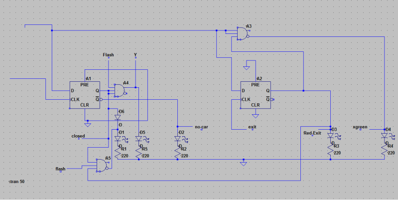

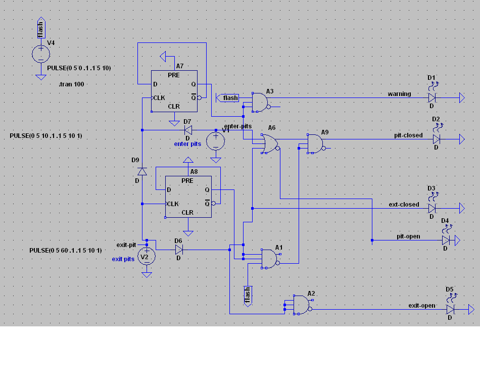

Maybe a silly question but i suppose i have to learn, what are the circles with + and - in at v3, v2 etc. I understand v1 is LDR.
Copied what I could into ltspice and this is what i have upto now, i edited resistor value to 220ohm but dont know what the boxes around red exit, flash etc mean or how to put them in. I presume they are inputs/outputs from somewhere else?
new plan
this circuit works it appears.
If you send me your Email I can Email you the lt spice file. then you don't need to redraw and maybe end up with mistakes.

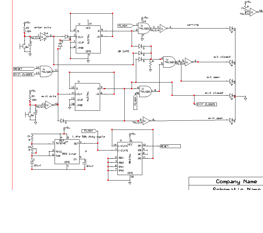

attached is new revised schematic.
this uses NAND and AND gates as well as 3 input NOR gate.
you will need to condition the switch inputs so some Schmitt trigger 7404's should work to invert A3 & A9.

Thanks for the reply, just one question; could pit open led and exit open led be run from a6 instead of having a2 purely for exit open light or have i overlooked something. im only saying this as both green led are lit at same time

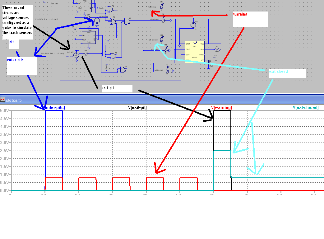

Ok ive been looking at the graphs in ltspice and can see what each stage looks like. Im a little confused as to what the "flash" arrows are for and the power supply for them in top left corner.
Ive been looking at schmitt triggers and there are a few options in ltspice, which do i use? are a8 and a7 the 556 timer you mentioned? apologies for so many questions but i dont know anyone who local who is knowledgeable on this type of subject.
in your want list you have pit open & exit open in stage 1 but pit open = off and pit exit = on n stage 3.
and in stage 2 & 3 pit open is off and pit exit is on.
so the answer to your question is no. Leave A2 in circuit
an inverter in place of the NAND gate but need to count up the number of NAND gates Usually 4 to a chip (74ls00)

Assuming you are building using TTL? If you wanted you could build with CMOS, just be aware of handling precautions.
You also need to build an adequate power supply
add up all the IC current draws plus the 20ma per LED plus what ever the servo draws then double the amount needed. suggest using LS if going TTL (74LS74 etc)

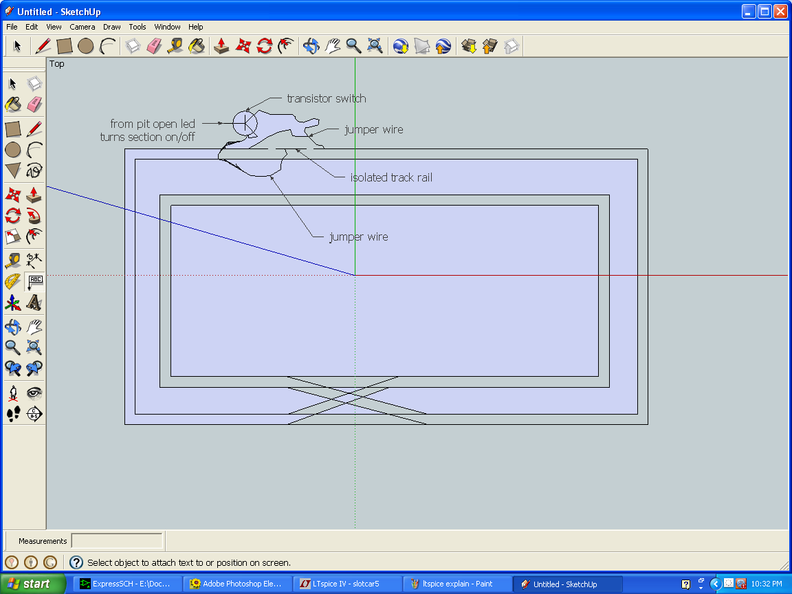

Now about that flipper/servo thing. IMO you would be better isolating a section of track at the pit entrance.
EXAMPLE = a 12inch section of track with one of the tracks 2 metal rails cut, thus isolatng from rest of track. when the pit closed LED comes on that isolated section goes dead thus eliminating any cars from enterng the pit.Section goes live upon the pit open LED coming on.
This section is switched using a simple transistor depending on current demand. Much simpler than usng a servo that may need PWM to control it (whole other ball game)
The FLASH arrows are to show that that connection is connected in the circuit where any other arrow with FLASH inside it. The boxes around pit exit etc. indicate test points.
Tune on LT SPICE and probe a test point wire and the graph will indicate the test point.
Dd you get the revised schematic (PCExpress file?) as well as the LT SPICE FILE?
lt explained
here is a brief explaniation of whats going on.
as a suggestion, load one of the sample circuits in LT SPICE or load the file I emailed you (easire to configure real simple circuits to get your feet wet first)
probe around, play with the circuit etc. LEARN while doing.ltspice explain.PNG

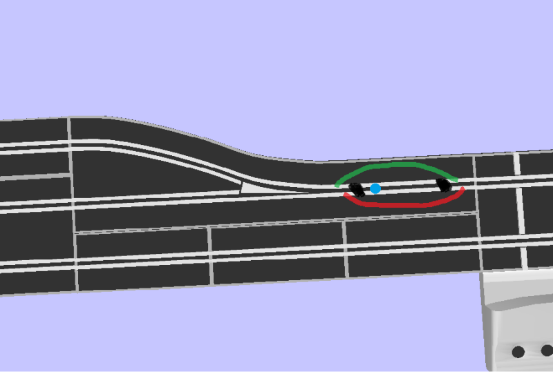

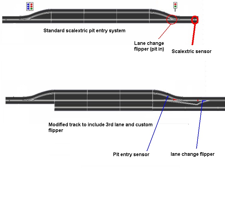

Thanks for the replies, i think id better explain a little about the track system in use as it concerns how the track is powered.
Im going to be using scalextric digital system and a new power module (c7042) is due for release soon and i dont know if changes to the power rails will interfere with the digital system and how it records information.
If i could keep all my ideas together on a separate stand alone system i know no problems would be encountered. It had crossed my mind to take the power supply for my system directly from the track.
If part of one lane loses power when car 2 reaches dead strip area while car 1 pits, car 2 will stop.
So i thought by using a little servo to move a home made flipper i could prevent car 2 from entering pit by redirecting the car so it would avoid the scalextric pit sensor all together.
top pic is out of the box track
bottom pic is how id modify track (roughly, quick sketch);
car enters pit as normal and activates my pit in sensor and moves flipper to divert any following cars around scalextric pit in sensor. this would also act to improve close racing of cars and people would have to avoid car/take caution incase someone decides to pit. the car could even be diverted to the other lane.

scalextric is same as DCC
modle rail road digital control.
simple matter to isolate one rail.
just set up track in circle and leave one section out. setup should still run cars.
I think i get what you mean now, are you on about isolating the scalextric sensor and flipper from the rest of the track so those components would not function while a car is pitting?
So this would create a dead strip and isolate scalextric pit in sensor (blue dot) that would normally activate flipper.

YES it would creat a dead section. If a car tried to pit while another car is present then that car is disabled until the open pit led comes on. Kind of a penatly on not paying attention to the pit lighs. I see there is a SCALEXTRIC pit game addition that lets the "driver" know how many pit stops they have made. At least thats what I understand.

Got files now thanks, email just popped up. Youre right about the pit lane game from scalextric and it will be added to my track albeit with a few minor alterations. The only problem i have with a car being stopped waiting to pit is that it ties up that lane until the car can enter the pit. I like the suggestion but i can see expensive slot cars ending up in lots of bits if a driver is not paying attention. If i isolated a section just big enough to cut power to sensor and flipper the cars momentum would take it across that area allowing it to continue on the lap
I got some info on the scalexy pit in system and the flipper will be left directing cars into pit (from car A going into pit) until car B crosses sensor and changes flipper back to straight ahead posistion so my idea reverts to adding my own lane change before scalextric sensor
