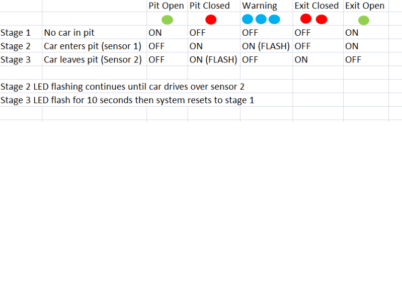

No car in pits = GREEN LED entry ON, GREEN LED exit ON
Car drives over switch/sensor and enters pit lane = GREEN LED entry OFF, RED LED entry ON and flash, BLUE LED ON and flash, GREEN exit OFF
Car drives over switch sensor at end of pit = RED LED entry ON and continues flashing 10 Seconds, BLUE LED OFF, RED EXIT LED ON and flash 10 seconds
Car now totally clear of pit, after 10 second flashing system reset.

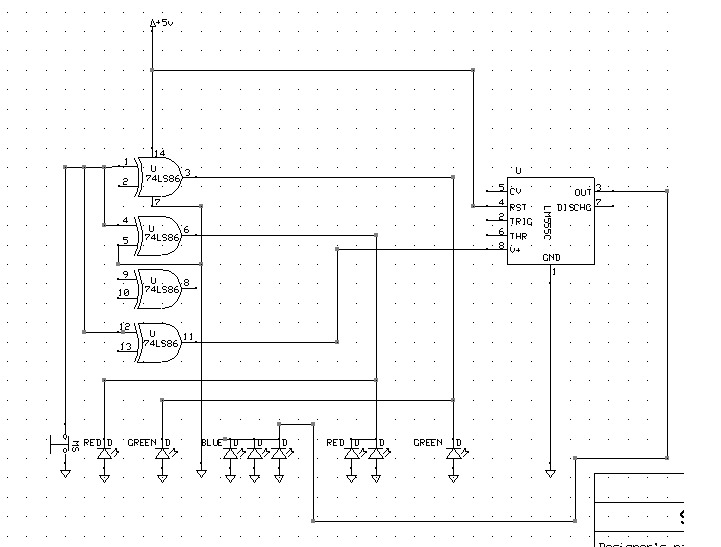

Thats as far as i got, got the basic bits done and need to add leds for red exit light but thats simple enough job. could someone please help finish it off?
If you want help then draw an actual schematic using a schematic drawing program or draw one but make it very clear what you have.
the breadboard pic dosn't tell me anything except you have a 7408 and a clk???
if you use the schematic in the link I posted you will see how it works. breadboard it then run try it out.
the flashing led is a minor issue. WHAT EXACTLY do you want to happen??

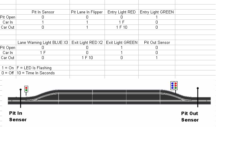

1 car at a time. your correct with the lights for each type. 7486 and clk were just what i stumbled across and seemed quite easy to get to grips with. Ive been told i could program a pic but seems a little advanced for me. I think i need a switch at each end of pit lane so it knows a car has entered then left. when sensor 1 at start of pit is activated light change from green to red/yellow as per table above. once car leaves sensor 2 is activated resetting system and putting green lights back on.
i can do another table showing what is on off in each step of pit entry/exit if required to make it easier to understand
Lets try your new table

Ok heres the new table hope it makes things a bit clearer. (yellow led changed to blue)

alot clearer now.

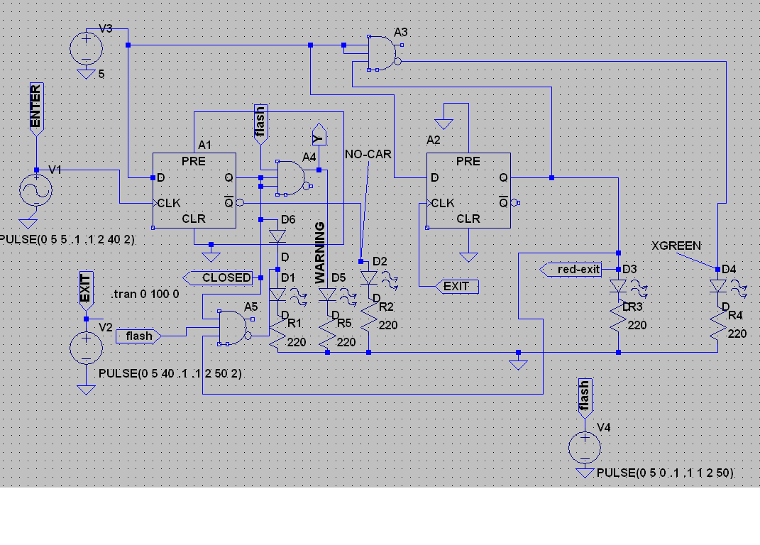

here is a start
this is simulated in LT SPICE
the FLASH is a 556 (2x 555 in one) wired as a monostable and astable timers.
the mono is connected for 10 seconds and the astable is running at 1 pulse per second (1hz)
If you could download LT SPICE and run same simulation you will get a better grasp on whats happening. This way you will learn as you build.
A NAND gate should be added to reset the first Dflip flop.
If battery operated then cmos IC's
time to do some homework but this schematic should get you going.
suggest breadboarding first and observe input requrements =(no floating inputs)

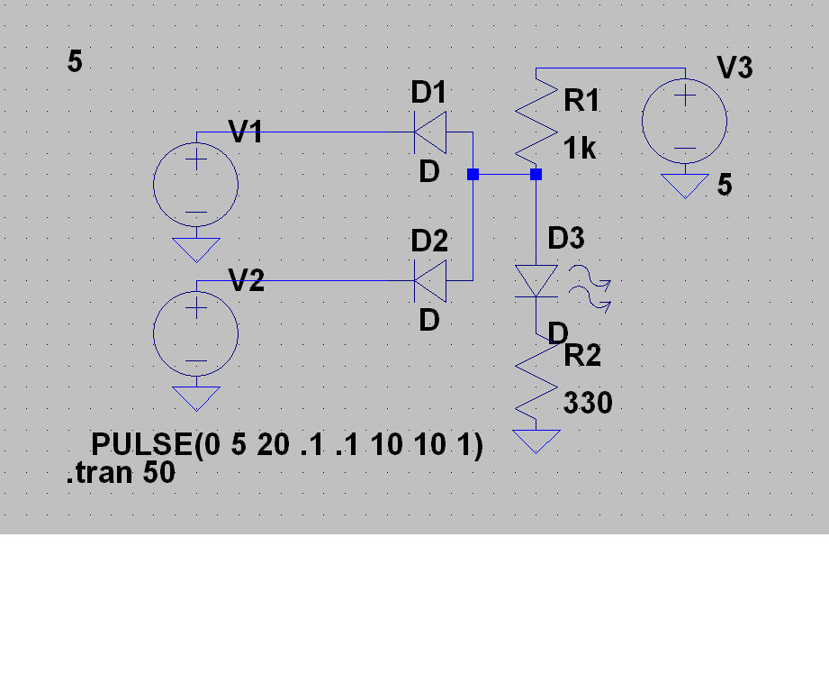

simple alternative to AND gates
yopu could just use diodes for the AND gates instead of IC's

Just out of curiosity, how ok was my schematic for a first attempt, am i along the right lines with it?
thanks again, regards Kris
Your schematic was in the ball park as it wasn't hand drawen. The basic schematic I posted was just that, basic,
It needs work and an actual schematic drawen using an actual schematic drawing program like express pcb. which your schematic looks like it was drawen using?
the drawing I posted is a screen shot of LT SPICE. It needs a monostable timer on the last D flip flop to reset the first D flip flop so the green pit open LED comes on.
