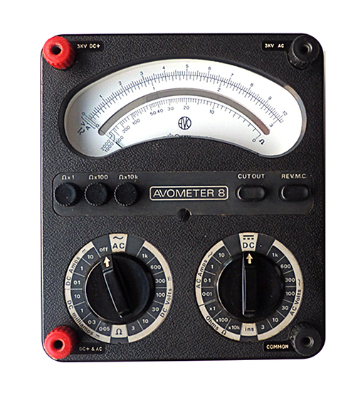

One of the nicests instruments was the traditional moving coil Avo8 multimeter- at one time, if you didn't have one you were not allowed in polite company. Nice as they were though, they were easily damaged, mostly because of the Bakalite case, but partly because of the square corners. They were also bad to handle due to the boxy shape. There were much better and cheaper multimeters at the time but, like Fluke now, Avo were the gold standard. I expect you had an equivalent gold standard in the US, Tailor perhaps?

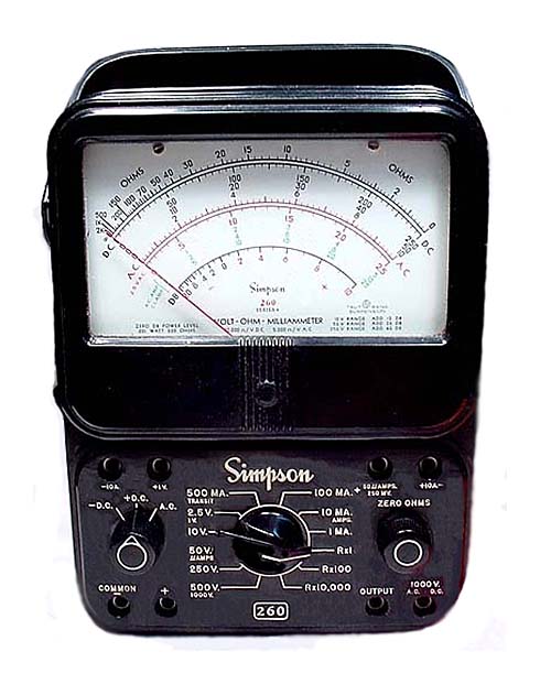

I was a Simpson 260 guy for years. Sadly, lost it (in a fit of stupid betting) back in the late '90s... :arghh:.
Still like an analog (traditional moving coil), though, for very short, low rep rate pulse detection, like a LM567 output when I'm frequency scanning. I know a 'scope will do that, but setup is way easier with the meter.
Bring back memories?
And I have used, many Avo 8s and 9s :)
I'm tempted by this:
But I would only be buying it for old time's sake
