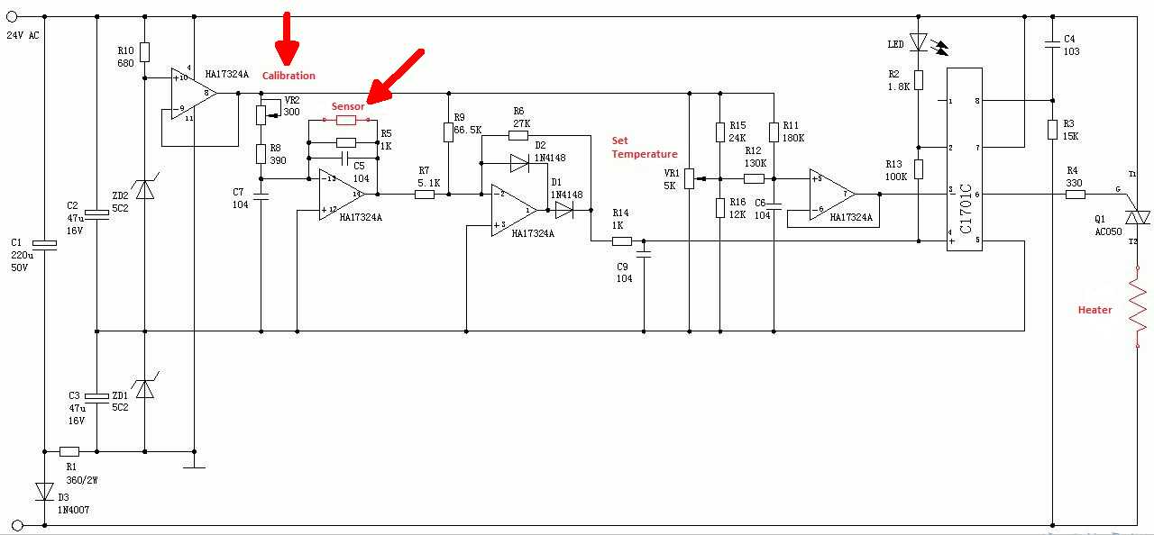

  • Soldering iron/station - I got a used Hakko iron (might be a clone) cheap, and built myself a clone of their 936 analogue station from a schematic of the original found on the web. Had to modify it slightly because the triac controller is obsolete. I can post the schematic if you like.
Sure- like to have a look. I have messed about with Weller temperature controllers- mainly cracked PCB. I think the circuits are all similar

Soldering iron controller. I used 2x LM358 because I didn't have an LM324, which is what they used in the original. Excuse my layout program's crummy symbols I hadn't got round to making ones showing separate amps at this point. It's possible the comparator is shown wired the wrong way, I know I messed about with it a lot after I built it. Compare with the original schematic I found on the web (2 versions - I think the big red arrows are to do with a forum thread I found it on). It's the uPC1701C that's obsolete, but it's little more than what I actually used.
  • 936-clone-schematic.pdf

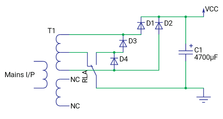

Here is another idea that I seen to give you two unregulated voltage options, this can then feed into a linear regulator like an LM317. In the position shown the output voltage is X1/2 with it in the other position it is X1. ( e.g. for a 12-0-12 volt transformer. First switch position; Vcc = 16~17 V, in Position 2; Vcc= 32~34 V ( unloaded voltages ))
The contacts can be operated manually by a switch or automatically with a relay controlled by a comparator that switches according to the required output voltage.
