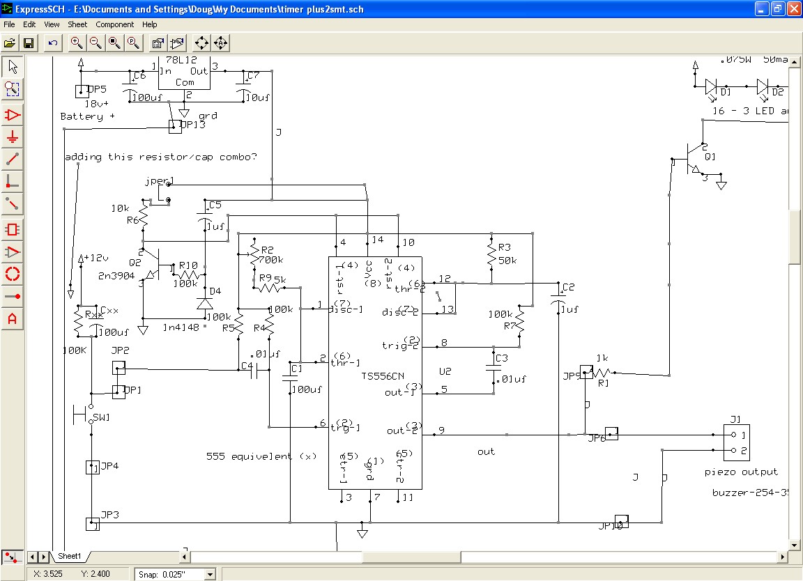

the circuit I am using is the same as the 2 stage time delay circuit I have attached.
the circuit says the time out even if the trigger is held low.
but will it start to retrigger again?? if held low.
In the circuit I am using the 7556 all the (#) refer to the 555 pins.
I added a resistor cap combo but thinking I should drop the cap and just go with 100K or ? resistor??

add resistor cap for trigger
inserted a resistor/cap to trigger but maybe just the resistor. The switch is showen as a monintary NO switch but the unit will basically be triggered as a NO switch (not monentary)
need to avoid retriggering when switch is closed for extended time. Just want one flash.
the 7556 is set up as per **broken link removed**
the 2 stage time delay circuit. It says circuit will time out if the trigger is held closed.
the (#) denote the pins on the 555

Like I said, a 555 will never time-out if its trigger pin is held low. It says so in the datasheet and that is why the input capacitor that I recommended is used in the 555 article you found. The article does not have page numbers so I attached the schematic here. His capacitor is 10 times more than yours but I think yours is better because it responds quicker.

Your circuit already had the trigger pulse parts.
I wish you made the addition of the resistor/cap combo in RED so i could see it.
Get rid of these parts.

my circuit already has the rsistors and caps so I guess it will run as pictured.
