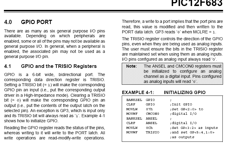

TRISIO is register 0x85, and GPIO is register 0x05.
In assembly language, the only complication is bank switching. I guess that is taken care of in Basic, so you should be able to write directly to the TRISIO and the GPIO registers.

Microbasic works just like the microC it uses
GPIO.B1 =1
  AND
 TRISIO.B1 =1
to set just a pin or like bird said to set a port
