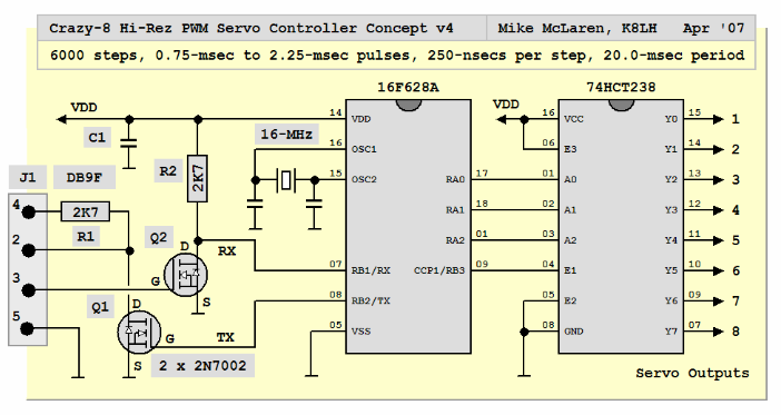

Here's another relatively simple 8-channel or 16-channel 'hardware' Servo controller method which utilizes the CCP PWM module and one or two 74HC238 decoder ICs (inspired by contributions over at Forum.Microchip). It's relatively low overhead, interrupt tolerant, and should provide 250-nsec pulse width resolution with zero Servo period jitter and zero pulse width jitter.
crazy-8-v4-png.12816

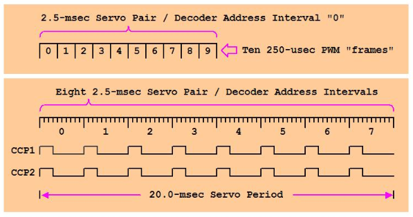

Using a 16-MHz oscillator the PWM module is setup with a 250-usec period (prescaler 4:1) and there will be 80 of these PWM periods or "frames" within each 20-msec Servo period.
I decided to use ten "frames" which form 2500-usec Servo Pair "intervals" equally spaced across the 20-msec Servo period. I also limit each Servo pulse width value to 2250-usecs max' to insure that the 10th PWM "frame" in each Servo pair "interval" will always have a 0% duty cycle where it'll be safe to update the address lines on the 74HC238 decoder IC.
crazy-8-v4-intervals-png.12817
