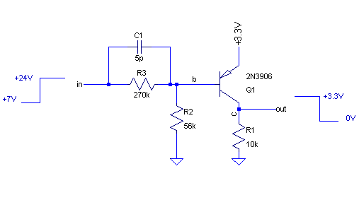

Hey,
Im currently trying to come up with a simple circuit that will interface a pulse output of a wattmeter to a chip. The levels of the output of the wattmeter are 24 volts for the high part of the pulse, 7 volts for the low. I wish to convert this to 3.3 volts for either the high or low, and 0 volts for the other. Does anybody know of a simple circuit that could do this?

Hi, I would use Comparator with ~10V reference and voltage divider on output (to reduce 24V output to 3.3), this should be very easy to do. Or you can put divider to input, so that you don't have to have a high voltage reference and Comparator won't have to be powered from 24V...
When I re-read your post, I think that regular NPN would do the job.
If your Cmos logic uses a 3.3V supply, anything higher than 2.2V is considered to be a valid high. Anything lower than 1.1V is considered to be a valid low. Therefore use a two resistors voltage divider to divide the input voltage.
By dividing by eight, 24V becomes 3.0V and 7V becomes 0.88V.
By dividing by nine, 24V becomes 2.7V and 7V becomes 0.78V.
A divide by nine voltage divider is a 12k resistor feeding a 1.5k resistor to ground. :lol:
You want 3.3V and 0V when the input is 24V & 7V.
Both Audio and Jay offers a workable solution. I hope mine works too.
A 21V zener in series with a 1K resistor to common will do. When input is 7V, zener diode is OFF and so no voltage across 1K resistor. When input is 24V, zener diode drops 21V and leaving 3V on resistor.

Here's another way. By changing resistor values, you can make this work for almost any common value of VCC. Using simultaneous equations, you can solve for the resistor values in terms of VCC and required base current (which depends on the value of the collector load resistor). I chose base current=30uA in this example.
The 5pF cap can be omitted if you don't need fast switching.

Hi L. Chung,
Ron's PNP level shifter takes care of converting +24V to 0V and +7V to about +3.2V very well.
I also have and like the Cmos Cookbook. As it says, you can use the input's protection diodes to limit voltage only if you also limit the current though the diodes with a series resistor from the high voltage source.
BTW, in addition to an input voltage spike of +17V when the signal goes from +7V to +24V, there will also be a voltage spike of -14V when the signal goes from +24V to +7V, due to the capacitance across your suggested 21V zener diode. :lol:
