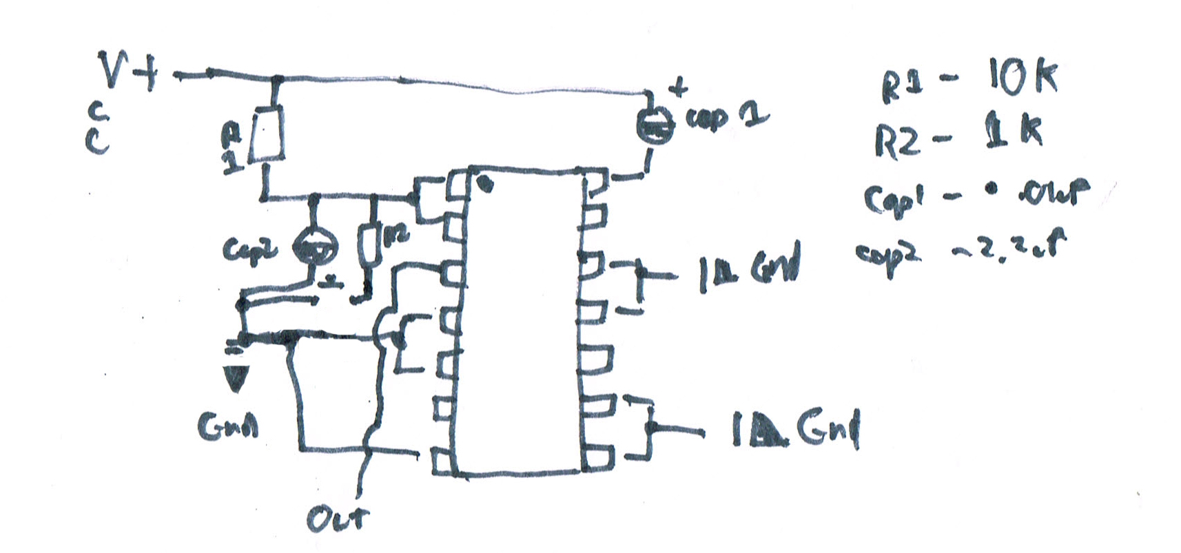

Forgive my bad sketch and having the cap symbols backwards....
but, like that?

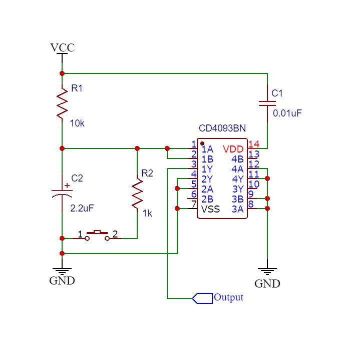

This is your schematic, according to the sketch in post #46. There are a number of things wrong....
The nice thing about using a schematic capture tool like EasyEDA – the pins are labeled, so it's easy to see what's what without constantly looking back at the data sheet.
The most obvious errors:
C1 should be connected between pin 14 and ground.
Vcc should be connected directly to pin 14.
For sections 2 and 4, instead of connecting both inputs to ground, you have connected an input and output to ground, and left the other input floating. When the chip is marked with the pin functions, this is easy to see.

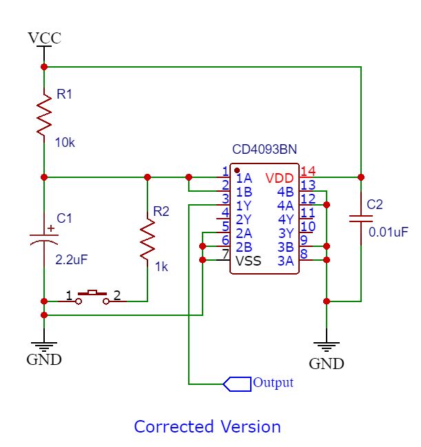

Here is the corrected version, as suggested by Chris in post #45. A few minor changes. But notice how much easier it is to see the circuit as a schematic than as a bunch of words.

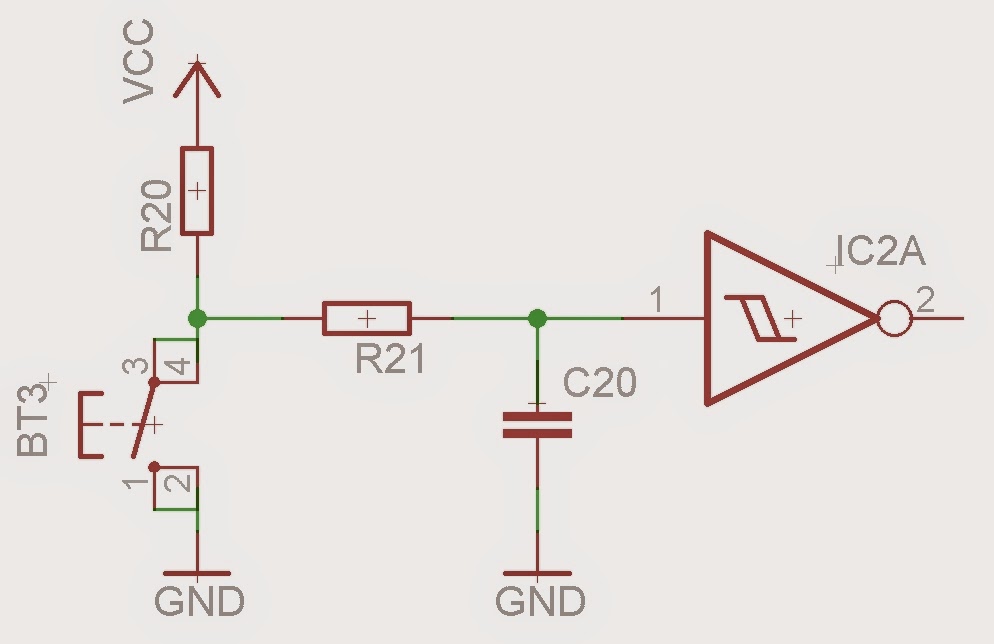

The switch has a resistor to power. The input a cap to ground. another resistor links the two. It's a very common configuration, as one I found on google, below.
It is the configuration I was describing above, a versatile and generic way of debouncing or adding a short delay.
The signal from the switch + pullup resistor can be from other types of source or logic.

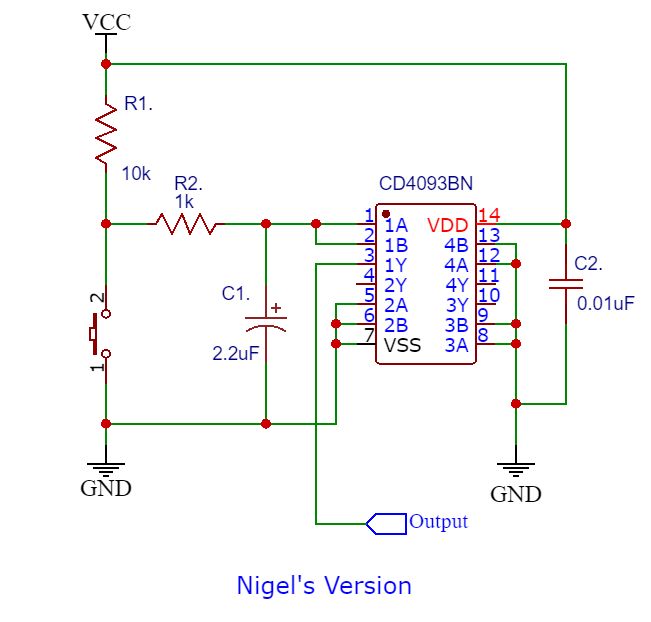

Here's a schematic for Nigel's version. It moves parts around a little, but it's the same number of parts. The R and C values might need some adjustment.

Crossed paths. I guess I didn't follow Chris's description quite right, as it's the same circuit Nigel referenced. A schematic does make things much more clear.

I like this version a little better. Since the two resistors no longer form a voltage divider, their relative value is no longer important, and could be the same value. That makes the BOM for the system simpler.
