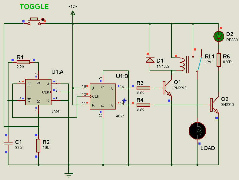

here's a circuit for a good toggle switch. /Q is high when the circuit is energized indicating "READY". When the pushbutton is pressed /Q goes low and Q goes high activating the relay.
Pressing the pushbutton again the circuit returns to ready state.
Look at the attached screenshots. The relay is an animated one and switches the "LOAD" (light bulb)

You can't toggle using an NE555. Toggle function can be achieved by connecting a JK-FlipFlop at it's output.
A CD4027 is 15 Cents.
Using a 4027 you might save the timer IC for other applications.
But you can toggle using two 555s or a 556 ;) **broken link removed**

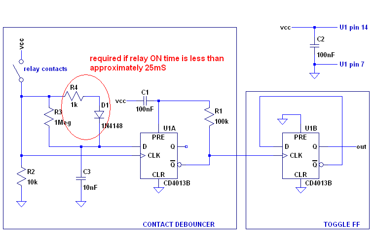

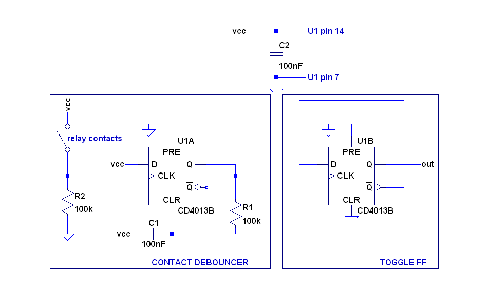

You should be able to do it like this.
EDIT: This may not work, due to bounce when the contacts open.
See post #17 for a possible fix.

IT WORKS!!!!
i tried the 4013 circuit and used relays instead of just touching wires and it worked! also i had no idea that touching wires had a lot of debouncing, thanks for the tip and thank you everyone for your help, but i do have one more question, in that diagram, is pin 2 floating? i heard that if a 4013 has a floating pin it gets damaged
Floating inputs will cause the device to malfunction. Floating outputs are fine.
If you put the R1 and C1 time constant on the toggle FF between Q/ and D, you don't need a separate debounce FF.
oops. You're correct. It would toggle any time the switch bounces, which would include release.
[edit] Actually both designs would work this way. Probably not a problem with a N.O. contact where it's shown. [/edit]
Oops. I think it is a problem. It showed up in the simulation, but I missed it. Below is a somewhat clunky way to fix it, at least in simulation.
If you use a 4013 with a Schmitt trigger clock input, you don't need the first FF. A simple RC network will debounce the switch. Unfortunately, the only one I know of is HEF4013 from NXP (Philips). There may be others.

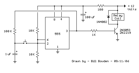

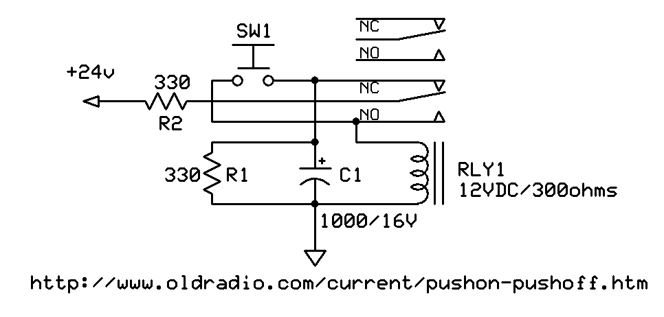

Here's a clever circuit to toggle a relay:
Short tone = ON Long tone = OFF
Another clever relay toggle circuit.
Ken

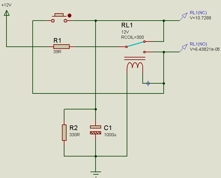

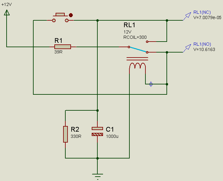

Since I suppose the OP doesn't want to use a 24V power supply I simulated the circuit applying 12V.
At a coil resistance of 300Ω the minimum value for R1 should not be less than 39Ω. If it is smaller the relay will toggle on when the button is depressed, and toggle off for a short moment and on if the button is depressed again.
With R2=330Ω the minimum time between button operations should be approximately 500ms (for the electrolytic cap to discharge below 9V)
The value of R2 should not be lower than 240Ω. (Otherwise the relay won't switch on.)
Boncuk
