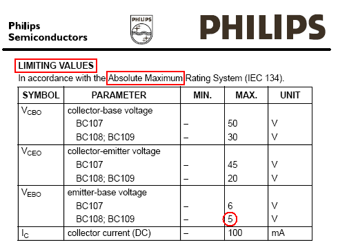

Cry_Wolf said:
Can you explain a little bit
Transistor manufacturers publish datasheets that list the absolute maximum voltages and currents allowed for each transistor. The reverse-biased emitter-base junction of a BC108 transistor has a max voltage rating of 5.0V.
In the multivibrator circuit, with a 9.0V battery and 1.8V LEDs, the cathodes of the LEDs are at +7.2V. Each capacitor charges at a separate time with its positive end at +7.2V and the negative end at +0.6V, so the capacitor's charge is 6.6V. When a transistor conducts, its collector goes to about +0.2V which causes the capacitor connected to it to try to instantly have its positive wire at +0.2V and its negative wire at -6.4V, causing the emitter-base junction of the turned off transistor to have avalanche breakdown (like a zener diode) because the voltage exceeds the max allowed of 5.0V. The avalanche breakdown is bad for transistors and ruins them after some time.
We have been talking about adding diodes to the transistors to block the excessive negative voltage.
