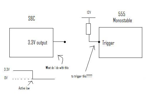

Ok here it goes,
I want to trigger the 555 from an active low 3.3V output.
What can i put in the middle of these two circuits to trigger the 555 monostable? Do i need to level shift the 3.3V?
Your 555 does not have a power supply voltage so it won't work.
The 3.3V input pulse has an amplitude that is too small for a regular 555 (because its minimum supply is 4.5V) but will be fine if it is a Cmos 555 with a 3.3V supply voltage.

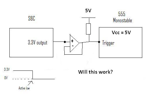

Hi Audio,
thanks for the reply,
IF i lower the supply voltage of the 555 to 5V does that means the trigger will occur when the input goes below 1.67V (1/3 VCC)?
Also would you recommend a buffer on the input of the 555 trigger?

You will have to put a voltage divider on the base of the first transistor to make sure the LOW from the micro turns the transistor off.
The output of an ordinary 555 with a supply that is only 5V is a high of +3.6V and a low of +0.01V.
The first transistor does not need a resistor to ground because the output low from the micro-controller is 0.0V.
is the input capacitor and pull up necessary? The npn would do the same by itself?
The two 100k resistors and the 0.1uF capacitor allow a DC input to ground but the pin 2 trigger input gets pulsed properly.
Because if pin 2 is held low too long then the output stays high and the timer will not time out.
The collector of each NPN only goes low, the resistors pull it high.
