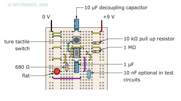

Ok, So I read a couple threads here about setting up a delay with the use of the 555 timer and I have constructed a circuit identical to the one "attached"
Basically, I am looking to hook up a small dc motor and have 45-60 seconds go by before the motor starts.
I am using a 47 mF capacitor and a 1M ohm resistor, So I believe this should provide just over 50 seconds of delay.
So I switch out the 1 mF capacitor (in the diagram) with my 47mF, and I use the same 1M ohm resistor. my question(s)..
1.) Do I need to change the values of the 10 k "pull up resistor" ?
2.) how about the 10 mF decoupling capacitor?
3.) I assume I swap out the LED with the dc motor,..correct?
4.) the 680 ohm resistor in front of the led,...do I need to change that value?
5.) lastly, what is with the 10 nF element, that says optional?
thanks a million, I really appreciate the help!

The timer does the opposite to what you want. It starts lighting the LED (or driving the motor) immediately when the button is pressed and it stays on for about 45-60 seconds.
The 10k pullup rersistor must connect between pin 2 and the positive supply. The pushbutton is supposed to connect pin 2 to 0V when it is pressed.
The 10uF decoupling capacitor is needed.
Swap the LED and resistor for the motor. Use the resistor only with an LED.
The 10nF capacitor is needed if the supply voltage varies all over the place.

You can't just reverse the motor (or LED) connection to +9V instead of to 0V. Then the motor will start when the power is turned on, turn off for 45-60 seconds when the pushbutton is pressed then start running again.
I think you need two timers. The first one triggers the second one.

A couple of questions: What is the voltage rating of the motor and how much current does it draw on that voltage.
I can think of two solutions: If you replace the push button switch with a 0.1uF capacitor the 555 will start the timing when the power is applied. If you connect a relay coil to the output of the 555 with the NC contacts to control the motor the contacts will open as soon as the 555 starts timing and the contacts will close at the end of the timing cycle and turn on the motor.
Or you could connect a PNP transistor with the emitter to the + rail, the collector to one side of the motor. The other side of the motor to ground and a resistor from the base ot the PNP transistor to pin 3 of the 555. Put a 1N4001 diode in parallel with the relay coil and the motor. In both cases use a seperate switch to turn the power on to the timer and the motor circuit at the same time.
The relay or the PNP will turn the motor on at the end of the 45 second delay.

This is the schematic I recommend. When the power is first turned on the output of the 555 goes high and remain so for the timing period, then the output goes low and turns on the PNP transistor, which in turn energizes the motor.
The motor voltage and the motor current values are necessary to modifiy the circuit to work with the specific motor.
