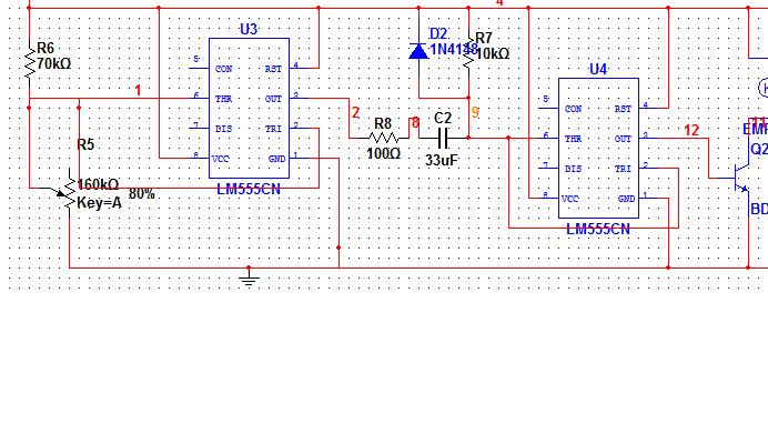

hi, im currently doing an electronics project, which i have designed with a bit of help. i am stuck trying to figure out one part of my circuit (see attached image), i have it working, but i dont know if the arrangement i have will function correctly when the circuit is made for real (it works in multisim). i have the first 555 timer (U3) set up to give high output until variable resistor r5 reaches 90%, then output low. this triggers the next 555 timer (U4). this gives me a timed output. as i said before it works on multisim but i cannot see how capacitor C2 can discharge. any advise would be much appreciated.

C2 will charge and discharge via R7 and the diode.
thats what i thought but the top of the diode is connected to positive, is the capacitor able to discharge this way or would i have to place the diode connected to negative? sorry i know im confusing myself with this

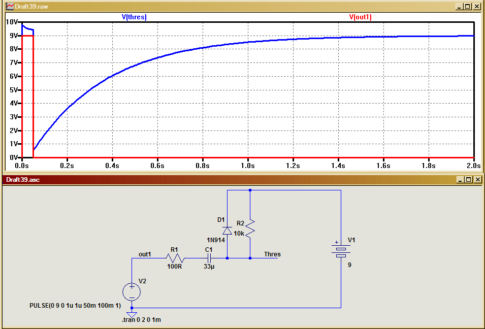

Its quicker to post a sim image than to explain it, look at this section from your circuit.

thanks for that, ive checked and im getting the same, but as part of the project im sure i'll be asked where and why it discharges?? also does the first part of the circuit look ok (u3), does triggering the 555 with resistors i.e no capacitors work in the real world. ive had no real experience with 555's before so dont know if this arrangement works

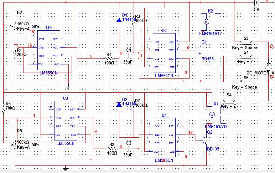

Question I have is what are you connecting the output transistor to?
You need a base resistor or the second 555 will emit magic smoke
Multisim is a good simulation software, but it should not be taken as the final word. First hand experience is the only experience that I use. I only use multisim to test whether or not 2 different circuits could be combined to make a bigger circuit and still function properly.
What I am wondering is what you are trying to do with these 555 timers. Could you post the full schematic of your circuit? We may be able to help you more if you give us more info.
magic smoke lol, yes a base resistor will be put in i just havent calculated what size yet, the output transistor is going to be used to control a relay which controls a motor for a certain time. i know ive over complicated the circuit a bit.
heres the full circuit so far. ignore the relay setup i cant find the correct ones to use on multisim. the circuit is designed as an automatic curtain closer, way over-complicated for what it is, and im using the 555's to time the motor, rather than using something like limit switches. any more advice?

Start over, that's my advice. I would suggest that you try using a comparator instead of a 555. A 555 timer is extremely hard to get timed perfectly, you would be best off making it a light activated circuit.
