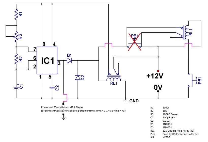

Hi, I would like to modifie this "555 Low power Consumption Timer Circuit":

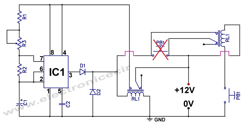

The problem is that I have push button already installed in a car and one side of it is connected to the ground.
Is it possible to adjust schematics to that button?
would this work and consume 0 power when off? Also wont Diods burn?
Any other ideas for such button placement and power consumption that would be 0 on idle?
Neither circuit uses any power, if PB1 is up (off). There cannot be any power flow since the relay contact (armature) is an open connection. Only when you press the button, does any power go to the 555 via the energized relay.
Where you put the PB1 does not make any real difference. In one, you are supplying the +12V to D1/D2 and the relay coil. In the second, D1/D2 get 12V all the time (but block it), and PB1 just completes the relay circuit by providing a ground.
Either way. PB1 is used to energize the relay, without which the 555 does not get power if not energized.
If the 555 holds the relay energized, your second diagram will not work, as pin 3/D1 cannot find a ground for the relay via PB1 if it is off.
It would not consume power when off - but the 555 does nothing, the relay coil is directly controlled by the button - it operates when pressed and releases when the button is released.
Rather than connecting the 555 output directly to the relay coil (which is now also +12V), you would need to add a transistor or FET controlled by the 555 output and connected across the button, so the 555 circuit maintains the power through the relay until it times out.
Or use the original and have you fitted button operate a relay and use the contacts of that where the button should have been.

In the top diagram, the 555 is configured as an astable. When the button, PB1, is pressed, the 555 will begin to oscillate at the frequency set by the RC combination. It will continue to oscillate as long as the button is held pressed. However, the 555 pulsed output to relay, RL1, is overridden by 12v from the button, so the relay will also stay energized as long as the button is held pressed. If the button is released before the end of the timing cycle, the relay will stay energized until the timing cycle completes

And how could I edit shema that the button would be connected to ground?
Can pin 3 give negative ground instead of power? Or its not possible to modify shematicsthey way I want and that it wont consume power on idle?

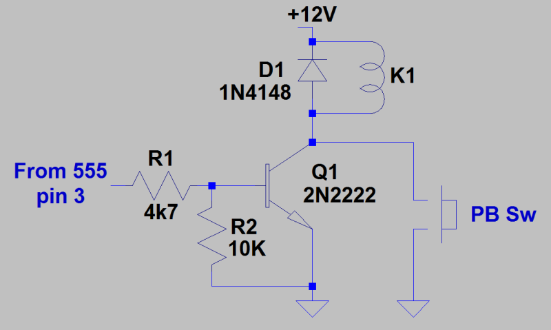

Pin 3 can drive a transistor that can be in the negative side of the relay. The circuit below shows how to do it.
- You don't need the two diodes on the output of pin 3, but you do need the one I've shown across the relay.
- You haven't said what relay you're using. Some circuit changes may be necessary depending on what that is.

The diode across the relay coil can slow down the opening of the contacts. If a large load is being switched by the relay, opening the contacts slowly can cause contact burn.
The relay can be turned off faster if a zenner diode or resistor is put in series with the diode. A transistor of a higher voltage rating will be needed.
True, but this is the industry accepted practice for probably 95% of applications, and will be the same as that of the original circuit that has a diode across the relay coil.
But this will consume power on idle correct? Will my circuit with 2 realay work and wont consume power on idle?
Both will work, and neither will consume power when idle. My transistor circuit would be a little smaller.
