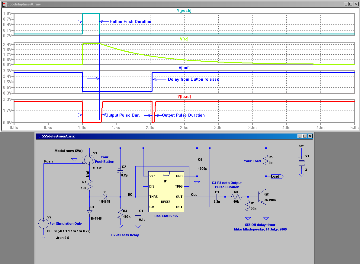

Stare at this:

But - I may be wrong about this - I think the red V(load) graph is actually completely the opposite of what I would like. My interpretation of the graph is the load is on and goes OFF when the switch is activated.
I want the load to be off initially, on for a microsecond as I push and release the momentary switch, off for 1.5 seconds, then on for a microsecond as the timer circuit turns on the load then it should reset until I push it again.

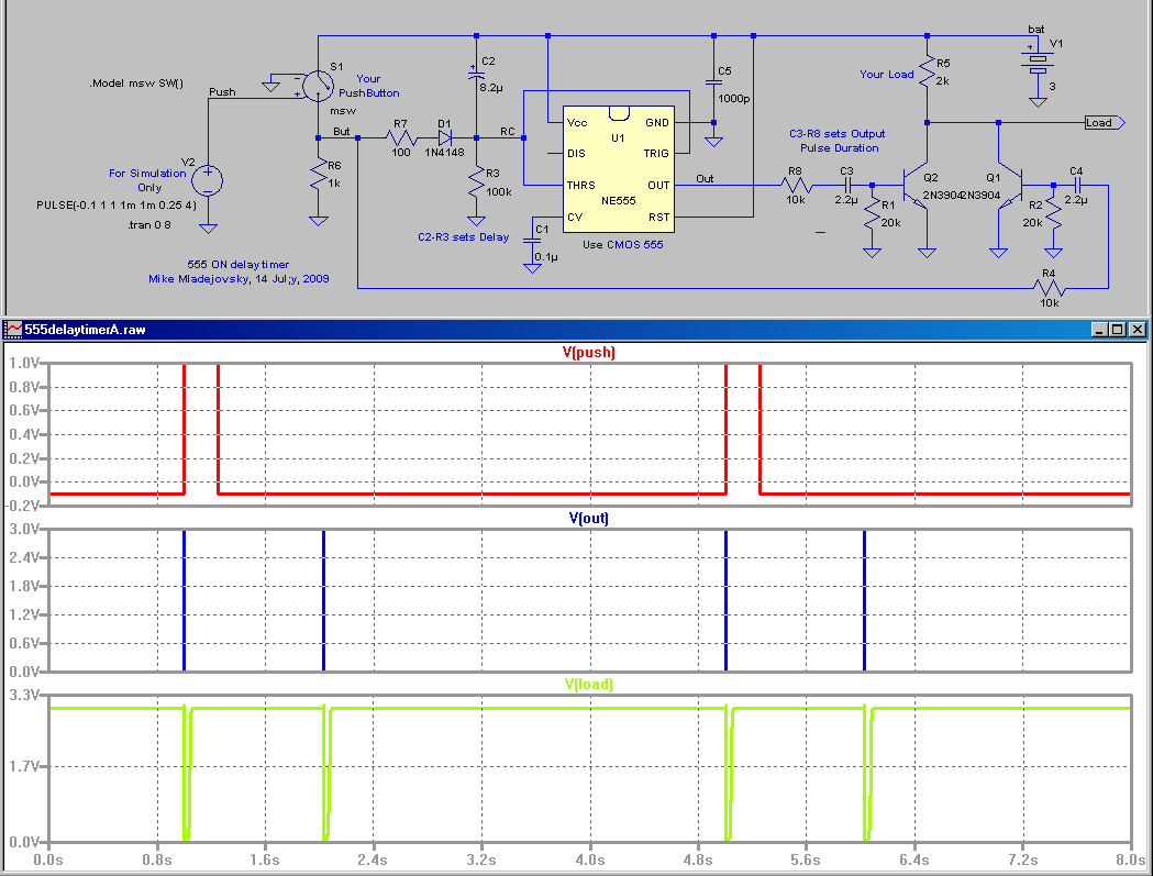

Here is a modified circuit. Note how "Your Load" is connected. I asked you about an active high vs active low output. By connecting the positive end of you load directly to the positive pole of the battery, and driving the other end low, your load is only on for the short duration shown.
