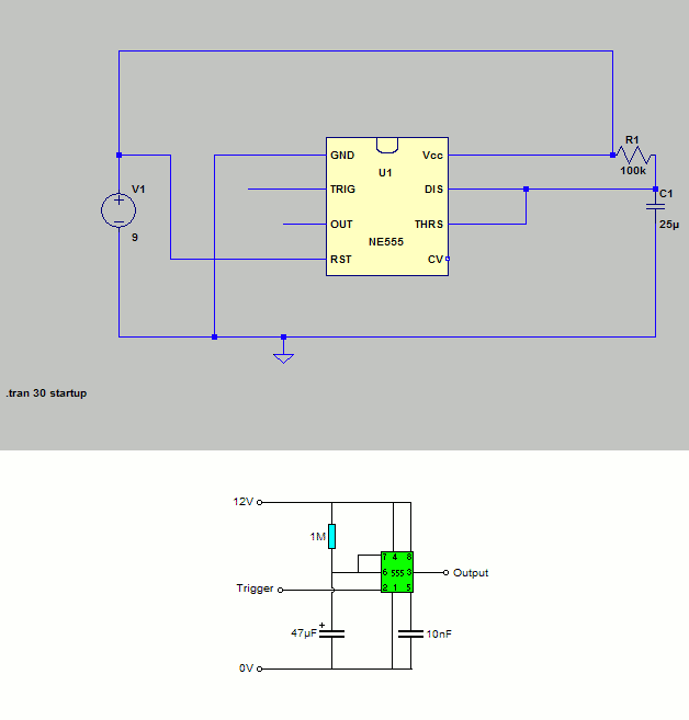

i looked up some articles and i think i understand the 555's monostable circuit.. but when i tried simulating it on ltspice i fail to get the expected results..
i have a few questions..
so if the 555 triggers when the trigger voltage reaches 33% of vcc would it trigger if i connect the trigger to ground? else how am i supposed to trigger it?
in the simulation the output = vcc from the beggining and it doesnt go to zero when threshold reaches 66% vcc and the capacitor doesnt start discharging..
please help..
ive attached the ltspice file
thanks :)

The circuit is all wrong, there's nothing to trigger it.
Compare your circuit, with the real 555 timer circuit and you'll see what I mean.

isnt my circuit similar to what you've drawn? :confused: except for the control voltage connection which upto my knowledge is not neccesary.. and yes i havent connected the trigger so how do you trigger it in ltspice for simulation? please be kind enough to explain.. :) thankyou

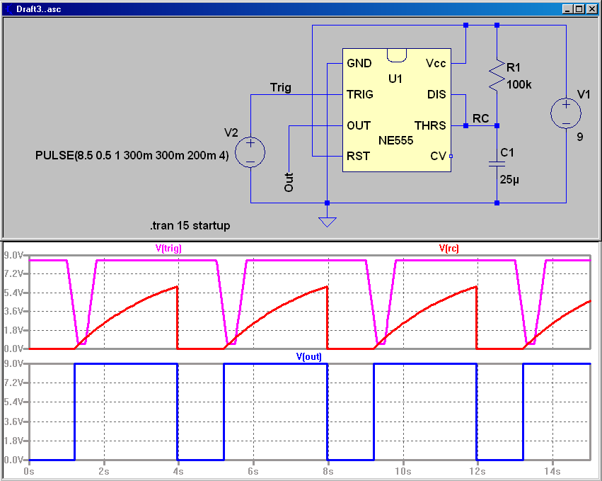

Here is your circuit with some drafting enhancements, and with an added pulse generator which triggers the 555. Note that it takes a down-going signal on TRIG to cause the 555 to begin a timing cycle.

As an added note for your other thread, since the TRIG is a down-going signal, then the end of the output pulse from one 555 can be use to trigger the start of another 555 pulse.
And, that trigger pulse has to be shorter in time than the 555 output pulse width.
Ah Roff, then my comment is not entirely correct. So you would have to connect the pulse from one 555 through a capacitor and pull-up resistor to properly trigger the next 555.
If the TRIG input is longer than the 555 period, then the 555 becomes an "inverter", controlled by the Trig input crossing the 1/3Vcc comparator.

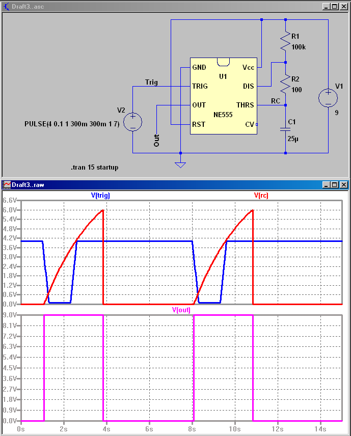

Here you go: The threshold for the TRIG pin is 1/3Vcc (3V). The threshold for the THRS pin is 2/3Vcc (6V).
btw: another thing I noticed. Discharging a 25uF capacitor without limiting the current is bad practice. I added R2 to reduce the peak current. Doesn't change the timing.
That's a good precautionary measure for most capacitor discharge circuits, but it's not required for **broken link removed**.
Note 7: No protection against excessive pin 7 current is necessary providing the package dissipation rating will not be exceeded.
This is probably true of all mfr's parts, but I couldn't find any mention of it in Fairchild's datasheet. I would think it would be in the datasheet if it could be a problem, but who knows?

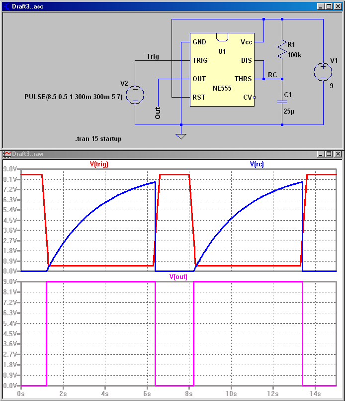

i see.. thanks.. now im trying to make the end of the first pulse of the 555 trigger another 555.. this works but the problem is when i connect the output of the first 555 directly to the trigger of the second 555 the second triggers before the first because the output of the first is zero in the beginning..
ill upload the asc.. the second 555s output has two pulses.. nyway to limit that only to the last?
This is a likely artifact of how you are instructing LTSpice how to model the initial power-up. Possibly get rid of the STARTUP, and use the .IC statement to reflect the reality of the state of the timing capacitors after power-up.
