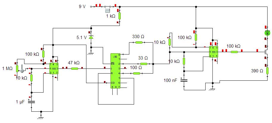

i want to make a small led brightness controller, the leds are already in strips on a seperate board, runs of 12v at the moment.
a friend recommended that i look into pwm brightness control. i have done a bit of reading, and looked into control with a pic as well. i will have to control 2 sets of leds seperately, so the blue can be brighter at night and the white brighter during the day.
i had setup something like this..
555 timer -> 4017 -> (pin1: 400ohm) -> 555 timer pin 6
-> (pin2: 300ohm) ->
-> (pin3: 200ohm) ->
i had hoped that the different resistors on the 4017 outputs would change the timing amount on the 2nd 555.. in crocodile clips i could not get it to work.
any ideas guys?

Your text-based schematic doesn't do it for me - and I suspect that's why you haven't gotten any responses. If you have a Crocodile Clips schematic, you should be able to post it.
i have been playing around with c.c again, but can't figure out how to get a resistor coming from a pin on the 4017 to vary the timing on the 555 timer.
basically i want to use pwm brightness control on the LED, by having the 2nd 555 timer oscilate fast enough so the led is brighter/dimmer but not flashing. I was trying to do this by somehow affecting the timer circuit through the 4017 outputs.
I plan to have 8 steps on the 4017, each step 3 hours.. so the LED will vary brightness every 3 hours, and continue this cycle every day.
I hope its not too bad a schematic.. but you will hopefully understand where im going wrong, or if im just doing something thats completely impossible.

An ordinary CD4017 Cmos stepper with a 5V supply has outputs that are about 1.2k ohm from either the positve supply (turned on) or from ground (turned off).
A 74HC4017 has outputs that might have a resistance that is about 100 ohms from either the positive supply or from ground.
The outputs of your CD4017 can supply base current to a transistor through a resistor and the transistor will have a very low resistance to ground when it is turned on.

k7elp60 said:
I have had excellent results using CMOS analogue switches to change both
timing resistors and capacitors for 555 timers.
Of course. An analog switch has a low resistance when turned on. A Cmos logic output isn't.
tim123 said:
does the idea sound right though?
I would use the high output resistance of a CD4017 to change the high resistance reference voltage of a triangle-wave-comparator PWM circuit, not the timing parts of a 555.
You won't be able to get a 3 hour period from an RC oscillator (555 or other), because of capacitor leakage. You will need a frequency divider or a microcontroller.
