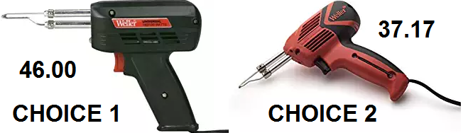

Does anyone know of a problem with these?
Those gun-type soldering irons are good and powerful, and they heat up very quickly and cool to a safe temperature quickly. Mine is the tool of choice when soldering wires other than small ones onto pcbs.
Downsides are:-
You have to be careful not to leave them on, and with prolonged use the whole thing will get hot. They weigh enough that it is easy to put them down and push something against the trigger so they stay on. I recommend an additional switch and a warning light if that additional switch is on.
The tips burn out fairly quickly. They are cheap and easy to change, but worth keeping some handy.
The iron is heavy.
The tip is quite big, and so useless for all but the largest surface mount pads. Even when I was struggling to solder on an aluminium board, the instant heat iron was just too big to use and I rigged up a hotplate.
There is a big magnetic field from the current, so small magnetic items will be lifted when soldering if not held down.
Bonus upside:
Any bit of wire can be used as a bit, and that can be used for cutting polystyrene (styrofoam) or other plastics.
Got my Weller in the 70's, still works like a charm.
BTW, having no thermal reliefs is bad design practice even for boards that are wave or reflow soldered. Guaranteeing proper solder flow through to the center of the board requires significant changes to a "normal" thermal profile. Plus, somewhere down the road some poor schmuck has to rework your work. How well do you think the hole plating will stand up to a 250 W iron?
