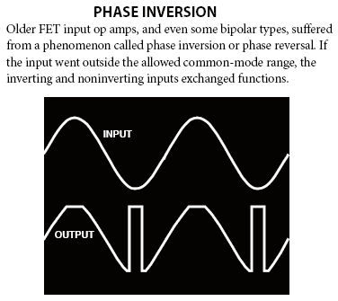

The older FET-input opamp might have the problem of Phase-Inversion where the output suddenly inverts when the input level is high.
