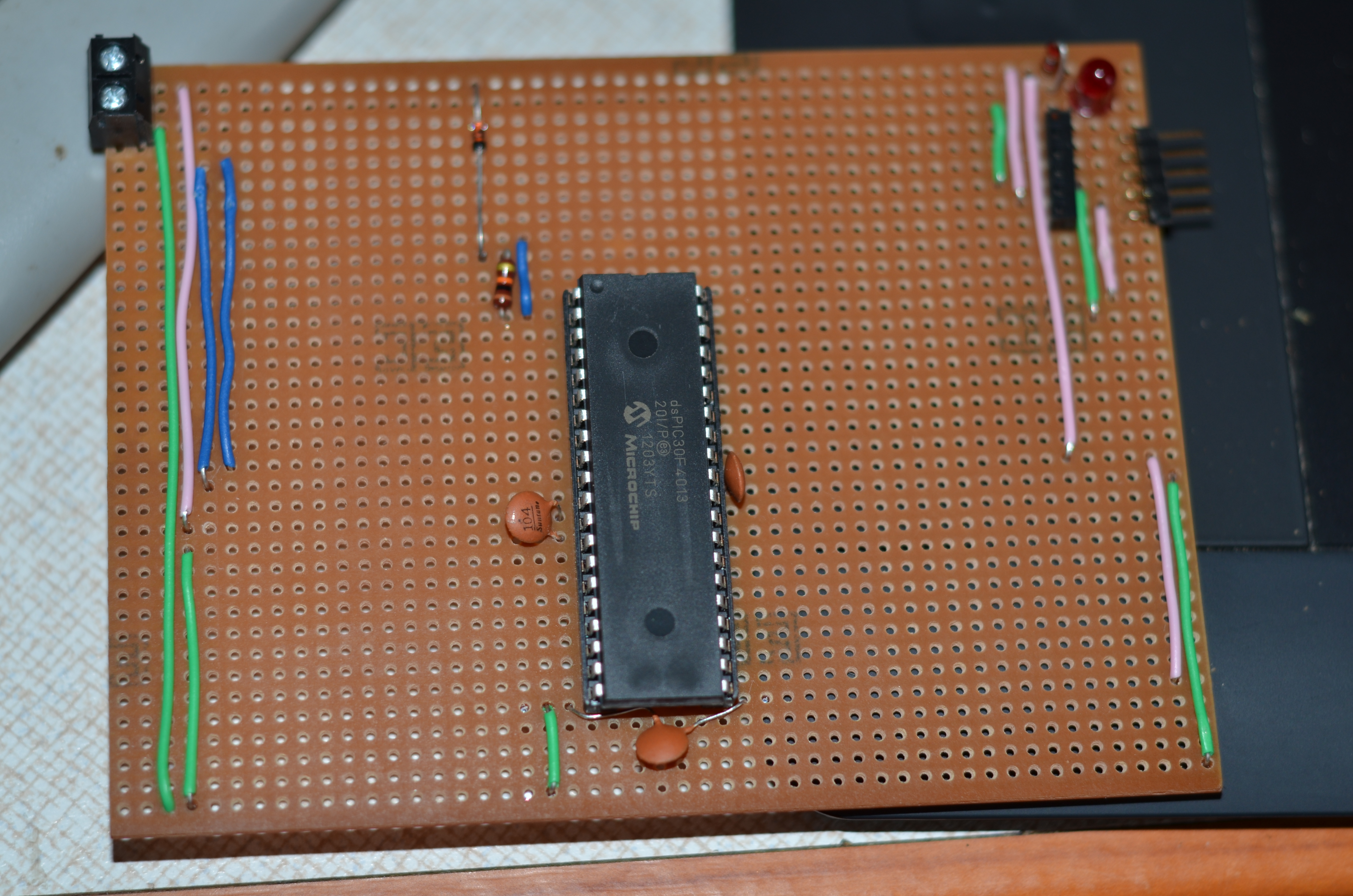

ok first update,
so far just done a very basic strip board, i will add to it as i do stuff but for now is just basic so i can see if i can get it up and running
i tried to upload a pic but dosnt seem to have worked! how do you upload a pic from hard drive? i tried upload file but no luck
ok will try again but so far no luck with pic unless..
That seems to work. You can also try copy and paste (ctrl+C and ctrl + V). John
third attempt! yay. anyway back to the ramblings as this is after all just a notebook type thread for later. the pc i do mplab stuff on is a win7 64 bit machine, i dont use the laptop (mums) for coding. anyway plugged in ICD3 and powered up the board, i was informed that it had to download software for the chip type (i really really really hate HATE this ) it did it ok and then reported the chip was id xxxxxxxxx and it was expecting zzzzzzzz, now normally i get this message with major problems or board shorts or some other foof up, so i unplugged ICD3 and plugged PK3 it also wanted to download a new firmware for the chip type (microchip you utter numpty's for this! it's really crap stop doing it), the PK3 hung!!! now there is a thread on here i did that explains how i got the ICD3 but in a nutshell win7 64 bit has the ability to brick PK3's when downloading new AP's etc. so in a panic i disconnected everything and fired up vmware wich is running 32bit winxp opened mplab in that and downloaded the new AP etc. apparently the not so many problems with ICD and win7 64bit because MC said that it has it's own driver where as the PK3 uses a window usb driver. anyway pk3 alive and well with the new AP but people shouldn't have to do this!!!

so back into win7 and mplab and try again to connect to board! still no luck still getting wrong device ID, so checked device i had selected in the project and discover that i had chosen 30f3014 and not 30f4013! in my rush to try out i had messed up the chip selection! really noob error and down to me rushing as normal! more attention to detail needed. ICD and PK3 connect to board now! way hay!! and thats as far as i have got, for now i will use the config settings via mplab rather than code them in software, main reason is i am not sure of the format for the 30f and unlike c18 c30 dosnt have the handy config settings help file for each chip (MC sort that out it was real handy!!)
