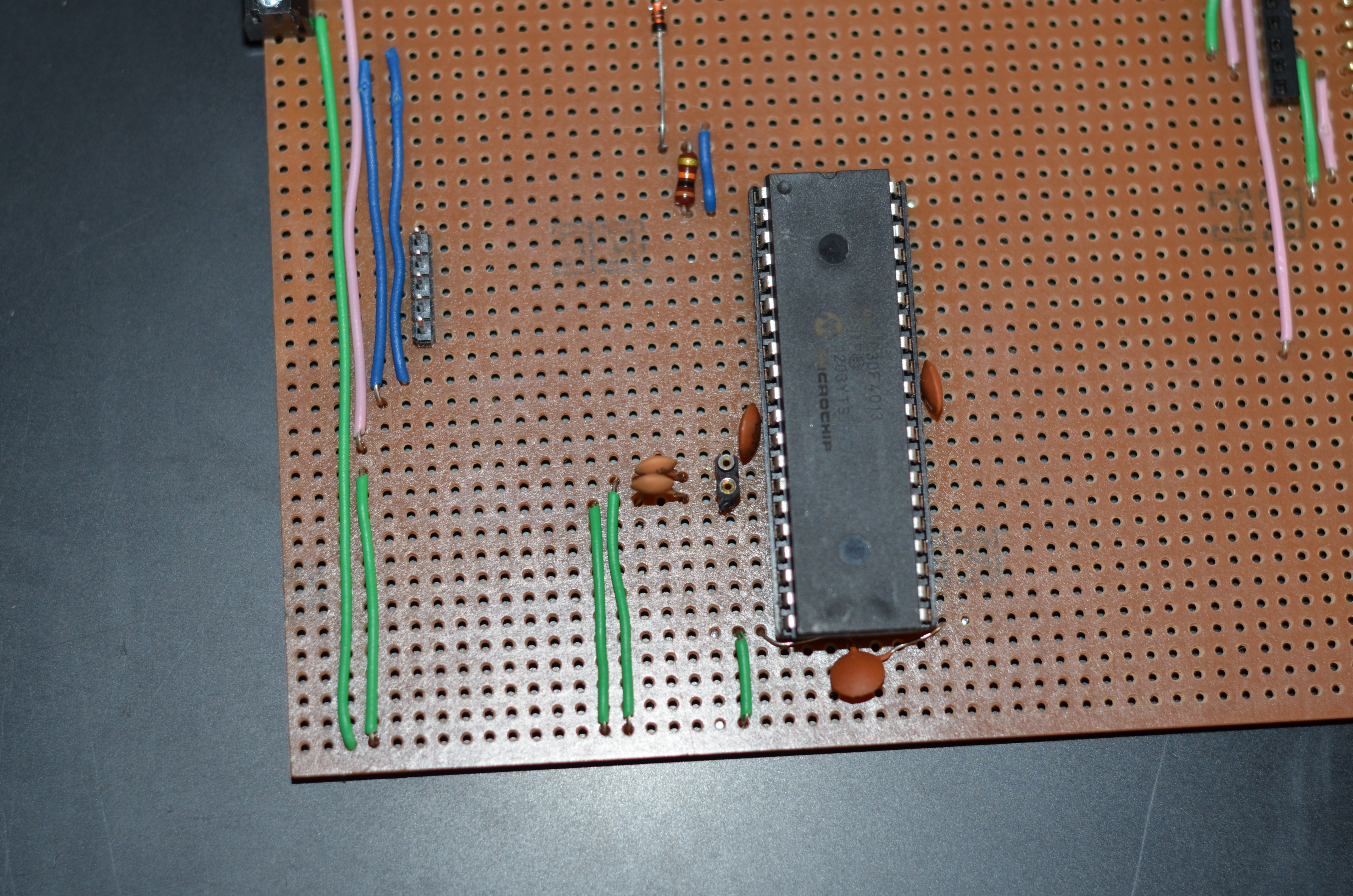

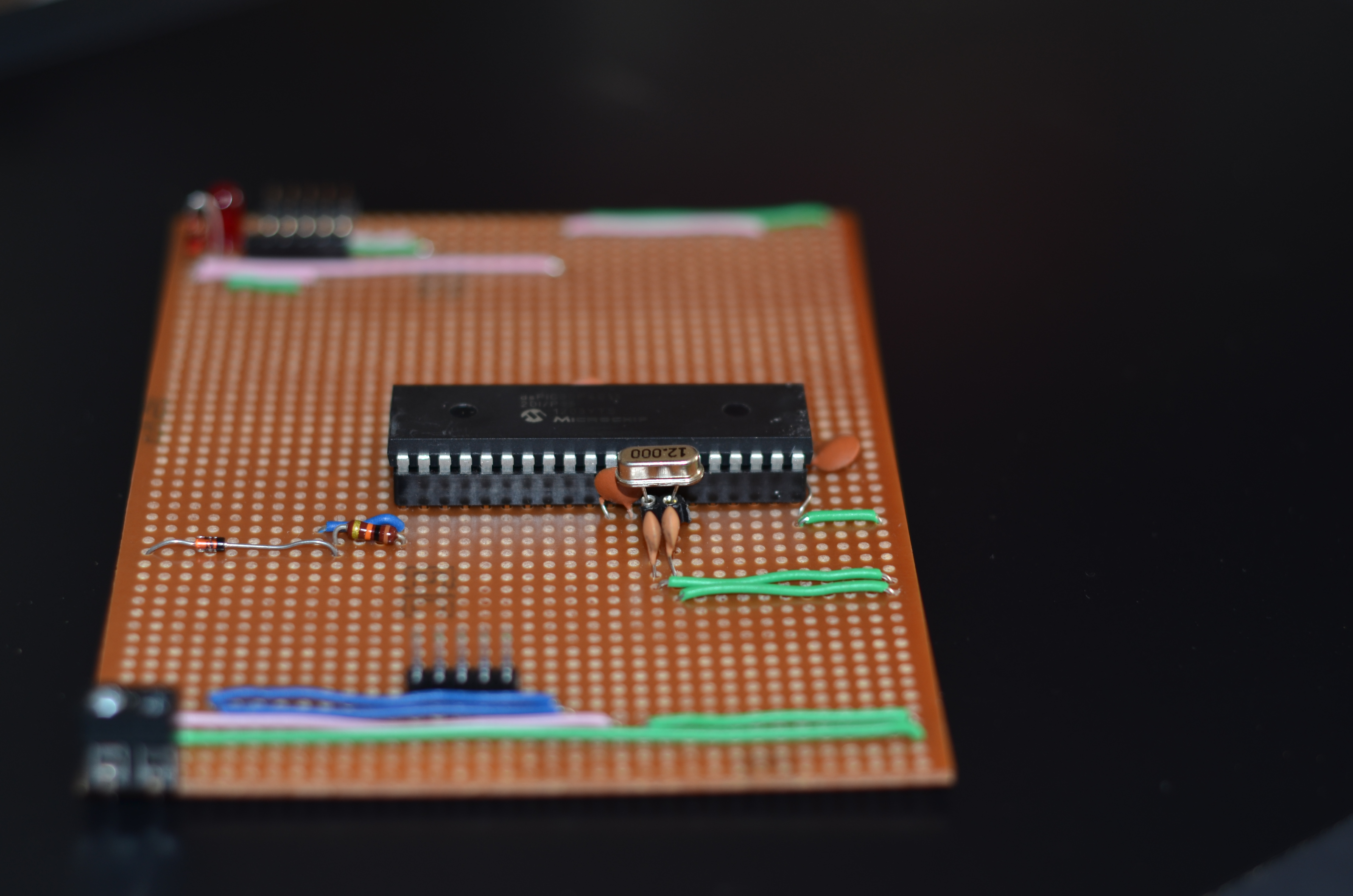

i have now put a socket on the board for crystals as seen in the following pic

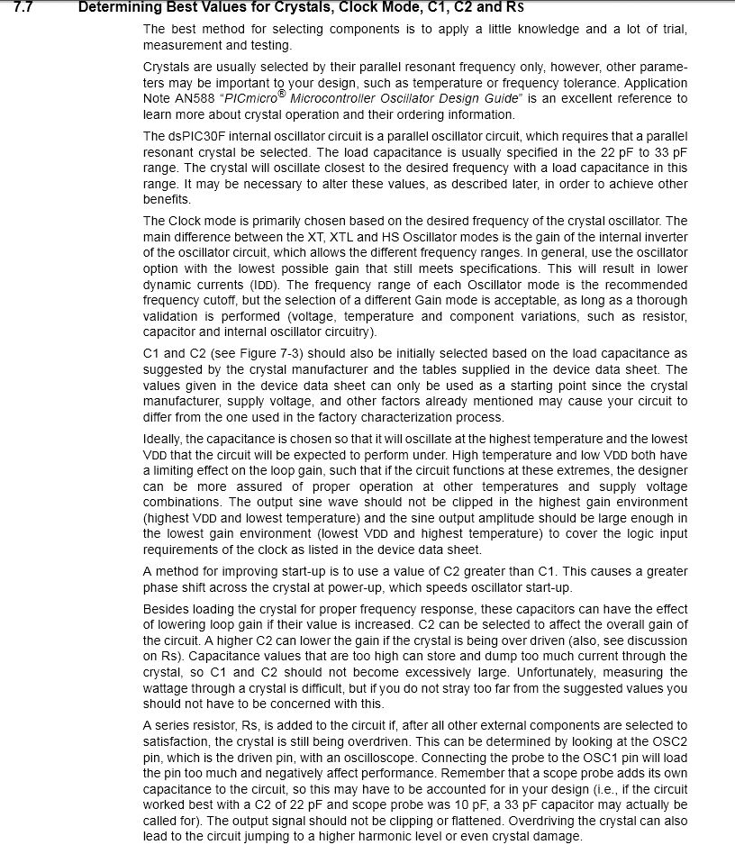

i couldnt find info in the datasheet about caps to use with a crystal but the family datasheet says to use between 22pf and 33pf, actually what it says is
this on page 194 of the family datasheet, the top line basically says to me take a wild guess between the values of 22pf and 33pf and take it from there

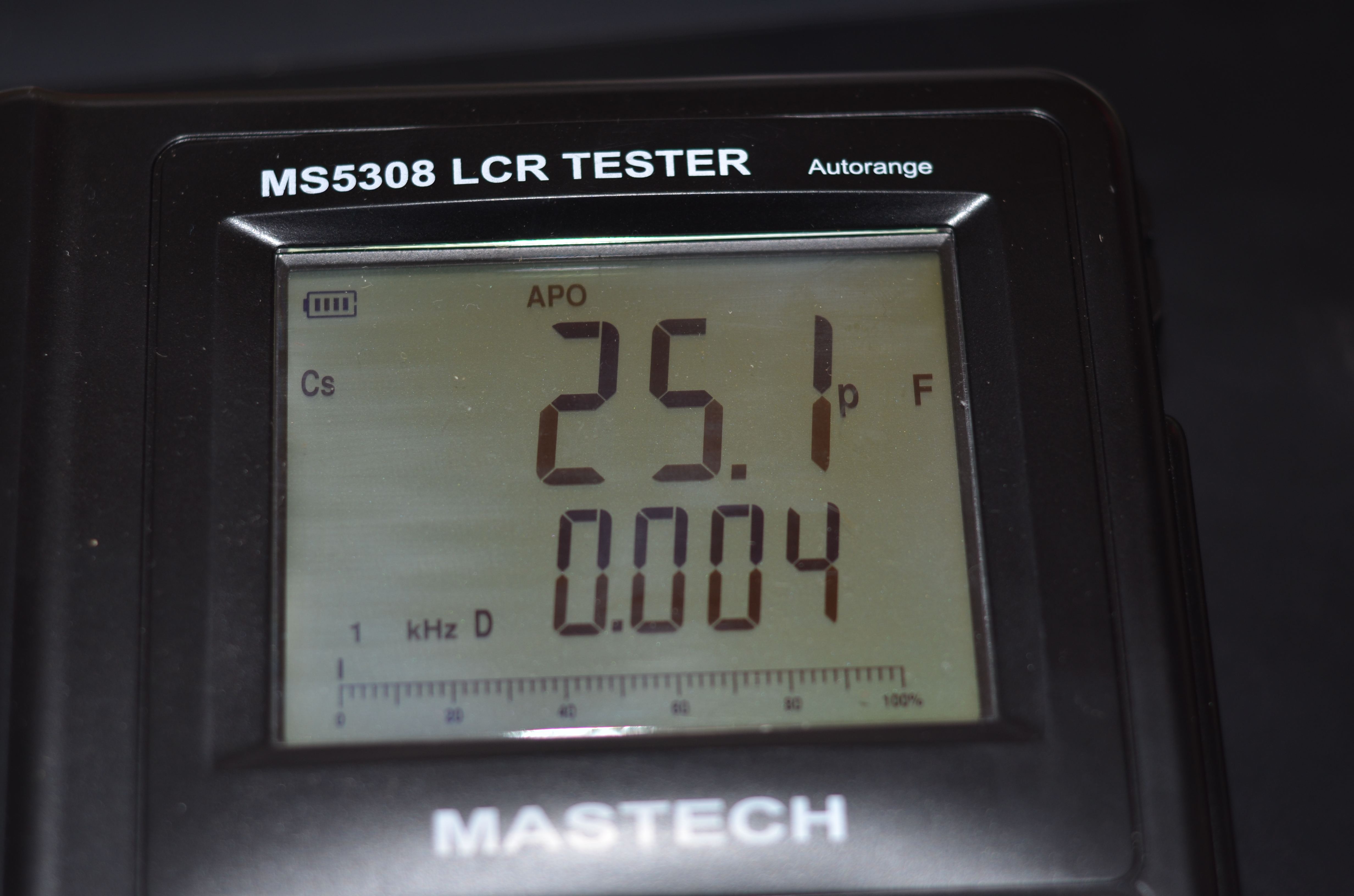

the value i chose was the first cap i found that was in the range and it happened to be 25pf, or to be precise
the other is 25.4pf so close enough!
so the board with a 12 MgHz crystal is bellow

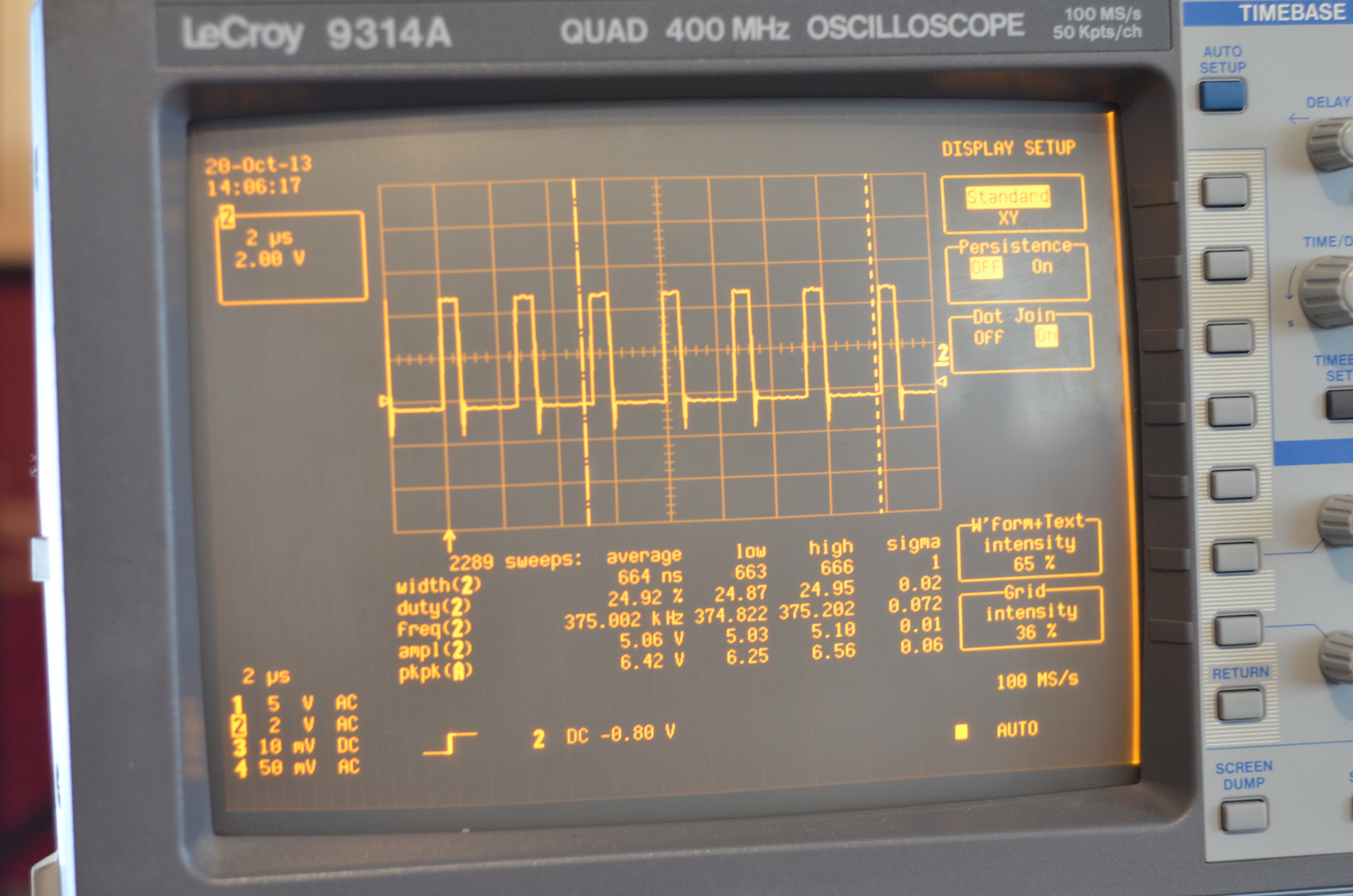

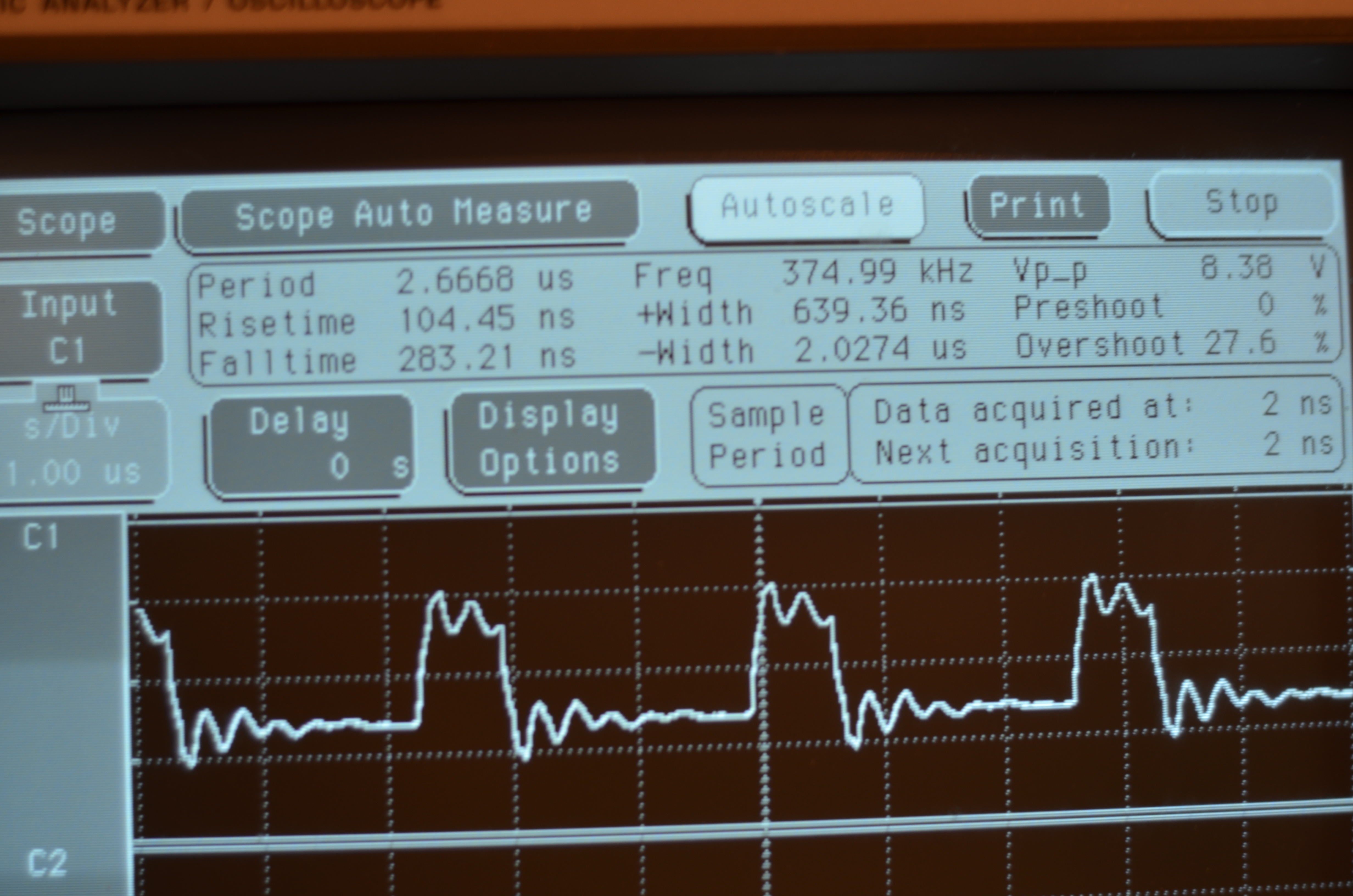

while the oscilloscope on this bench is a good LA and reasonable oscilloscope i am not sure how accurate this one is so i normally use it as a rough guide when i use the scope on it, i will at some point swap the scope over to one the other ones that i am pretty sure are fairly accurate. Anyway the following is a pic of the output from the crystal, now i dont know why but as i have never used a crystal before i was expecting to see a square wave that was fosc/4, but instead as those in the know will tell you i got the following

now for the output i was moaning about in an earlier post, it seems the frequency was right! with the crystal its about 50% higher but then again the crystal is 50% than the internal frequency i was using. however as seen in the following pic the trace is still ugly!!
i assume the fact its not a nice square wave has something to do with the output drivers on the pin, i dont know but might look into it at a later stage, if i have to make a wild guess then i would go with the mosfet driver charging and discharging etc, but its only a wild guess and i will look into it later. anyway thats where we are at! the socket allows me to change crystal easily if i want to switch frequency as we go, next up will be the RS232 layout and board or messing with timer's not sure wich yet but we are at least onto more interesting stuff! thats if anyone is still following my ramblings lol

just a quick update, solved the crappy looking square wave!! i was thinking about designing the max232 board and i got to the thinking part that says must remember to connect both GND's!!!!! light bulb moment, what i have been doing is a classic noob mistake. i normally use a old ATX power supply for projects and the gnd on them is connected to earth and so is my scope GND BUT i am now using the HP PSU and on the back it has a separate earth connection if you want it, so i am guessing that the GND from the PSU is isolated from earth. ANYWAY long story short i put a ground lead on the scope probe and bingo :D no more funny looking output or odd voltages being reported :D and heres a pic to prove it (ok i admit its not a perfect waveform but way better)

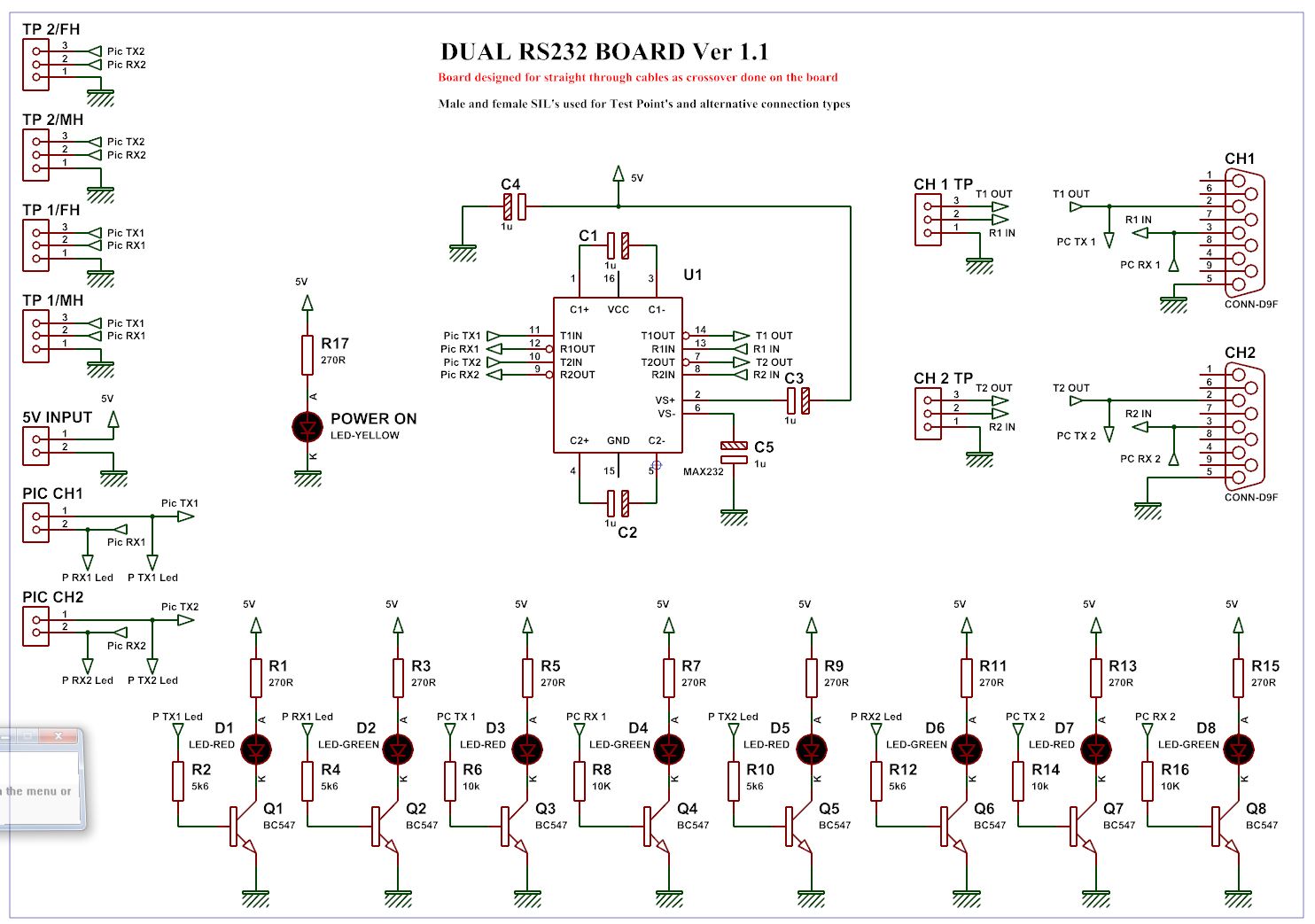

as promised before today i will post the 2 port rs232 drawing, as i need for another project anyway, and to get a bit further with this article i might put a 30f into other project (total overkill) but it will help get this done!
ok drawing done for RS232 board! the reason for why it is like it is can found in this thread rather than me pointing it all out again, besides this is just a record thread of notes for the article!

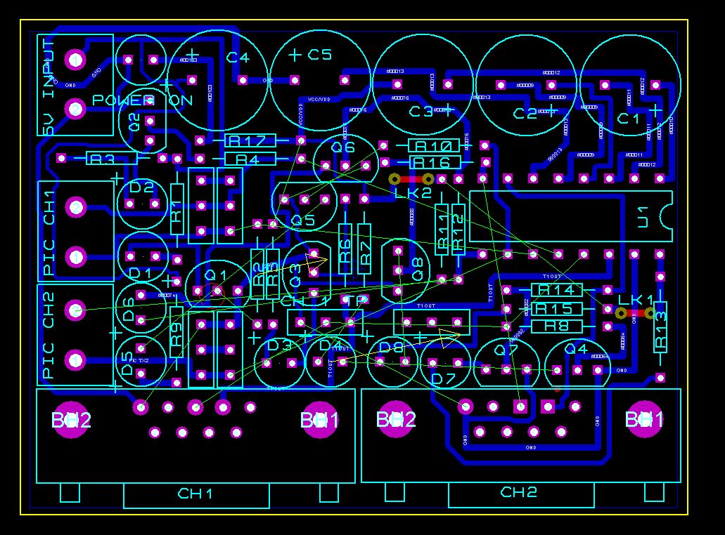

still working on the layout, because i set myself the goal of using the other board offcut for this, it's proven a bit tricky! but so far this is what i have
will be neater than the last board :D
