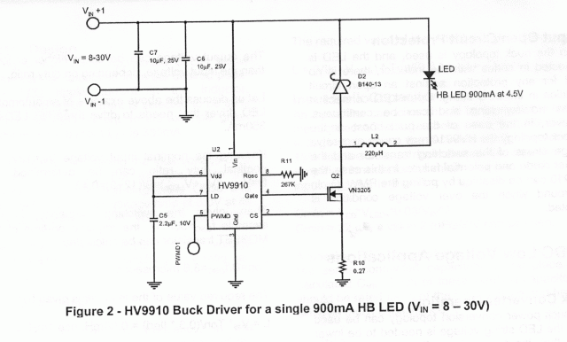

Hiya Guy's,
Well I got my sample HV9910 chips from supertex today and they ended up coming from a local supplier :D Anyway below is a schematic for a high brightness LED, the output is 4.5 volts @ 900mA. Now I've just spent a couple of hours studying the datasheet and trying to workout how to get the output down to 3.6 volts @850mA. I'm going to use a 12 volt 7 amp/hour battery for the power supply. But I'm a bit stumped on how to work it out. If anyone can help me out on this I'll apprecieate it.
Here is a link to the datasheet **broken link removed**
Cheers Bryan :D
What part confuses you?
You need a 0.277 ohm resistor for the feedback. A huge variety of SMD low ohm resistors are available and are easy to solder onto the backside of prototyping board. Leaded ones have far less selection available.
You can use a lower ohm resistor (higher is not possible) if you go with the external voltage reference solution.
SOIC-8 transistors are a really good idea for this. Little heat and they have very low rds for efficient switching.
Diode should be Schottky type. Rating it for at least the 900mA output current is good. There are very common 3 amp ones and I'd recommend those.
That schematic you showed is an example which rarely works smoothly in the real world. You need a RC filter between CS and R10 with an RC time constant of 300nS. The surge (which can be large) of current turning on the gate also travels down the source and makes a momentarily higher voltage on R10, which may result in resetting the output latch. The problem becomes more likely when you use larger inductances which make a nice, clean, low ripple output. Low ripple means that the inductor may only be at 875mA when it switches the transistor on- gate takes 100mA from the HV9910, R10 reads like it's 975mA, way over the theshold, and shuts off the drive immediately.

Hiya Oznog,
Eh mate as you know thats a schematic I pulled off the datasheet. When you say use an R/C time constrant to 300uS could you possibbly show me how it's done. I'm not really sure how to implement that and even the general schematic shown on the data sheet doesn't show it either. I'm a mechanical bloke and electronic's are a great learning experience for me with real life things I can do. So any help I can get is both a help and a learning experince too.
Cheers Bryan :D
