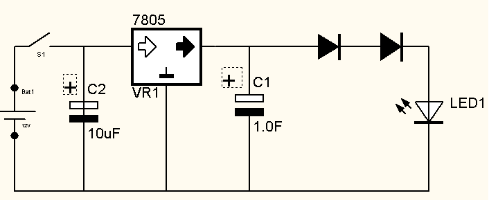

The led is rated at 3.6 volts max and 850mA, in the photo below is a pic of the led mounted on the Alumium projector lamp box I scrounged off an old chart recorder. The box is hollow so the electronics will fit inside perfectly. I've also included a simple schematic which is up for scruentary, the purpose of the 2 diodes is to drop the voltage to 3.6 volts and the 1 farad super cap is just an idea, it would be interesting to see what time it takes to discharge the supercap with the idea being all I'll have to do is to charge up the circuit, lockup the shed and have enough time to get down to the house before the led goes out.
Cheers Bryan :D

put te cap betwen the didoes or the cap will discharge in the regulator wich will thurn it in useles heat.

If the diodes conduct with a drop of 1V like most 1N400x rectifiers, the fancy LED won't have enough voltage to be bright.

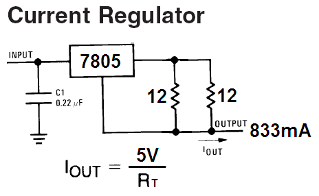

Doesn't the manufacturer of the LED recommend using a known current to drive it? It's easy to make a regulated current source from a 7805.
The 1F supercap will discharge to about 3V in less than 1 second. Can you run very fast? :lol:

Bryan, your schematic does not include ballast resistance. Some form of current regulation is essential. Diodes are the worst choice. If you have that much voltage gap, either drop the reg and use a resistor or use a current reg. An op amp, transistor, and current-sense resistor can do that.
But really, for this power level, you REALLY should use a current mode buck reg or you're wasting almost half your power. That's tragic for battery life.
The supercap is easy to calculate. Just assume the voltage is constant and the current is proportional to voltage difference divided by the series resistance. Hint- many supercaps have too high an internal resistance to supply hundreds of mA. There are some with low resistance though.

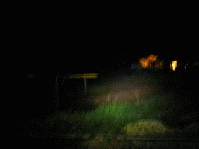

Well I got the light up and running, I ended up using the 7805 on a heatsink, 1 diode and a 0.47 5 watt sense resistor, oh and the neccerary caps aswell. I ended up with 3.78 volts and 460 mA which is a tad high on the voltage but only 1/2 way on the current. I've really got to get a tripod for my digi camera as taking night shots needs a dead steady hand, but here's a photo taken from behind the light and it really does shine right to the house. Looking up from the house ya nearly blinded if you look into the beam.

Wow thats one LED shining on the building back there..? 8)
My one watt Luxeon is truely awesome , i see your three Watt is too..
In fact when i was at my brothers place , i compared my 1W'er to his Halogens shining down in his bathroom (wattage unkown )
My battery powered 1 Watt Luxeon was noticeably brighter than his Halogens...

Yes, now he is using the diode and 0.47 ohm resistor in series with the LED and 5V supply, the numbers add perfectly to cause his low current.
I don't know why he doesn't make the simple current regulator circuit I posted. :(

Eh Audioguru, I did make up the current regulator you posted but the voltage stayed around 5 volts and the limited specs I have on the led is 3.6 volt max and 850 mA current. In all the trials I did yesterday the one I made was the most stable and the 7805 doesn't get very hot whereas before it was shutting down all the time cause of the heat. The 0.47 ohm is the lowest resistor I had onhand and I scrounged it off an old printer circuit board.

Their "How to Drive" document states "LEDs should be driven at a constant current".
In the 7805 current regulator circuit I posted, 5V is developed by the 7805 across the 6 ohms, which results in a constant regulated current output of 833mA. Maybe a Luxion III without a proper external heatsink requires 5V (a coincedence) across it just before it melts. :cry:
