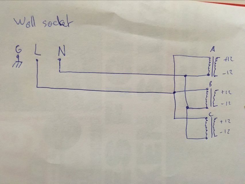

Hello,
I'm currently building a 6 channel amplifier made out of 3 stereo amps in one box. Each amplifier needs a toroidal transformer to get +12/-12v.
I got 3 toroidal transformers (same model) and each amp works very well and does the job so far, it is now time to box everything!
I was wondering if it was possible to power all them 3 transformers from only one 220v power socket (basically connected to the wall, see the image). I don't see why it would be a problem, but as it is the first time I'm dealing with a "custom power supply" I prefer to be sure that my device won't be dangerous. The box is made out of metal and will be grounded by a wire connected to the G of the 220v power socket (i noticed industrial racks using this method with the green and yellow wire screwed in the box).

so my original assumption was correct, thanks a lot ! nothing silly, 24w per transfo :)
With toroidal transformers in a metal box, make sure that the mounting bolt doesn't touch the case or lid at both ends. It's fine for the mounting bolt to connect at one end.
Yes it will be mounted only at the bottom. I would be curious to have a deeper explanation of the phenomena (i've read it could melt or so) when it is connected bottom/top, if anyone have time to explain me I would appreciate very much !

It's quite easy to add turns to a toroidal transformer. This post https://www.electro-tech-online.com/threads/kef-psw2500-active-base-unit-repair.159244/#post-1380354 shows where I did that deliberately to give an additional output.
A 24 W transformer will give something like 0.1 - 0.2 V for a single turn.
If the bolt touches the metal case, it can form a secondary winding, with one turn, with very low resistance, so a lot of current can flow. I think that with a 24 W transformer wouldn't melt a bolt, but there would be a big increase in primary current and the transformer would get hot, and the voltage of the main output would be reduced.
You can put as many things as you want in parallel, up to the rating of the 220 V socket. Having the transformers and a 5 V supply is electrically equivalent to plugging each one into a power strip.
Transformers and power supplies, especially toroidal transformers, can take a lot more current for a short turn-on surge. Also a 24 W transformer can take more than 24 W as input power, as it will be less than 100% efficient. However, three 24 W transformers and a small 5 V power supply will be taking far less than 1 A in total, so a 16 A plug will provide more than enough power.

And the transformer would burn up - a thick single shorted turn round a toroid will pass a LOT of current, and the transformer would seriously overheat and very quickly die. If there's a reasonably sized mains fuse in the circuit, that could well save it - but it depends on the rating of the fuse, and the actual overload current involved.
Obviously it's actually worse in this case, as he's paralleling three primaries - and 'presumably' with only a single fuse - in which case the transformer could take at least three times it's maximum rated current, and not blow the fuse.

Thanks a lot for these explanations ! it starts to be more clear to me ! :) Ofc I can power a circuit until I reach the capacity of the power outlet, as coming from the same wall socket it's like everything is plugged together.
Silly questions then:
why don't we use plastic to mount the transformers in order to maintain attach them to the bottom or side of the enclosure, is it because metal is more robust ? Either, the top or bottom part of a device could be a wood or plastic panel for example ? (but then there is higher risks of fire I assume)
Indeed I didn't thought about installing a fuse, do you recommend doing it and if yes, where would be the optimal placement, pre-transformers I suppose ?

There's very little voltage between the top of the bolt and the lid of the housing. It's only one turn, so just a small voltage, so there is no electric shock risk from the mounting bolt. It's very common to have exposed points - look at car batteries. Good designs have a gap to the lid so there is no problem. A plastic bolt would have to be much larger.
The reason that there is a warning is that there is nothing to warn that there is a danger. You could look at a commercial design with a toroidal transformer, like the one in the link that I posted earlier, and not realise that there must be a gap. There is no insulation other than the air, so nothing to see, and the voltage is so small that you can touch the bolt and you won't feel anything. Also it can be that the lid causes the short, so it could be a fault that goes away when the lid is removed. It is also difficult to protect against the over-current caused, because the extra current may not be very much, and the fuse has to take the turn-on surge of the transformer.
A fuse may help, but it is difficult to protect a transformer with a fuse. If you followed the calculation in my last post, there is less than 2 A at the input if the transformer is shorted out. So your fuse would have to be less than that to be of any use at all. There will be a turn-on surge when the transformer is turned on, which the fuse has to survive, and it would have to survive three transformers being turned on at the same time, but protect against one being overloaded. Transformers are extremely reliable if they are not overheated, so a fuse is protecting against something that will never happen. A fuse on the output of each transformer may be of more use. The ELCB that protect the socket will protect you better than an input fuse.

It's absolutely essential to fit a mains fuse, immediately where the mains enters the unit.
Even more so outside the UK, as most other countries don't have fused plugs - and even in the UK someone could replace the smaller plug fuse with a 13A one!.

The transformers are 24 W each, I think you said. If that's right, the total power for three of them is 72 W, which is around 0.33 A at 220 V. However, transformers aren't perfectly efficient, which means that they take more current than that. There is also magnetisation current that they take even with no load, so you need a larger fuse, maybe 0.5 A or 1 A.
The large current that a fuse has to survive is the turn-on surge, which would be around 2 A per transformer for up to 1/4 of a mains cycle, or 5 ms at 50 Hz. A slow-blow fuse of about 1 A would easily handle the 6 A for 5 ms (https://www.farnell.com/datasheets/2349120.pdf)
You should be aware that the fuse is not always going to protect the transformer if it is overloaded. If a single transformer is shorted, it will only take 2 A. A fuse rated at 1 A can take 20 minutes to blow at 2 A, so the transformer could be damaged before the fuse blows.

Diver300's misconception is that the fuse is there to protect the 'transformer' - this is completely untrue. The fuse is there to protect YOU the user, and any other people in the vicinity. In the case of a serious overload, such as a S/C rectifier or S/C transformer, it will take massively higher current and probably eventually burst into flames. Before this happens the mains fuse should blow - so the transformer has gone, but you're still alive, and your house hasn't burnt down.

I agree that a fuse should be fitted, to protect the wiring, if a transformer fails.
I didn't say that the fuse was there to protect the transformer. I said that it was likely to fail to protect the transformer. A better protection for the transformers would be an additional fuse in series with the output of each transformer.
