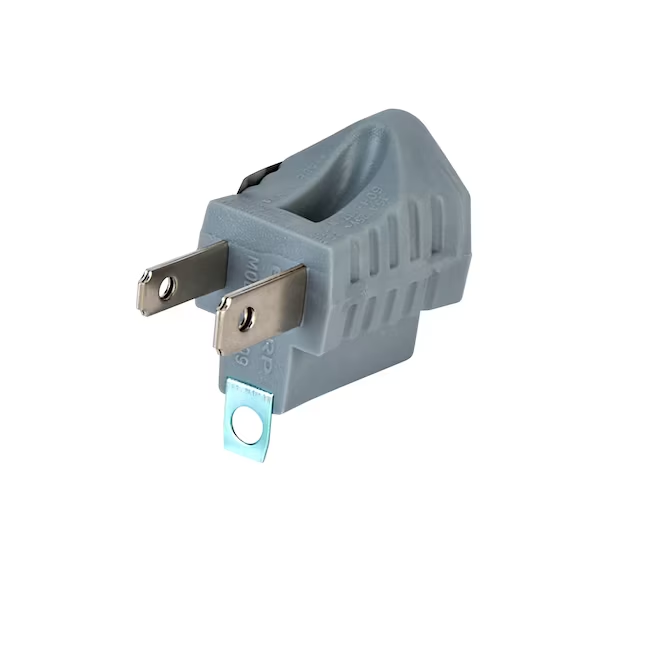

3 to 2 prong death-daptor
Athosworld
I purchased this in a country where people are very ignorant and use this without the ground attached to that screw, and they don’t even have breakers, RCDs of GFCIs on their electrical system. Also THERE IS NO GROUND anywhere and they have 3 prong outlets.
The 3 to 2 adapter is not polarized, the wall is not polarized so It does not matter.
The lamp you plug in has no ground wire, so it does not matter.
Old lamps were not polarized.
Every day "people are very ignorant" cut off the third pin.

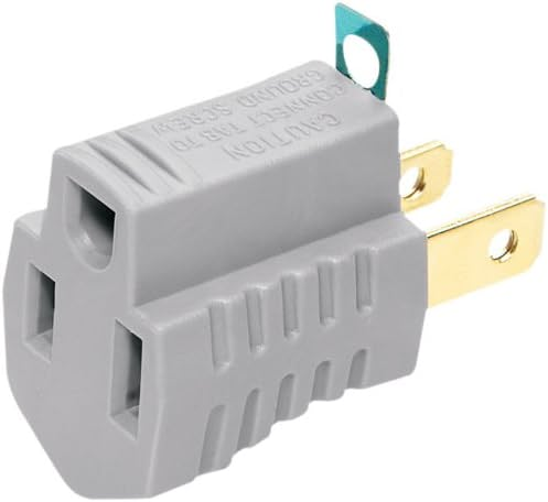

Probably better to use a 3-2 adapter than to cut off ground. I know it is just as dangerous, but a working 3 wire appliance can be moved to a new house someday.
The newer 3 wire to 2 wire adapters are polarized designed around the newer sockets having one blade larger than the other.

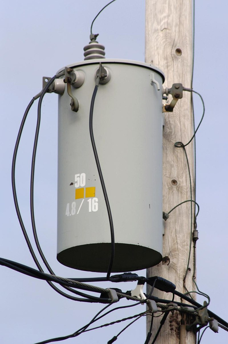

As to US residential mains. Typical pole mounted transformer.

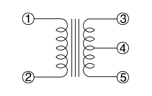

In the above image the primary transformer input is about 7.0 KV picked off one of three phases. In more populated areas three phase runs through a residential area. Transformer to transformer they just stager which phase is used for general load balance. In rural farmlands the high voltage may just be a single line. The primary is the HV insulator on top to Ground and the can is grounded. The three outputs are 120 VAC split phase and note the center (ground) is strapped by a short bus tab to the can. So we get 120 volt 0 volt 120 volt or 240 volts line to line. At the mains entry point Ground and Neutral are bonded and that is the only neutral and ground bond.
So it looks like this:

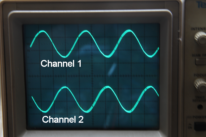

! & 2 are primary 1 is 7 KV and 2 is ground. 4 is ground so 3 to 4 is 120 volts and 5 to 4 is 120 volts but 3 to 5 is 240 volts. If we view both lines to ground on a scope they look like this:
L1 and L2 are, as previously mentioned 180 degrees apart. Triggering on Channel 1.
Like many adapters there is a time and place for their use. Use things incorrectly you may get unwanted surprises. One 3 to 2 adapter I have laying here has stamped on it "Caution connect tab to ground screw".
