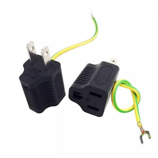

I purchased this in a country where people are very ignorant and use this without the ground attached to that screw, and they don’t even have breakers, RCDs of GFCIs on their electrical system. Also THERE IS NO GROUND anywhere and they have 3 prong outlets.
Any other panic you'd like to try and start?
absolutely shocking news but it's a 2 to 3 pin adapter and they will know when there is a problem and learn not to have damp shoes and then touch a metal appliance in humid weather.
THIS is a death-daptor.

That's a US plug. Older homes often don't have grounded outlets. The center screw of the outlet may be grounded. One side of the outlet is at 120 volts, the other is neutral, but in old 2 prong outlets, there's no telling which is which. On more recent two prong outlets, the neutral leg is wider (taller) than the hot leg.
Is the American system a Star connected system with the neutral at the center point which is grounded? If so, won't any connection of live(hot) to ground cause something to trip? And the OP states that "the country" has no ground anywhere or any kind of breakers. Surely this can't be the USA.
I can't speak for what country he's talking about, but that type of adapter is used in the US with older outlets that don't have the third ground pin.

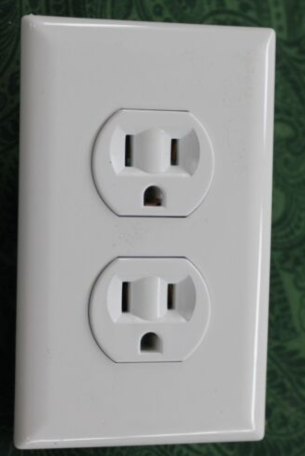

Here's a modern 120v outlet. Narrow pin is hot, wide pin is neutral and the round pin is ground.

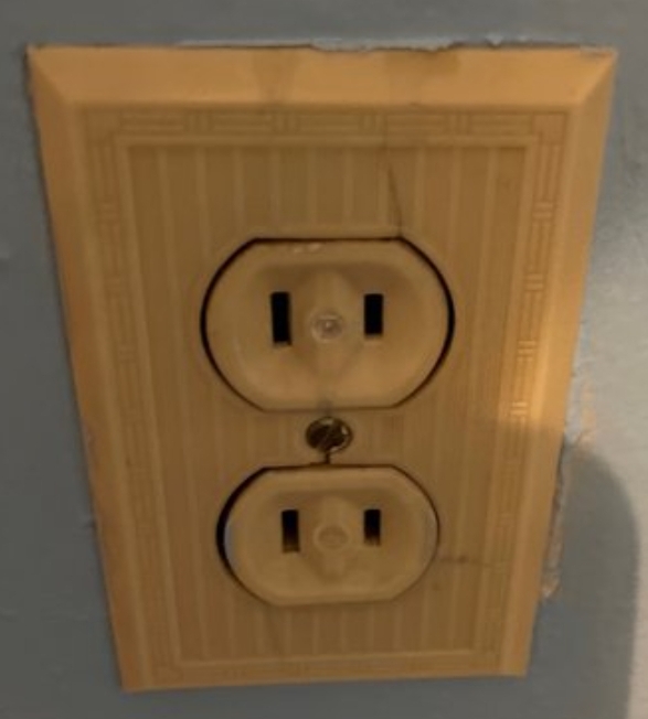

Going back in time, polarized 2 pin outlets were used. Wide pin neutral, narrow pin hot, and possibly a ground connection to the outlet box, making the center cover plate screw ground.

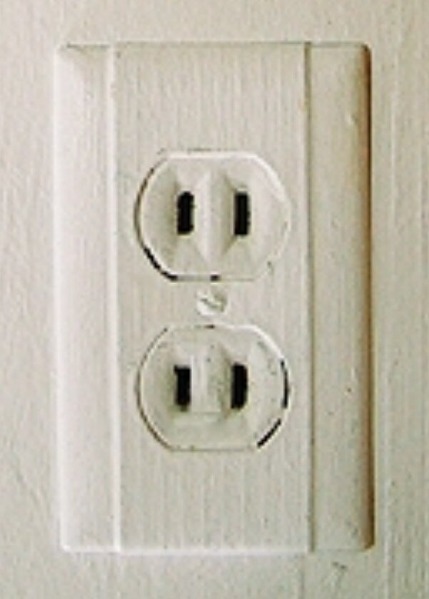

Going further back, this is a non-polarized outlet with both prongs the same size. Chances are the center screw is not grounded.

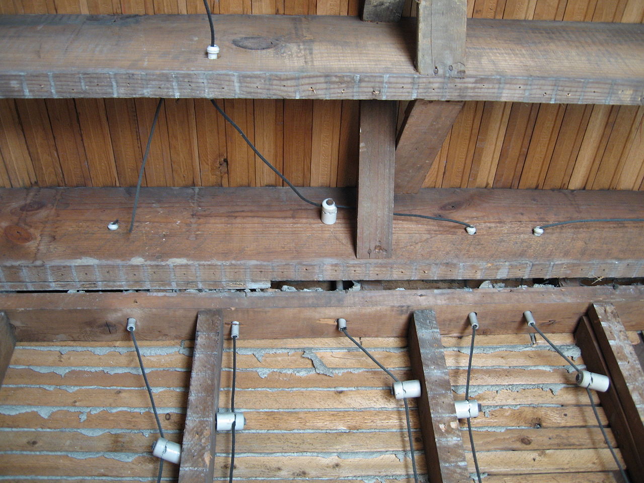

The wiring for this type of outlet often was "knob and tube" which used two separate conductors with cotton insulation. The wires were run maybe 8" – 10" apart, secured periodically with knobs (ceramic insultators) and protected where they ran through studs (framing members), floors, etc. with ceramic tunes. It will be the worst day of your life if during a remodel, you open a wall and find knob and tube wiring! Your project justed turned into a total gut job.
