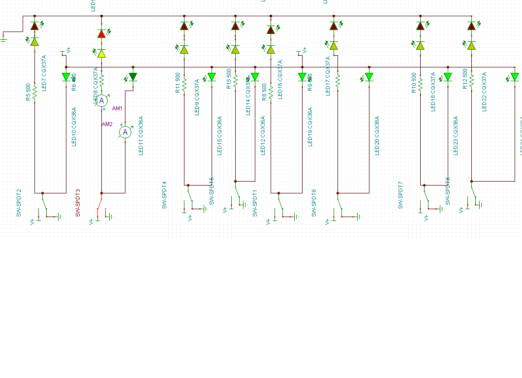

here is an easier method
In TINA I simulated this very simple circuit. no transistors (depending on your sensors of coarse)
if you want the TINA file I can email it to you.
this circuit has been bugging me for severl days and BAM! came up with a very easy way to do it.
just remember the yellow and corresponding green is the block AFTER the red. That way the block where the train is is red with the yellow in the next block on.
one slight problem that just occured to me is that two green leds must be off. not a big deal I don't think.

Unfortunately I wouldn't be able to use the TINA layout as the demo only allows for about 9 components. Then it says it's too large a circuit for the demo version. I've tried one block but when green is on current through yellow/red is somewhat strange.
Reversing the switch and having red and yellow on seperate outputs onto one pole of the switch works, then green on the other pole of the switch, all with common ground.

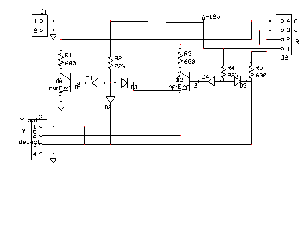

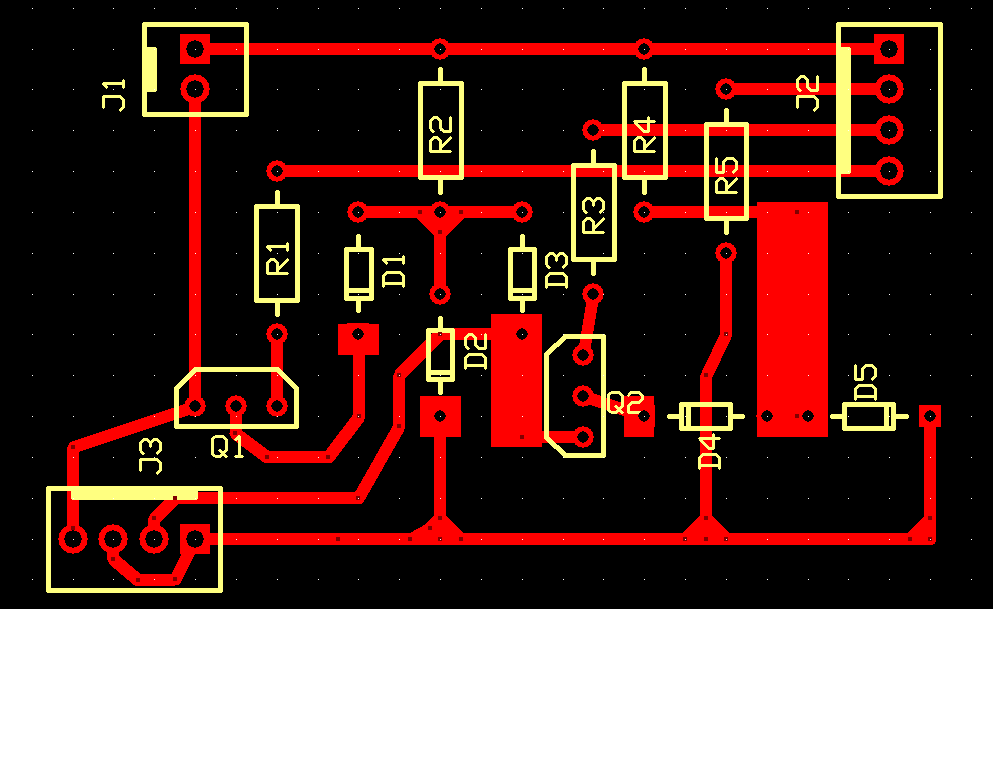

schematic and pcb layout
for one block
you mentioned 20 blocks
all on same board or separate boards?
As I mentioned I can etch and drill a board for you . you just pay for shipping.
I layed out board similar to schematic for ease of assembly etc.
large traces if you draw with felt pen

Still having a problem with the signalling circuit tho'. Just built a third one, checked old components on previous board and they're all fine.
When the base is touched the green led glows brighter. Is this due to radio interference, i.e. signal diodes being used? This happens on the breadboard too.
I've lowered the led resistors so should the other resistors be lowered in resistance too?
I'm wondering if the stripboard is too much copper near to each other, thus an etched board might fix it. For example, I've put a gap between the collector ond base, and the base and emitter on both transistors. When I touch the track between the collector and base of Q1 the green led glows when yellow led is on.
Currently got problems with red led, it's not knocking off the green, but sharing power, both lit dimly. Gonna give my brain a rest for a day, then check circuit again.

Yay, I just removed a couple of the unused tracks between Q1 pins and it works apart from having a faint glow in green led. Even with all three blocks switched to occupancy they all show red with my stripboard circuit having a faint green led glow.
Not sure what's causing it but it's fainter than it was so when I etch the this the tracks will be as far away as possible from each other. It was like my finger on the base was acting as an antennae!

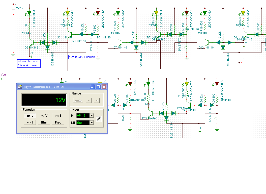

I wish you could use TINA and probe all the voltage points.
how about LT Spice?
voltage readings in block one
first is all blocks closed
second is all blocks open (no train)

lets try something to track problem down
take photo of bottom (trace side) of your boards
start assembling one board with one block( 3 blocks would be better but.
Start by JUST soldering the GREEN LED componets ONLY (R1 and Q1 D1,D2)
then short to ground D2 output.
GREEN should come on full brightness.
ADD the RED LED componets (R4, R5, D5)
switching on/off the detect (switch to ground) the red should go off and red come on FULL BRIGHTNESS
if either of these tests fail then you have a soldering or component problem.
Are your diodes in correctly?
are they 1n4148?
correct resistors as per schematic (the R1 R3 and R5 can be 500-600 ohms instead but all must be same value)
let me know what happens.

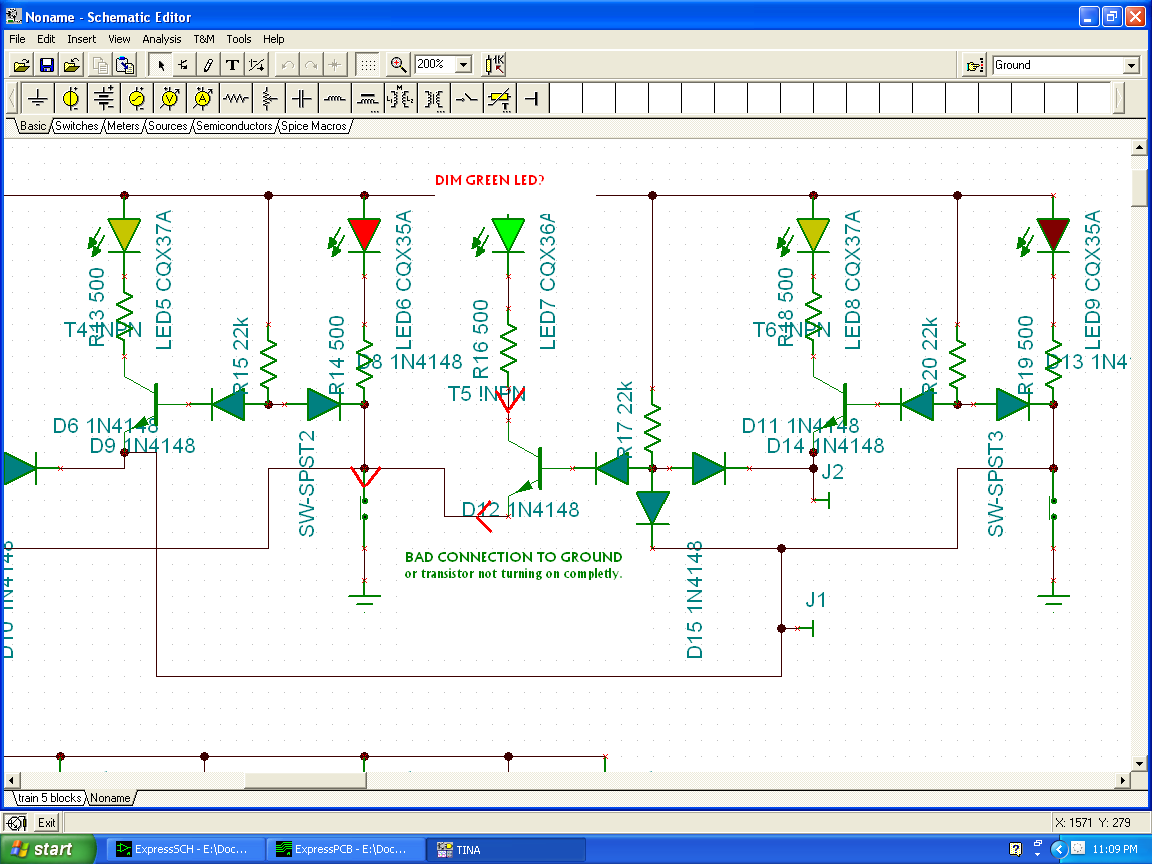

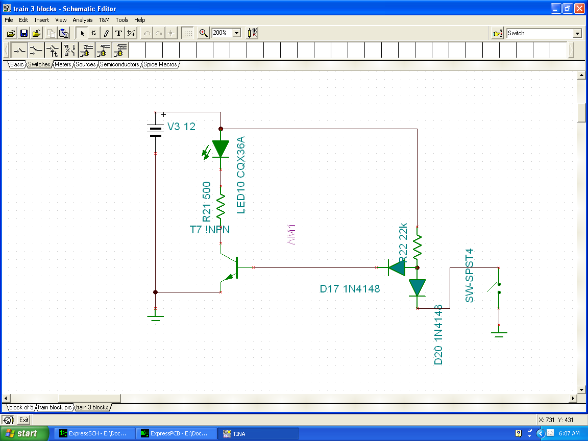

TINA
I uninstalled Tina 8 and put in Tina 7, from the link you sent. It allows more components but I cannot 'activate' the circuit to test what happens when switches are thrown as the green button for that function is not present.
Diodes
All are 1N4148 with black band/cathode as per datasheet. Mounted correct way round as you can see here **broken link removed**
GREEN BUTTON??
you click on the T&M (between analisis and tools
click on the DMM-VOLTS
then when you click on the probe icon n the DMM the LEDs light up.
click the probe icon agai, then mouse over a switch(little arrow pops up, click on and switch is throwen
then click probe and other LEDs light up.
YOU must have at least one TI ic in the screen a;ll connected (use a sample circuit)
PLAY with it, youll get the hanfg of it.

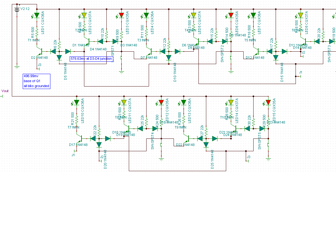

What is the base voltage on Q1 with switch open?
why is R3 a different value than R1 & R5??
do you have a ground as pic dosn't show a terminal for ground??

Ok, got TINA working. Working from this image **broken link removed**
I'm now using 560R on each LED on the latest stripboard build and breadboard builds. I had used different values to get equal brightness from led's.
I've added SW2 off board from blk- to ground to replicate red on block ahead, so yellow led lights.
Also added 12v out from board to common led positive.
Detect currently goes to ground via switch. When this all works, the detect circuit will be on same circuit board with detector power from main track power bus. Signalling side of optoisolator replaces SW1.
Base voltage Q1
SW1 open: 800.27mV
SW1 closed: 419.27mV
Yep, ground for green led is lower of the two connections on the top left block connector.
Ground for detect is via switch on breadboard to common ground.
Voltage is from common 12V on breadboard.
does it look like its working?
if you pm me with your email I will send you the TINA file with all 5 blocks
when it looks like it works then probe different points and compare with your strip board.
I am curious why the strip board does not work?
Got to be a loose or missing connection.
