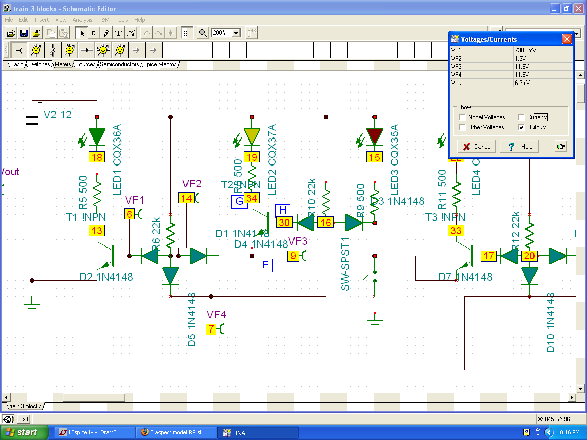

Here's the circuit I used with the testing points marked alphabetically
And here's the results
With switch open, green on, not too much of a difference allowing for power supply slight variation over TINA's.
But I notice the major reduction in voltage at (F) and the major increase at (H) when switch is closed, red on.
With Yellow on, about a 1V difference at (E) and (J)
Now I have the values and I see the differences would I be correcct in assuming there's a problem with Q2 as (F) and (H) are points at Q2 and this in turn has an effect on (J) ?
You may have discovered why the thing dosn't work right.

easy way to get table of voltages
click on meters
add test points as desired (see vf1, vf2 etc
click on analisis-table of nodal voltages
have only outputs selected
you now have table of results.

I think you can print out the simulation results and yes there is an issue with Q2 at point F (.700 is pretty much close to what Q2 will lose (use up) and point H Ithink is related. To see what I am referring to I will post a pic of transistor simulation.
simple method to see what your transistor is doing.
remember you want the transistor to be saturated (on completly)
by changing the base resistor value and base voltage then shorting out across the collector to emitter you can see if the voltages are at least .6 volts apart. the closer the voltages from collector to emitter the better the transistor will conduct.
Try inserting a relay and then the base resistor should be in most cases a 10 to 1 ratio compared to the collector resistance.
insert amp meters etc, have fun with TINA. GREAT learning tool.

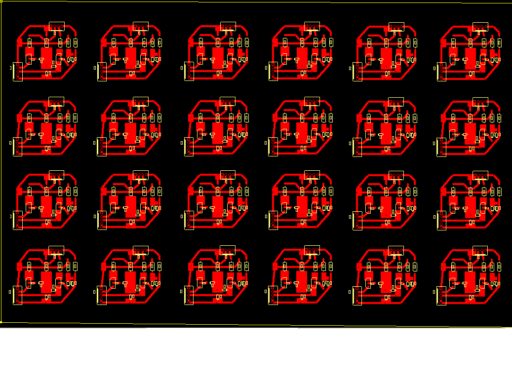

You needed 24 boards
here is a pic of 24 PC boards with 1.27 traces
If you want I can mail you either PULSAR PAPER or boards w/ printed traces on board.
Even etch if you want but you already have chemical.
Let me know as I am doing some boards by the weekend anyway.
