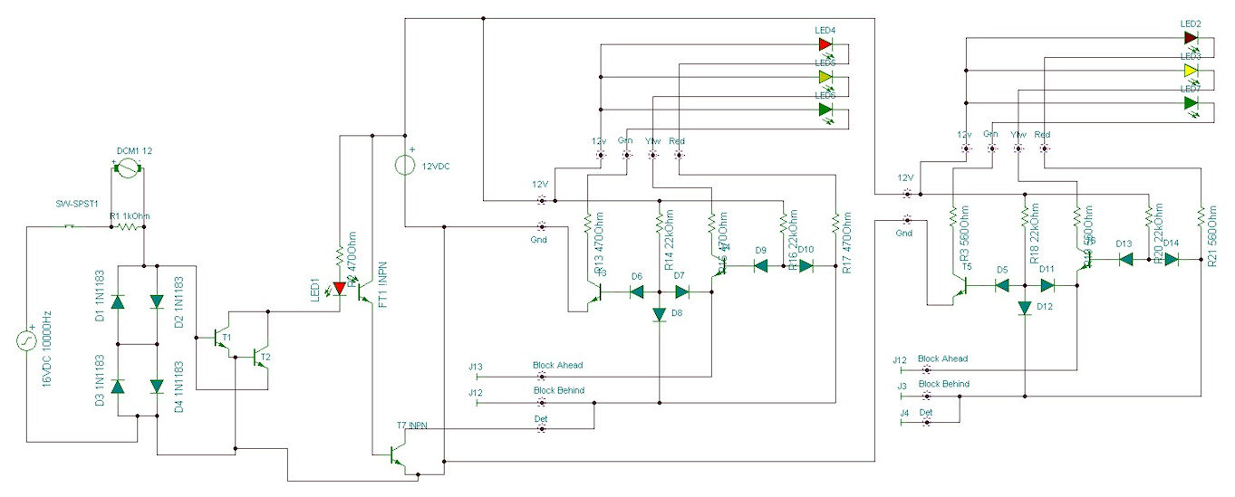

I've added the optocoupler, but although the red signal comes on and the yellow signal comes on on the previous block, the green signals don't go off at all, or even dim.
When I press the actual switch for the red signal, the green goes out on both blocks, the red comes on and the yellow on the previous block comes on too.

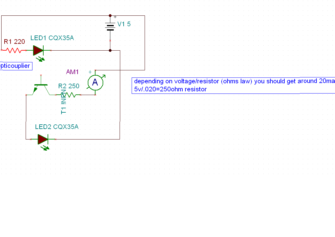

connect amp meter as showen on a bread board or ?
I think you mentioned that the opti couplier needs 50ma?? sounds high.
double check your specs.
could maybe be the twin t no turning the led on full(in opti)
test current through the opticouplier.

Ok, I built the 4 diode rectifed 2 transistor detector as below with a 470R resistor and led. Wired to track 15VAC DCC and 12VDC. This worked. LED lit when finger placed across track. Worked when loco placed on track, even when stationary. Exactly as it should.
https://www.electro-tech-online.com/attachments/working-jpg.36249/
On breadboard next to the detector circuit are two signalling circuits. Both linked so when one block is red the other is yellow, orbth are green.
These signalling circuits had normal push to make swtches and bot worked correctly. Each led has a 390R resistor.
I replaced the led on the detector circuit with the optoisolator (pins 1 to 2, anode to cathode) and connected the detect from the signal circuit to pin 4 (collector), then connected pin 3 (emitter) to ground.
Powered up. Green signals on. No loco on track. All good.
Put loco on track, red signal on one block lit, yellow on other block lit. Green leds did not go out. That's the problem. They should have both gone out when loco detected.

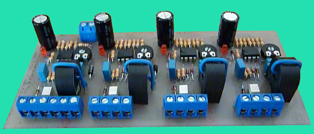

Hi Guys. I'm new here. I have done several block detector designs for DC & DCC systems.I've just done a 4 channel DCC unit using current sense transformers . Completely isolated from the DCC as it's input is via an in-line transformer and has opto isolator outputs. Can I be of any help?

The led side of the optocoupler is 5mA to 50mA operating range, 1.5V.

I wonder if your pulling enough current to light the opticoupler? after you add a resistor to the led.
insert amp meter to check current draw.

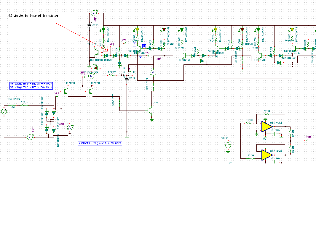

possiable solution
found that placing two diodes to the GREEN LED base transistor might work
Also drive the "dector switch" transistor off of the emitter of second transistor.
changing the resistor to the collectors changes results. Maybe a pot but 300 ohm seems to work w/ LED in circuit.
NOTE the LED is for indication only. Don't really need it.

Ok, so the two diodes option didn't change anything noticeably.
I added a 1N4148 transistor as per image, driving it off the opto isolator. It has now reversed the problem.
Loco Present
Greens off on both blocks, red on yellow on
No loco present
Greens on but red and yellow only dim.

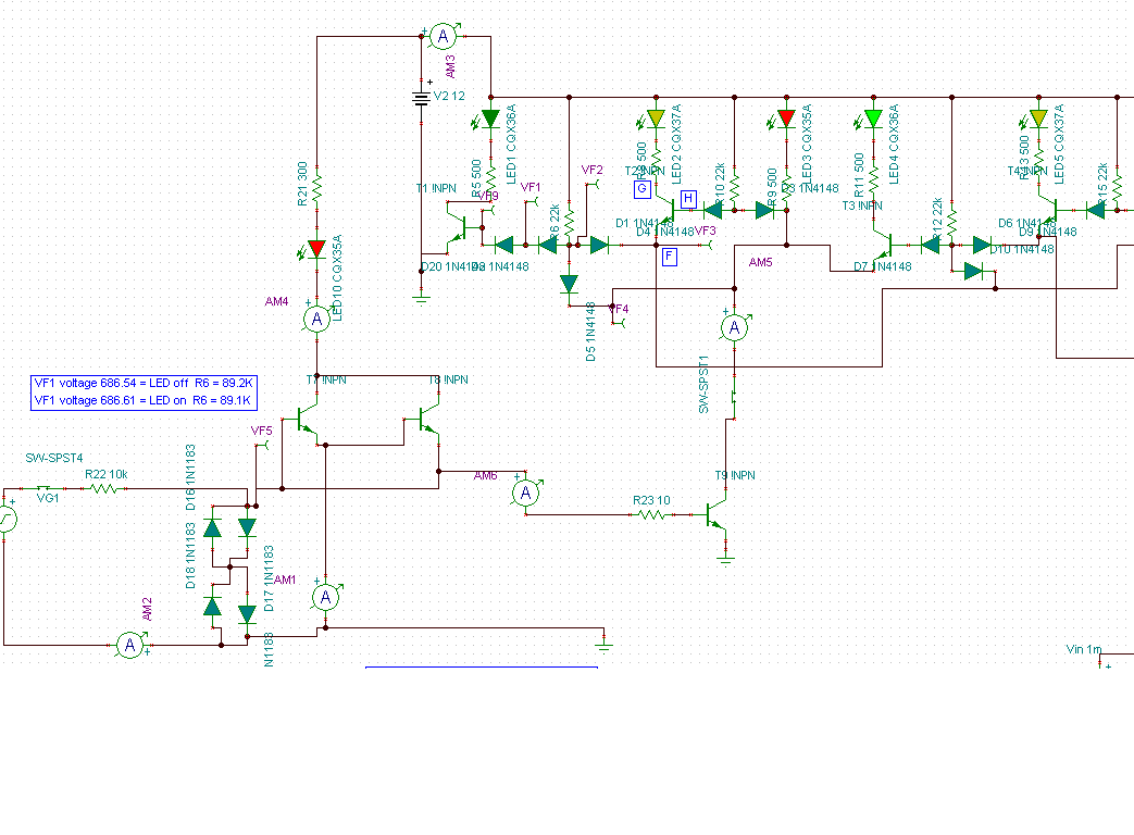

you have it connected wrong
put second 1n4148 diode and eliminate the opticoupler. add an NPN transistor, a base resistor (not really needed as current is really low.
change connection to added transistor , connect to emitter of second transistor (T2 in you diagram)
see my attached pics
