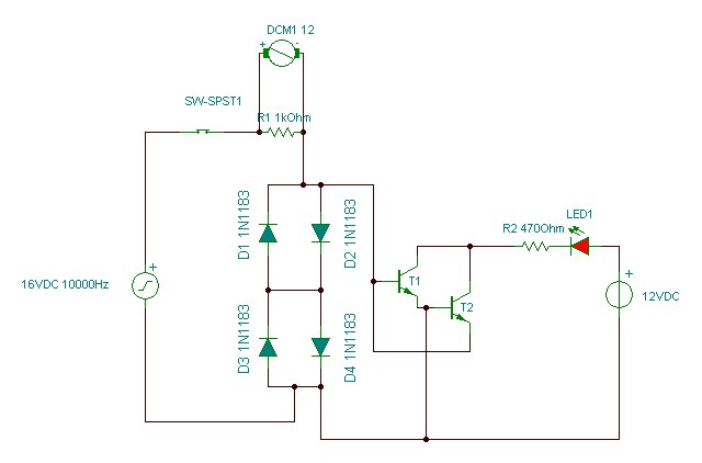

The signal transistors will receive 1.4V on their bases, which will force a lot more than a token current into the base. With one diode drop, the problem is less serious, but it depends heavily on the Vbe and base resistance of the transistor. A base resistor of a few hundred ohms would do no harm and would improve transistor life dramatically.

This is how the circuit should work. Using two back to back diodes the current devides itself in an indeterminate ratio between the a power diode and transistor PN junction. The diode actually drops between 0.6 and 0.8 volts. A silicon signal transistor usually drops a little less than 1 volt at about 5 Ma. So 0.7volts at the base should cause a current of less than 5Ma. That is the theory at least.
Although I know that the rectifier bridge drops 1.4 volts. I dont know why this actually causes no problem. At least I can say that I have not constructed any permanent versions of this circuit and cannot give any definitive "proof of the pudding" so to speak.

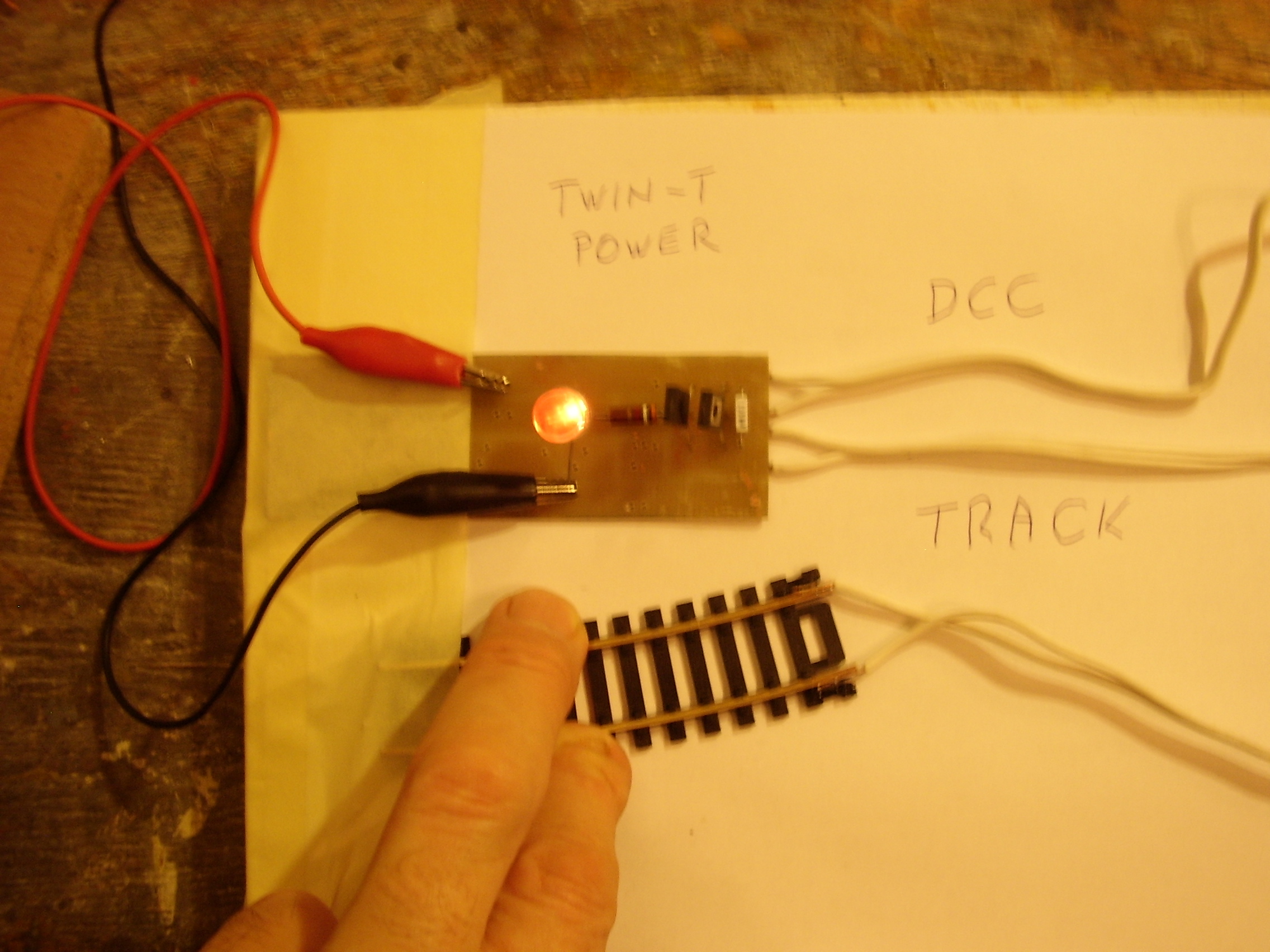

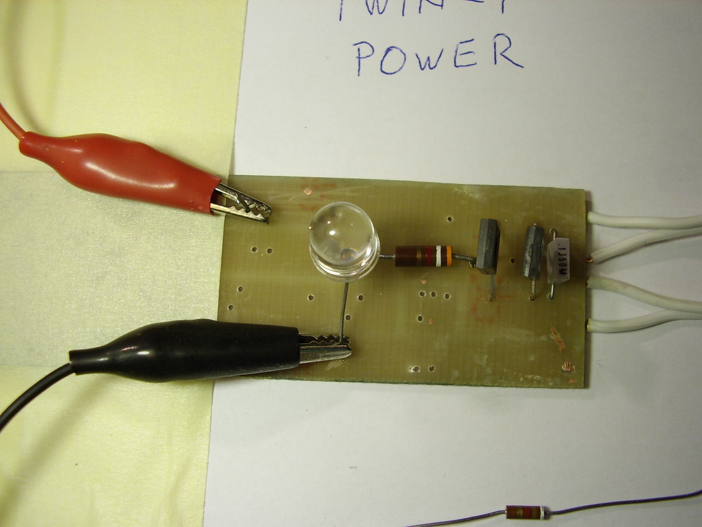

Angie, MrDeb, Mneary,

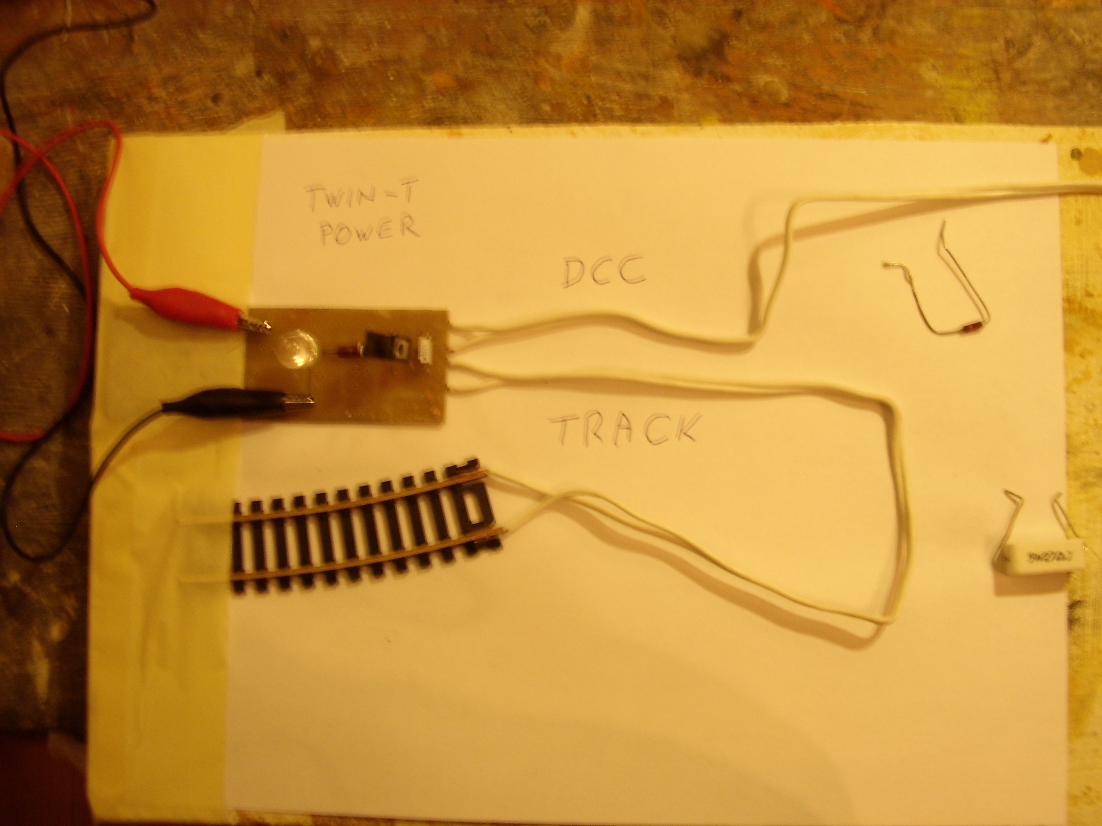

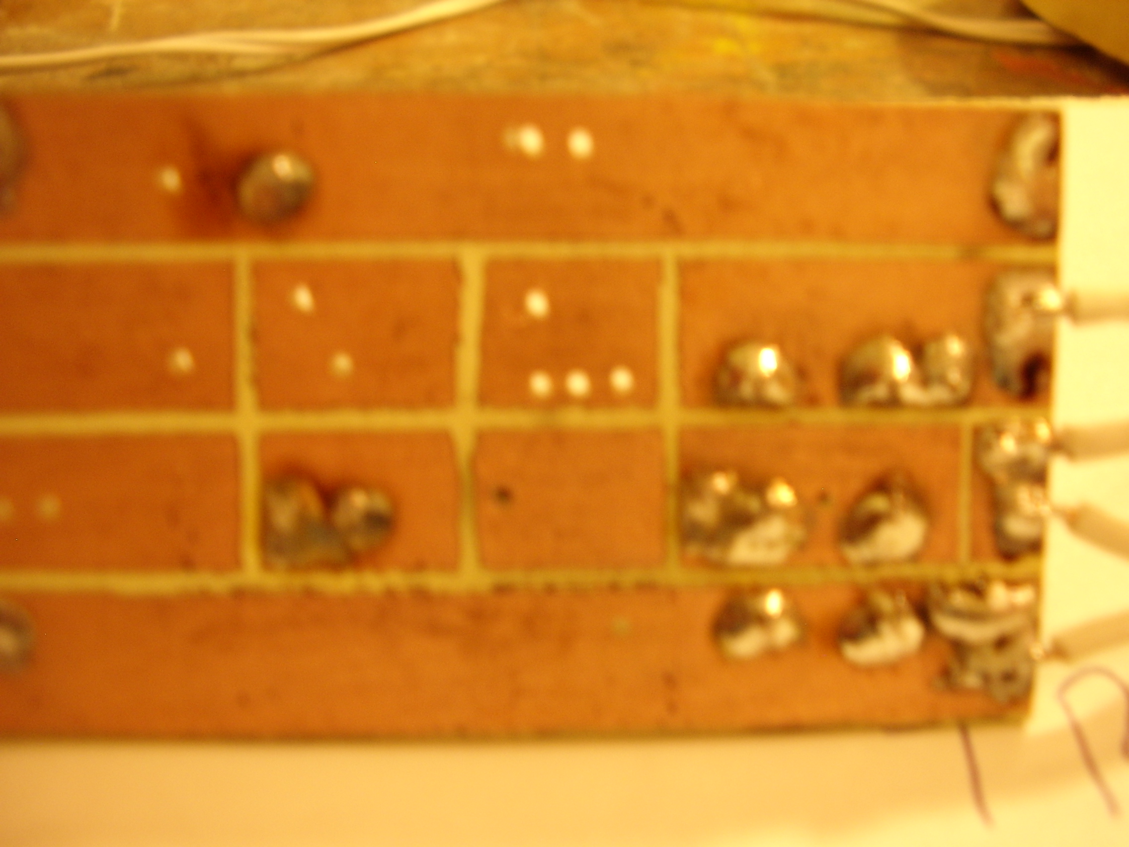

have built a Twin-T using power transistors. Total components is 5.
There is no such thing as a two diode rectifier. There are high current diodes. Take two of them and put them back to back across the Twin-T where the bridge (4 diodes in one capsule) used to be. No jumpers needed.
Check out pictures I've sent
Expect more pictures in next message.
Secon two messages.

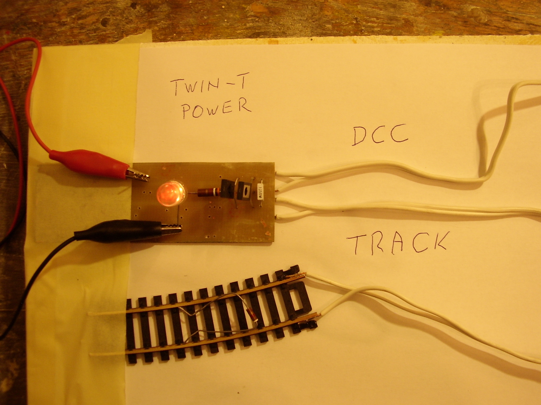

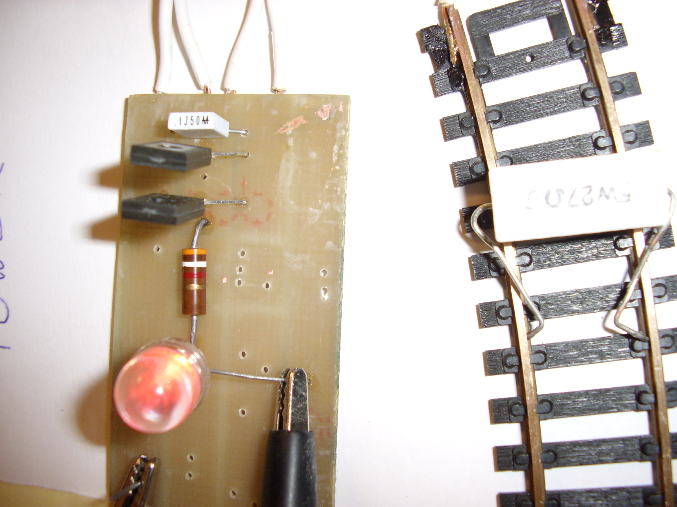

Pictures. The twin T LED lights when there is either 27 ohms or 10K across the track. Even wet fingers will trigger it.

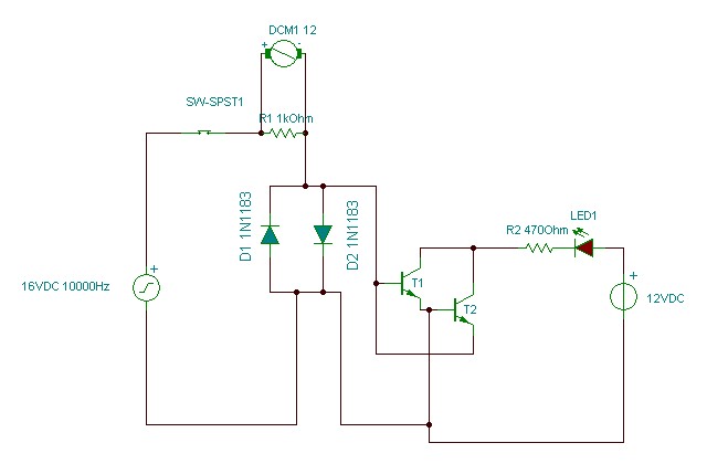

Ok, so this works, yes, On DCC, yes, and this is with one tansistor, yes? (2 diodes, 1 resistor, 1 led and 1 transistor) ??
Angie,
No, the circuit has two power transistors, one capacitor (which you may not need), one resistor and an LED. I used a big one so it would be photogenic:).
Build the circuit (attached) as is and start playing with it. Replace the resistor and LED with your optical isolator and get that working. Once that's working build your signal controller.

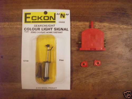

I got 8 of the searchlight.jpg, not US but they'll do for now.
I changed the grain of wheat bulbs to LED's. They're definately bright enough. Not sure how to make my own but have been searching google for ideas. Found one for yard two colour ground signalling, but not the disc type.
The PDMarch.jpg ones look promising if I can work out how to fit 2mm leds to them.

I hope the searchlites were not too expensive. I take it that your layout is 'N' gauge. I also understand that the sigals are "not US and that they will do for now". Does that mean you are modelling an American railroad?
There's quite a few companies that make 'N' signals. ATLAS is one. Nj international is another. Have you checked any of these out.
The searchlight signal looks as if it has a sub base housing that contains the lamps and uses some kind of fiber optics to 'chanel' the light to the signal target. Am I right? For three lamps (LEDs) how many wires are there? (4 or six)
As for the PDMarch kit. I enhanced the photo to get more details. Not much luck. There is a mast, I think, and a ladder. The rest I couldn't make out. I'm surethe UK must have some kind of electronics mail order house. 2mm LEDs are fairly common. I will check with my electronics store here in Slovakia.

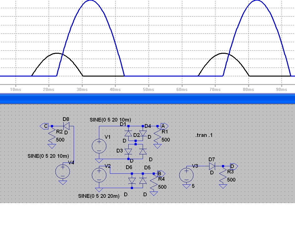

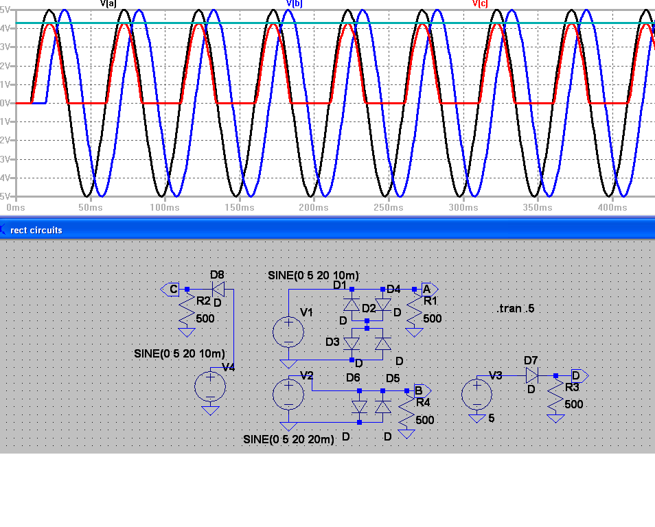

QUESTION?
why are we changing the circuit again, using different transistors, only 2 diodes instead of 4 etc.
Angi is a novice and I sense a bit of frustration when a circuit is modified
keep it simple. Go with the 4 diodes. the output is cleaner IMO
more confussion or more understandable?
here are three different rectifier circuits using AC input of 5v
I included a dc circuit as well.
the A and B outputs are seperate for clarification (offset by 10ms) but exactly the same.
voltage loss almost 1 volt on the C and D circuits.
hope this helps describe what the different rectifier circuits do.
amperage wave forms
using 4 diodes the components draw less (no surprise)
