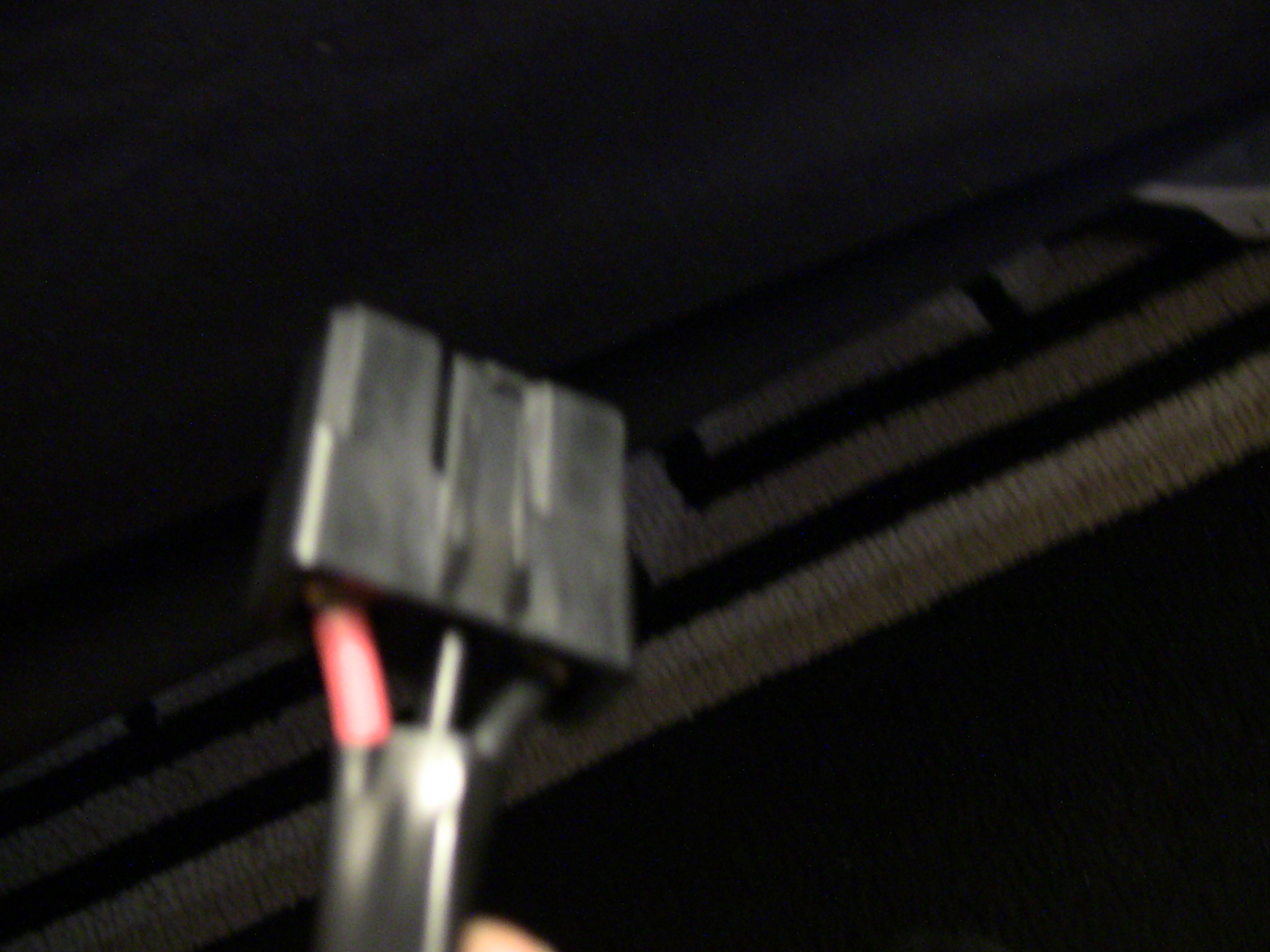

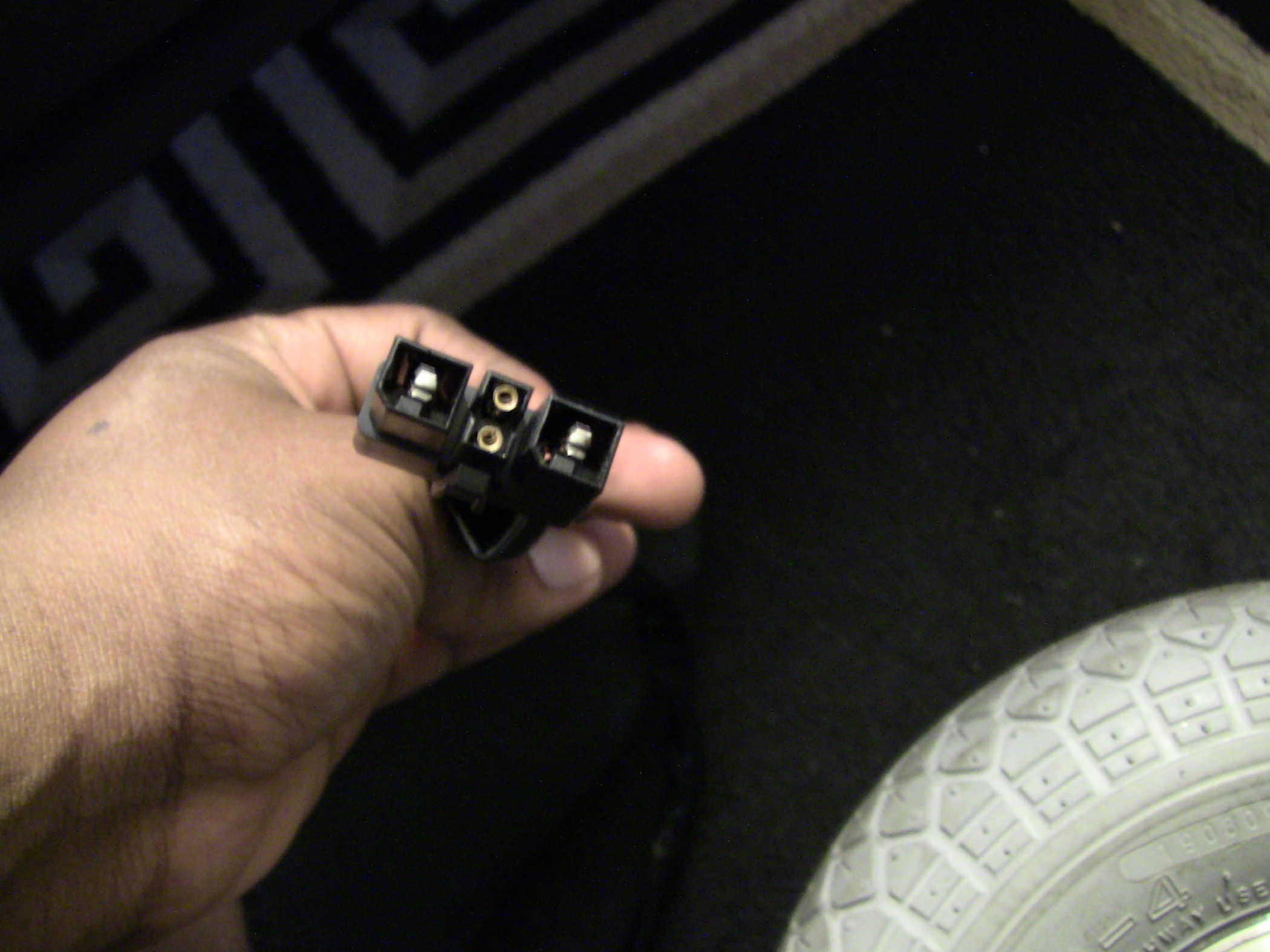

I'm going to upload a picture here in a second as I want to make sure I'm hooking the right power supply wires to the right wires on the motor.
Okay, attached is an image of my female end of the motor connector piece.

It's quite possible the other two wires are a brake - I would expect the brakes to be normally on, and off when power is applied.
Try putting 12v or 24v on the other two wires.

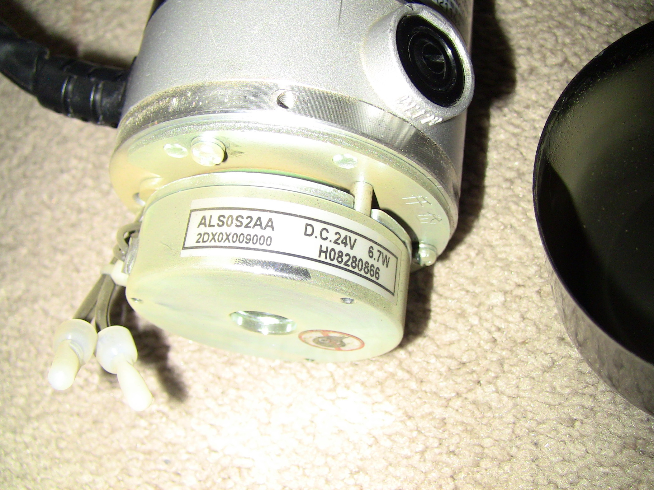

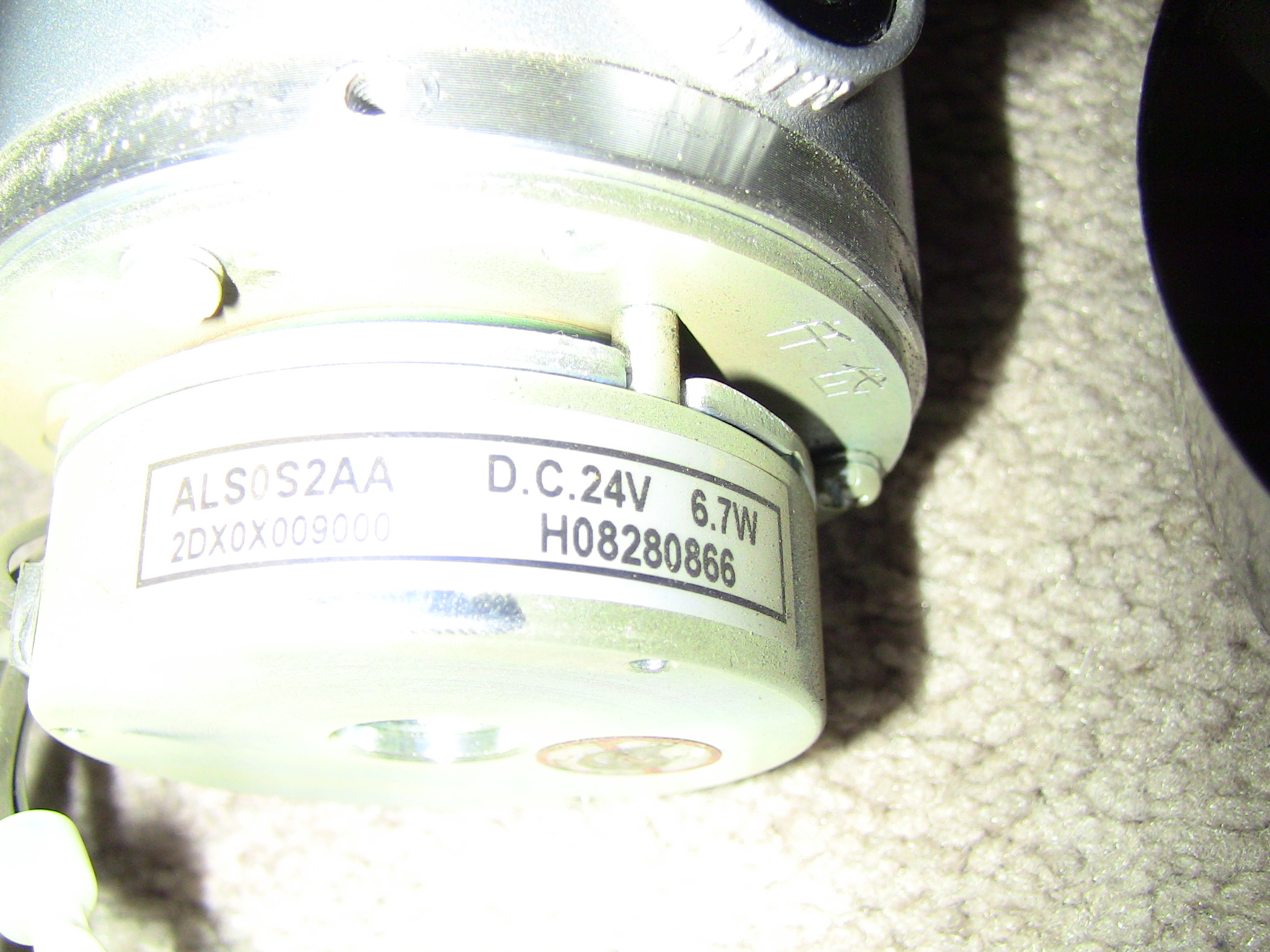

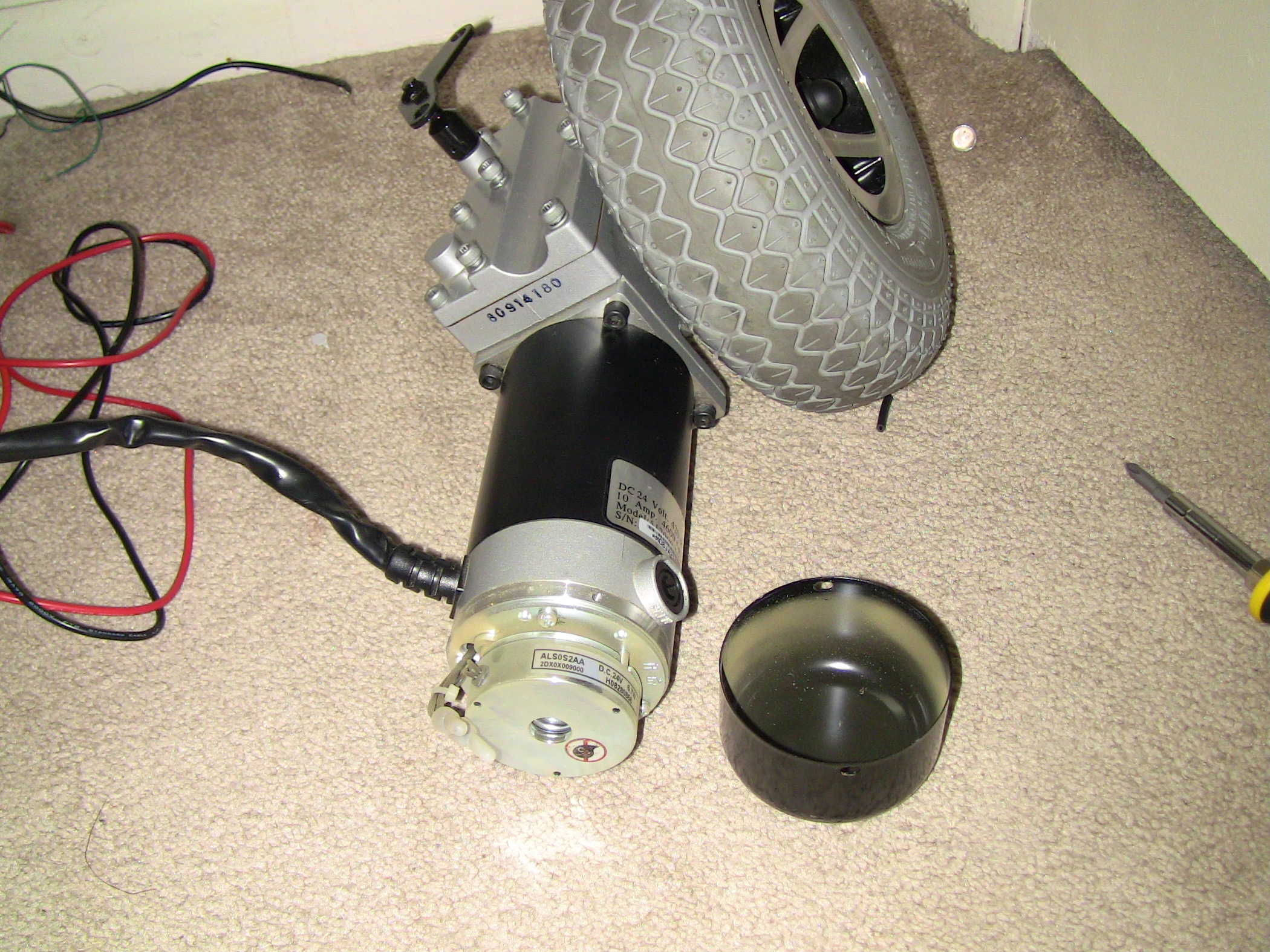

Okay attached are a close up of the cap off the tip of the motor which does appear to have a brake mechinsim under it. I tried hooking up the power to the brake connections, and I did see the silver part move a little, so I'm about 98% sure that piece is as cowana stated the brake part.
I'm now wondering if I just unhook the brown wires there will that disable the entire brake...on this motor... However, remember that in order for the brake to be "released", there has to be 24VDC going to it, so the only way to disable this entire motor from this motor, I "physically" need to take it out..
It also has a "oil" sticker on the front of it, but I'm not sure you can see that from the pictures I took.
