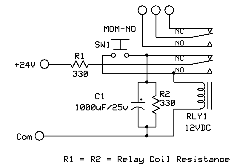

Though a bit klunky (electromechanical), here is a push-on/push-off switching circuit I found some time back. Credit:
He doesn't spell it out, but the relay coil voltage (12V) is 1/2 the supply voltage(24V), and R1, R2, and the coil resistances are all equal. I've used this with a 5V relay on a 12v supply.
Ken
That's clever.

LeeH68,
If you are going to impliment 50 of these, you should look at some version of Hero999's solid state toggle switch. 50 relays are not going to be cheap and is going to draw a lot of current...besides that drawn by the LEDs. For one, or maybe a couple, this is slick, but for a large array logic level flip-flops and transistor drivers would be much better.
Ken

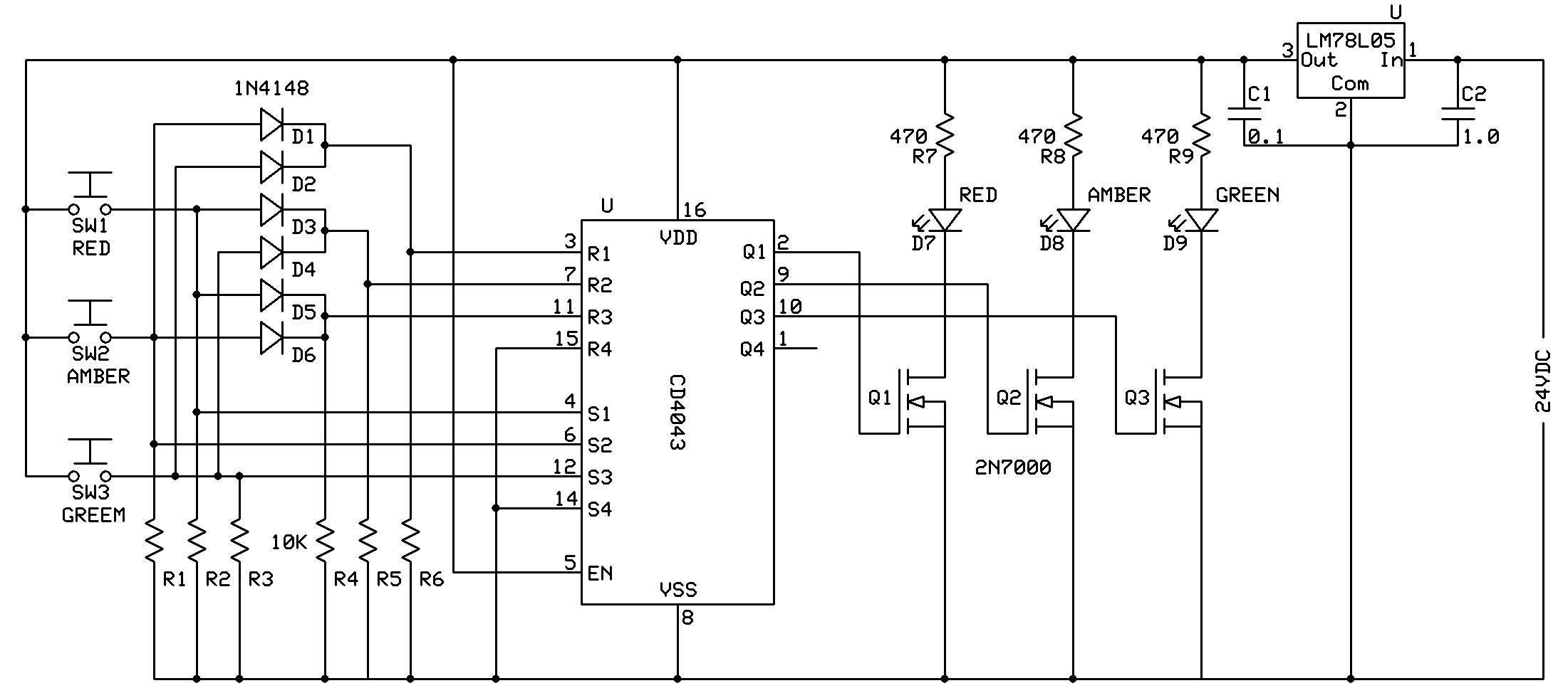

All. I have 14Nr stainless steel plates, in each of these plates there are 3 illuminated switches, one red, one amber and one green. The three leds are a visual indication of the status of the room, green is room clean, amber is room needs cleaning, red is room in operation
So, the ideal situation is that only one illuminated switch can be on at any one time. This would have been a piece of cake if I had ordered latching switches, but being a numpty I ordered momentary switches and had the plates made to suit. I would simply change the switches but I cant find a latching illuminated switch the same size and as you can see from the photo it is a shame to change the flush appearance now.
As no-one seems to make a 24V bi-stable latching relay that works from a single impulse I am struggling to find the solution. To make things worse, I know absolutely bugger all about electronics (but I am learning fast)
It's certainly possible.
No offence intended but it depends on whether you have the materials avaliable and are skilled enough to do it.
LeeH68,
Now I get the picture. Expensive (ouch), lighted, tamper-proof switches, just indicating a status.
3 S-R latches
6 diodes
3 resistors
...and the 78L12 regulator
...and 2 capacitors
I'll add a schematic later.
Ken

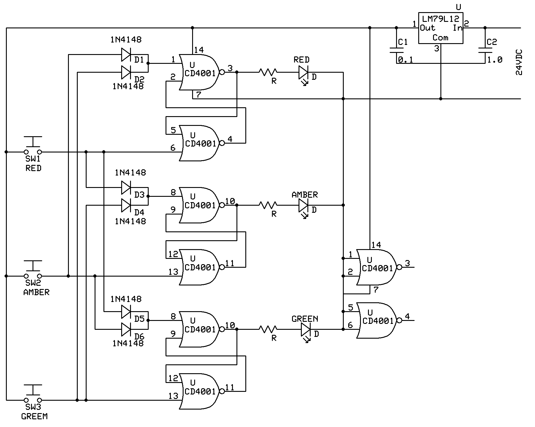

Added!
I'm still not sure about driving the LEDs directly off the gates...I'll have to bench test it...unless someone has some documentation. ;)

KMoffett said:
LeeH68,
3 S-R latches
6 diodes
3 resistors
...and 2 capacitors
Ken
Added!
I'm not sure how much LED drive you can get before you screw up the logic threshold, but it's only a few milliamps. I think you need LED drivers. You do need pulldown resistors on your diode OR gates, and 79L12 is a negative regulator. In your text, you had a 78L12, which is right.
A little too hasty throwing the schematic together. As I said I was uncomfortable with the LED on the outputs, so added some drivers...and the pull down resistors.
So, here is the MARK II. ;)
Ken
