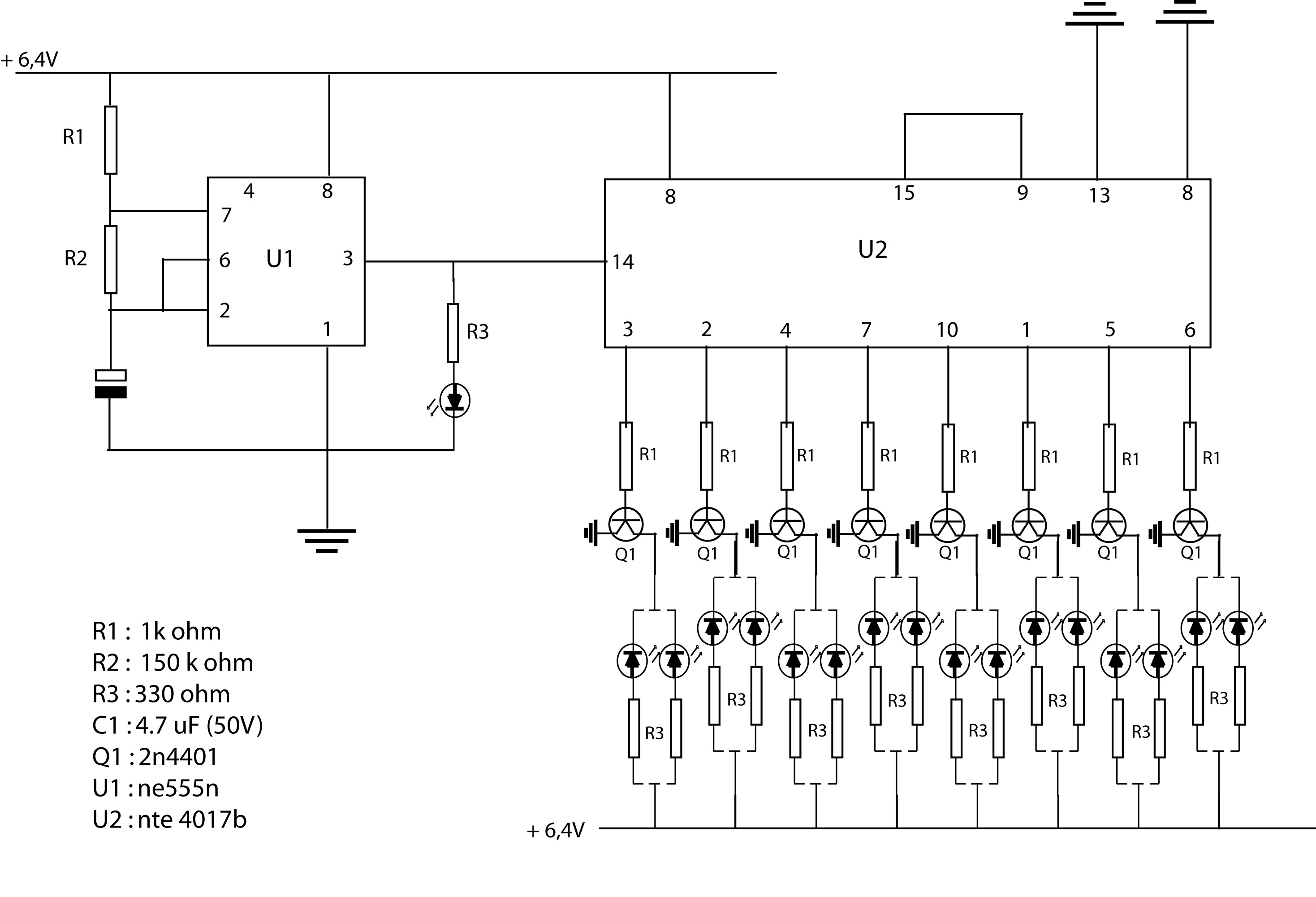

Here, I just made a diagram of what is on my breadboard
I tried to attach it.
Doing this, I realised i haven´t made the connection between pin 4 of the 555 ic and the supply line, and though, it works.:confused:
(the 555 is very forgiving, I must say)
If you are as kind as to look at it and tell me if it´s okay ?

Resistors are not needed from the outputs of the CD4017 to the bases of the power transistors because the output current of the CD4017 is only 5mA when its supply is only 6V.
But the TIP31 power transistors need a base current of 25mA to 50mA to properly turn on 500mA light bulbs. TIP120 power darlington transistors or logic-level Mosfets would work. The darlington will cause a voltage loss to the light bulb of from 0.75V to 1.2V. The darlingtons also do not need resistors from the outputs of the CD4017 to their bases.
The CD4017 turns on only 1 output at a time. So the average current is a little more than 500mA and your 1A wall-wart will be warm but not hot.

I used the light bulbs as a test but the final project is made only of leds
and I´m thinking of the tip31 for the alternate flasher out of the 555ic: I read somewhere that this ic has an untypical output of 200mA, so do you think the tip31 might work?
it is more powerful than a 2n4401, right?
Also, it is intended to light up 85 leds, which sum up more than 1000 mA. I never considered that angle doing my project, because as I said, when I tested the soldering work of the 85 leds with the wall-wart, it worked just fine for me.
Between the 4017 outputs and the 2n4401 transistors I can then omit the resistors ? Don´t I have to put even a 1ohm resistor to be on the safe side ?
Also, I keep on being puzzled by the fact that the led representing the 85 leds (out of the 555ic) on my breadboard flashes with every sequential flash out of the 4017, and I thought it would flash once for every cycle as I thought the 4017 was a divider. I got the idea the current went to the 4017 to flash the sequence, and then to the other led connected to the 555 if there is one, as it happens in the case of an alternate 555ic flasher.
Anybody can explain that to me?
Thank you
The output current of the CD4017 is only about 5mA when the supply is only 6V.
The current is so low that a series resistor is not needed to drive anything.
But the TIP31 transistor needs a base current of 50mA to 100mA to properly turn on a 1000mA load.
Didn't you read where I said that TIP120 darlington transistors will work instead of TIP31 transistors?
The output of the 555 can supply up to 200mA. Then a current-limiting resistor can be between the outrput of the 555 and the base of a TIP120 darlington transistor because if the 555 drives the base of a TIP31 transistor with 100mA then the output high voltage of the 555 might not be high enough to clock the CD4017.
Each time the output of the 555 goes high then the CD4017 sequences to its next output.
I think your total load current will be more than the current from your wall-wart supply.
