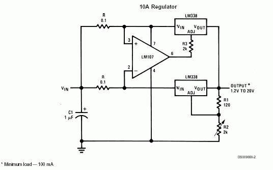

Hiya Guy's,
Rather than just go buy a stepdown regulator I reckon the circuit below will fit my needs. Now I'll be using a 24 volt solar powered battery bank rated at 400 amp/hours and what I want to do is have a variable regulated voltage of no-more than 15 volts so I can power the 12 volt nominal lights in my shed. The specs for these cfc fluro's is a max input of 15 volts. The reason I'm going for a 10 amp regulator is when all 8 light are on I'm pulling around 8 amps on average. Now say if I set the output to 12 volts when the batteries are sitting on 24.5 volts when the batteries are topped up the supply won't be over 15 volts. Now as far as the circuit saying 100mA continious I'll put a small 12 volt fan on the back of the heatsink. I'm open for suggestions on this project and any comments will be appreciated.
Cheers Bryan :D

The posted circuit will waste quite alot of energy. A switching regulator would be much more efficient.
The SwitcherCADIII circuit analysis software (available for nothing from the LInear Technology web site) includes many switching regulator examples.
You could also search this forum and the net.
Len

There are switching regs which aren't in SMD pkgs. You will need a well-selected inductor and MOSFET which is tricky but necessary.
You have to have a switcher- otherwise you're talking 100w nominal dissipation which is unrealistic as well as a killer for your solar system capacity. It would take a bank of a bunch of transistors in an external output stage to handle all that heat.
Regulators cannot be paralleled as in your schematic. And the regulator itself can only dissipate a few watts even with a good heatsink and fan.
There are some off-the-shelf 24V-to-12V inverters. They're not all that expensive.

Oh and Oznog that schematic I posted before came straight of the LM338 datasheet.

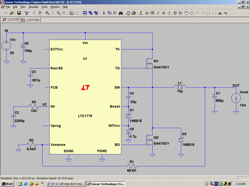

SMD can be done just as well with a heat gun (used carefully), or a butane Weller soldering iron with the "heat blower" (not the torch) attachment.
Some people have said that just adjusting the temp on the toaster oven manually while holding a stopwatch works well too, it just keeps you watching it.
And simple SMDs like a SOIC-8 are easy to do with a soldering iron. Some use a fine point iron, others use a wide, blunt point and drag the solder ball across the pins. Some people got good at doing even fine pitch ones by hand with the blunt point too.
The trick with the buck converter is going to be finding the right inductor. For starters, saturation current must be a healthy margin above 8 amps. The resistance of the copper wire should not create excessive heat, a hot inductor has a substantially reduced saturation current as well as inductance. And the inductor needs to have enough inductance to satisfy your ripple limits at the freq you've chosen at the max current you will be drawing.
Feel free to check back with us with questions of inductor and transistor selection.
Hiya Guys,
Here's the schematic from switchercad that I was talking about, Oznog do you think you can help me out on the inductor as it doesn't say anything about it's rating. But as you can see it looks a pretty simple circuit so I shouldn't have too much trouble making up a circuit board, I've got both single and double sided board with that press and peel iron on paper for the etching, this will also be new to me as I've only used veroboard in the past. I've requested 4 samples(LTC1775) just to be on the safe side. The next part is finding where I can get the mosfet's I'll look in my farnell cat tonite.

Bryan,
I have 2 questions
1. You said in the previous post "I've got both single and double sided board with that press and peel iron on paper for the etching"
Where do you buy the iron on paper?
2. How did you convert the SwitcherCAD screen to a .gif?
Len

Hi Len,
1. The press'n'Peel pcb film is available from Jaycar(item no. HG-9980) and the price listed is $34.95, Altronics have it aswell at $31.50 (item no. H-0770). Off memory I paid about $25 for mine but it was a couple of years ago.
2. To convert the Switchercad screen I simply hit the print screen button then pasted it in ifranview, resized it for the forum and saved it as a .gif file. If you don't have ifranview I recommend you get it as it's the best freeware image editor available. I even use the program for all my scanning needs too.
Cheers Bryan :D

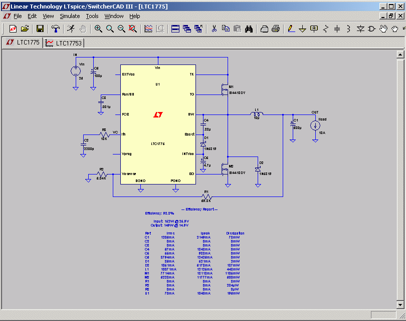

Hiya Again Guys,
Well trying the simulation a few times I kept getting a question mark on the sckotty diodes so I changed them from a 1n5818 to a 1n5819 and this seemed to solve the problem. In the lastest picture below I've included the efficiency report from the simulation looking at the inductor the report states L1 (IRMs) 10071mA (Ipeak) 12125mA (Dissapation) 443mW. Now looking in the farnell catalogue I can't find anything that even comes close to those specs so I will need some help on this inductor. The mosfet( SI4410DY) is a surfacemount component and I wonder if their would be a standard to-220 equavilient. Anyway I'm slowly getting my way the circuit it's just these few niggling problems to sort out.
Cheers Bryan :D
Edit: silly me didn't right click on the inductor and when I did I got a part no for it and within 5 minutes I arranged a few samples :D But as far as the mosfets went for samples fairchild won't send samples to Oz and I'll get stung about $13.00 each on a minimum order of 10 :(
