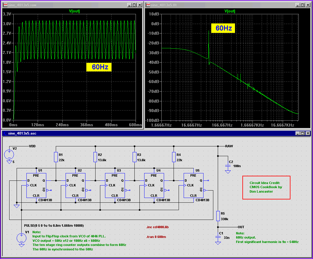

One method is to generate a frequency 10 or 12 times the input using PLL technique and then form an AC waveform directly from this via a ring counter.
The ring counter circuit(shown in image) accepts ten times the input frequency and build a waveform with 1/10 of its input frequency.
The following image shows how a 60Hz output signal is being generated from a 600Hz which I obtained via a full wave rectified AC 50Hz waveform and then X 6 using a PLL.
60hz_gen-gif.33268

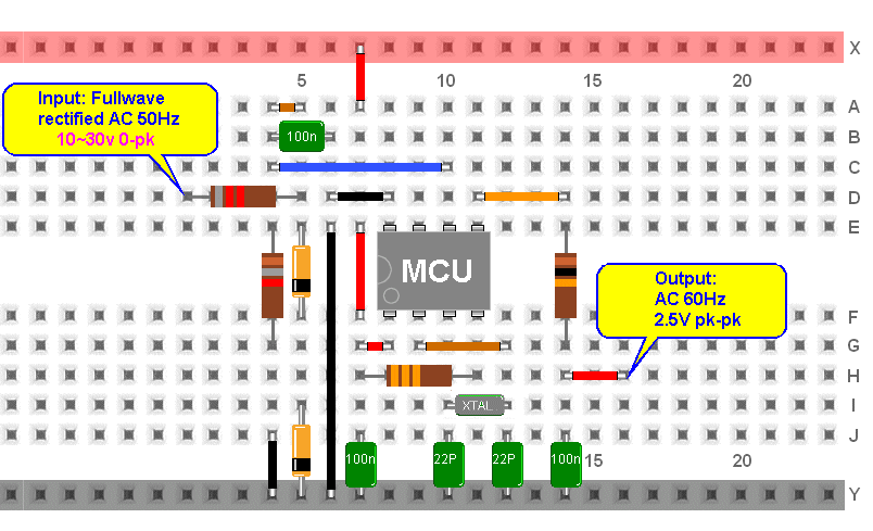

Another method involves using a PIC to generate the required output using PWM and frequency lock the output to the input frequency such that the number of cycles fulfill the frequency ratio of 50/60Hz. All the hard work is done via coding and the output is a nice clean frequency. However, your PWM coding must be able to output a frequency range between 57~63Hz and with frequency resolution of 0.02Hz or better, e.g. 60.00Hz for 50.00Hz and 59.98Hz output for a 49.99Hz input.
50_60hz_bboard-gif.33269
