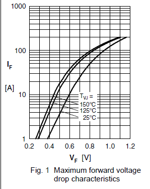

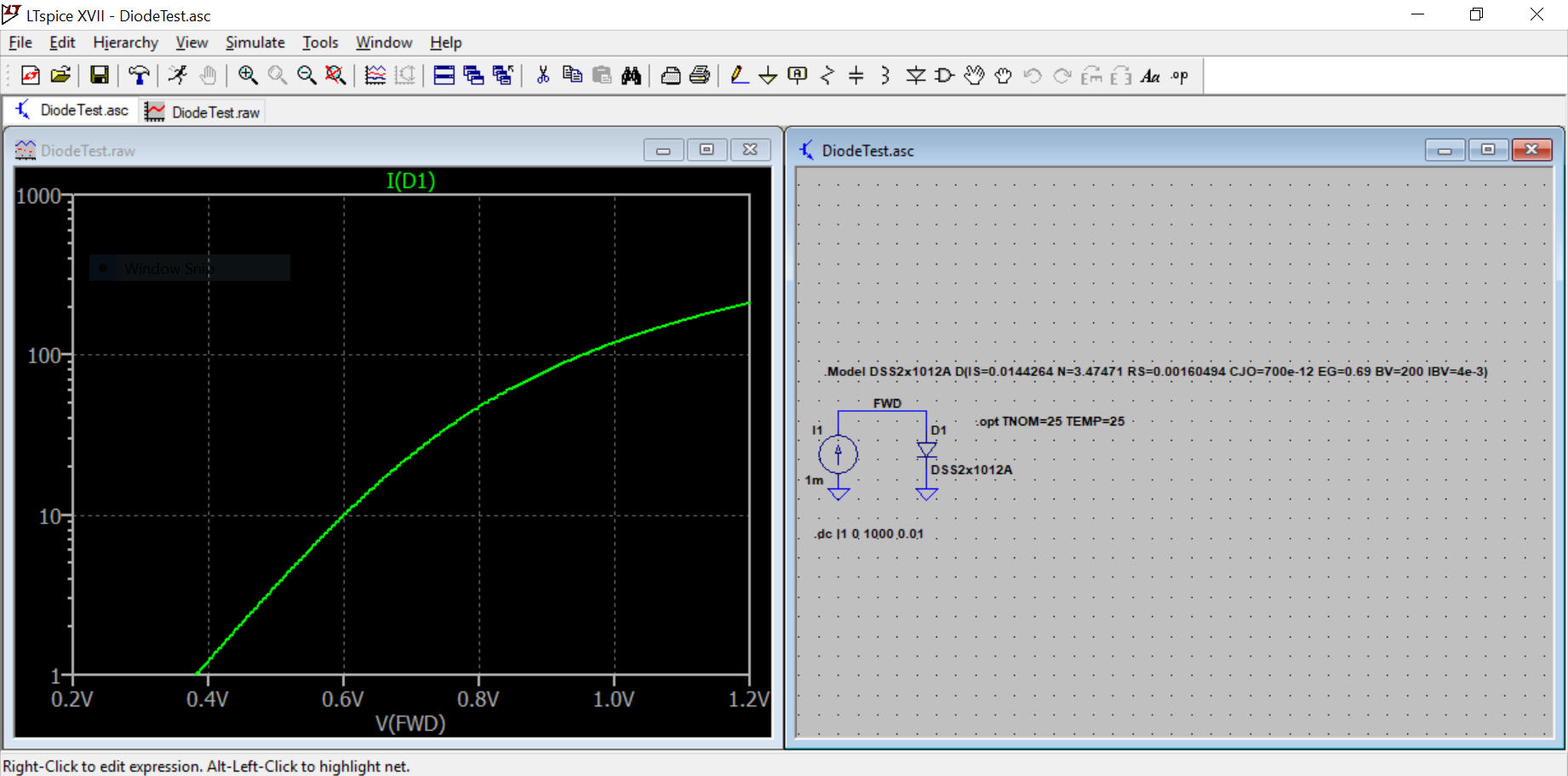

Hi
You can try this one.
* INXY DSS2x1012A High Performance Schottky Diode, Dual Leg, 200V, 100A
.Model DSS2x1012A D(IS=0.0144264 N=3.47471 RS=0.00160494 CJO=700e-12 EG=0.69 BV=200 IBV=4e-3)
