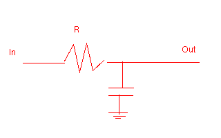

Here's what an RC filter looks like. It's a low-pass filter, it smoothes things out. Try 1K and 1uF maybye?

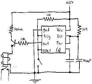

There were some problems.
1) It was being triggered constantly, it never had a chance to shut off.
2) The 555 was able to drive the relay by itself, but when it was sourcing that much current it would never shut off.
3) 10M resistors are really hard to come by.
So I tied trig and reset together; that way it's forced to shut off. When the switch closes, it doesn't get triggered, but when the switch opens again, it triggers once and ONLY once(until next time the switch closes). Reset doesn't let it charge while trigger's being held high. This also has the nice side-effect of not caring much about switch noise.
The transistor is just an ordinary 2n2222 or something, out of one of radioshack's grab-bags of small NPN transistors. Practically any small NPN transistor should work.
I used a 1M resistor and a 10uF capacitor, and it seemed to provide around a 10-15 second delay. You might want to play around with the capacitance to get exactly what you want.
So here's the circuit that I tested and seems to work:
Wow, that looks good to me! Thanks a lot for your help. All of you, but mostly you, monttyle. :wink: :) IRQ57, thanks a ton. You saved me some $$. I was pretty sure that's basically what I had to do, but thanks for re-assuring me on that. :) As for the rest of you, I thank you as well. Wish me luck guys, and I hope I haven't been too much of a pain. :p Thanks again guys!!! :D
