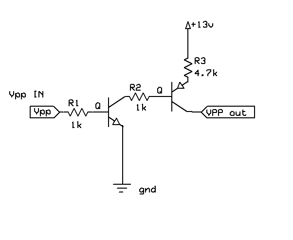

The problems with the JDM is that the Vpp voltage depends upon the PC or Laptops RS232 voltage levels, these levels are sometimes too low to program the PIC correctly.
And how to solve it? restart PC? can't somehow I increace it? and why has it decreaced? I don't understand
It needs a good power supply to provide +5V and the +13V.

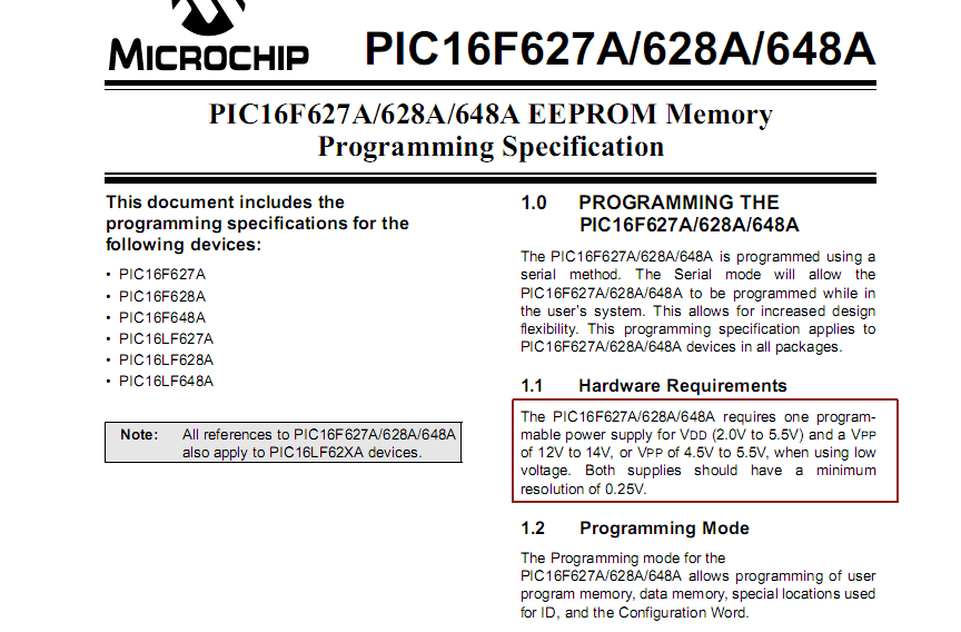

You should try to ERASE [blank] the flash memory in the PIC, then try to program it with your program code.
If you have a voltmeter measure the Vpgm voltage on the /MCLR pin of the PIC while programming the PIC, tell me what you measure.
It was 11.06 volts and it programmed succesfully! but sometimes It did, when it stucks again, I will check the voltage and post again
If its typically 11V its not high enough, check the datasheet for the recommended Vpp on /MCLR.
Being approx 11V its going to give unpredictable programming of the PIC.
Like I said yesterday, the JDM has a poor reputation, mainly because of the use of the RS232 port pins to supply +13Vpp.
EDIT:
Added programming specification.

Did you make your jdm yourself ? you can boost Vpp with a wall power supply and two transistors like this
