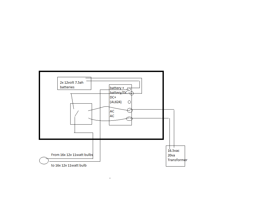

@reloadron- yes, in the event of power failure this unit is to light 16 12v 11watt bulbs on the exterior of the building. I was thinking to have the relay complete the neg side of the circuit with the loss of AC (it was a suggestion from a alarm shop owner).
I have:
2 12v 7.5Ah batteries
1 al624 (which i am using as the battery charger)
1 16.5vac 20va plug in transformer (according to the directions for the AL624)
I am looking to have the system automatically power the lights with the loss of AC. I believe a relay is the best way to do this (i may be wrong)
I hope the drawing help...
I am currently in Provo, Utah.
I just learned my brother, whom asked me to help him with this already used this forum to ask about the same system.
sorry the picture is small
thank you for putting up with my ignorance.

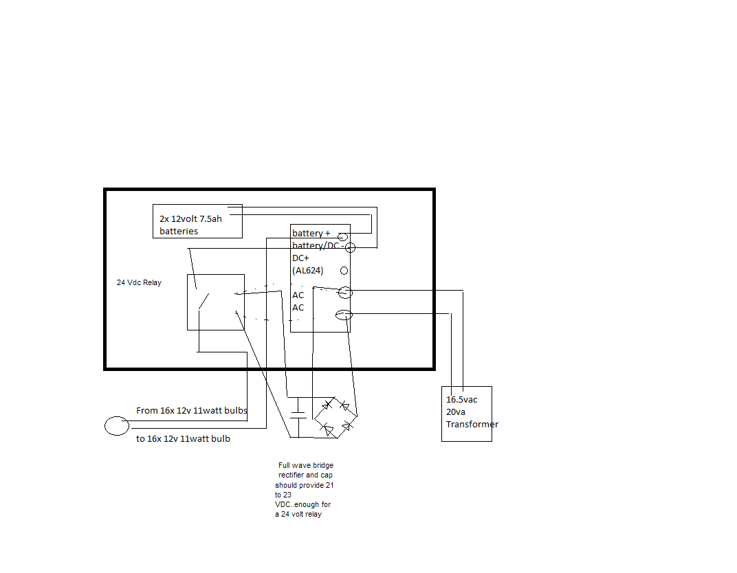

Maybe you could try this.
24 volt dc relays are common in industrial controls
OK, now I have the picture and think I remember your brother's post. You will have a few problems and here is why.
First, you have an Alltronix AL624 power supply. I have several similar units. They are designed to provide an uninterupted supply of either 6, 12 or 24 volts DC (6 & 12 volts at 1.2 amp and 24 volts DC at 0.75 amp). They also as you noted act as a battery charger to maintain the batteries. The unit you have should resemble the attached image. The AL624 requires low voltage AC to work and in this case you have a transformer delivering about 16.5 volts AC rated at 20 VA (Volt Amps). That works out to be about 1.2 amps of current.
Here is the beginning of the problem. Your outside lights are 16 each, 12 volt 11 watt lamps. That tells us 11 watts times 16 bulbs for a total of about 176 watts. Now at 12 volts that also tells us 176 watts / 12 volts = about 15 amps. Therefore under normal operation your lamps draw 15 amps of 12 volt current. That is a pretty good chunk of current.
This also tells us that under normal operation those lamps are powered from a source other than what we have covered thus far. That power is coming from somewhere? Got any ideas or thoughts as to where it comes from?
On a good day, your pair of 12 volt batteries in parallel with a full charge would be hard pressed to maintain the outside lights for maybe 30 min to an hour. I doubt you would see an hour. Now if that is acceptable, then we can go from there.
If you look close at the AC inputs to the 624 card those inputs likely go to a full wave bridge. AC In / DC Out on the bridge. The bridge output likely is across the single large cap that should be marked + / -. We can likely get some of that DC to operate a relay. When AC is present the relay will be energized and when mains power AC fails the relay will drop out. We can use a good beefy (and inexpensive) automotive relay which should be fine with voltages up to 14.5 volts or a little more. With this known relay we can then shove a resistor in series with the coil just to drop our coil voltage a little. Take a look at the 624 card and let me know if this makes sense.
Ron
