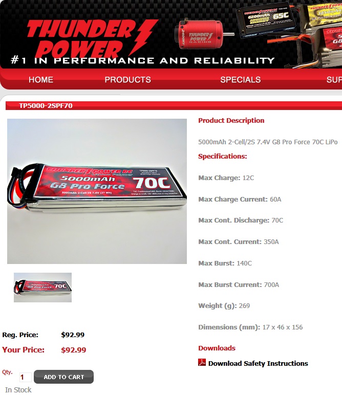

The very small and lightweight Li-Po batteries that make my radio controlled model airplanes go like a rocket are very powerful:

The battery Uncle Scrooge posted can supply 700 amps peak, so blowning an 800 amp fuse isn't that impressive.
