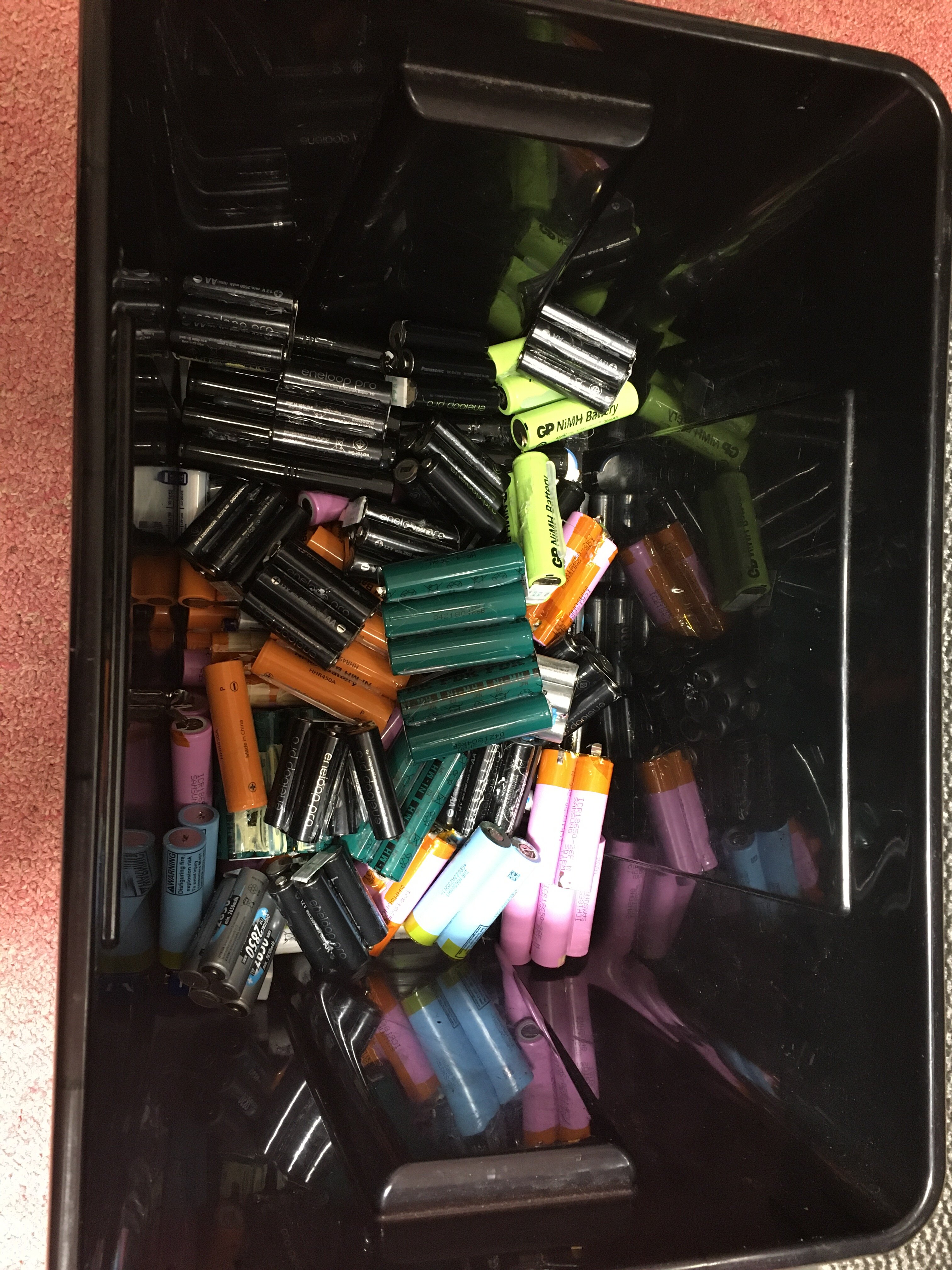

We replace a LOTof batteries in commercial equipment, and quite often the units don't work after replacing the batteries, and this is due to the BMS shutting off because the batteries were too low. The answer is to 'pulse' them with a 9V PP3 battery, this brings the BMS back to life
Here's our battery 'bin' with a couple of weeks worth.
You might want to be careful with that bin! It's possible batteries dumped in there could short together and..... well you know what could happen.
