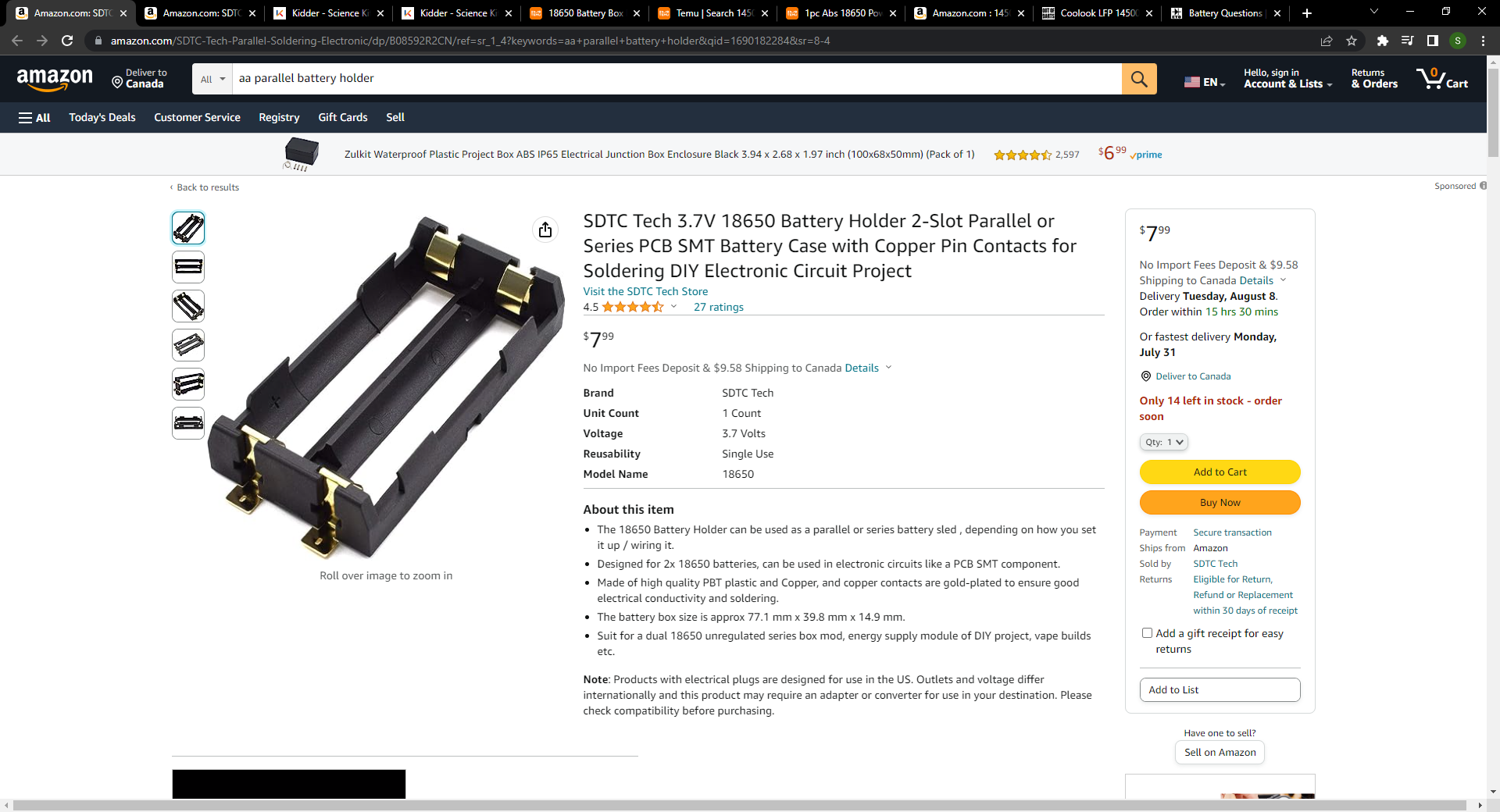

Do you know where I can find AA (14500) sized battery trays wired in parallel that have two battery slots? I've only been able to find 18650 sized trays (attached image).

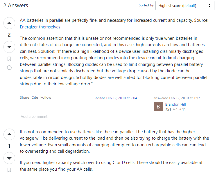

Both answers are confusing.
How does the battery charge itself in a parallel circuit? That doesn't make any sense. I'm also using rechargeable batteries and need to increase the current output, not the total capacity.
My circuit as is follows:
Batteries ---> Switch ---> Two Motors (Parallel) ---> Fuse ---> Back to Batteries
The fuse is in place to prevent frying the motors/batteries when the motors stall (blaster jams) and they draw their stall current, which is significantly higher than what the batteries can handle.
The two answers seem to be deliberately confusing?.
The more charged of the two batteries passes charge to the flatter one, until they are balanced - and as there's no current limiting high currents 'could' flow.
It's quite simple - they are perfectly safe to use in parallel, IF you do it properly - it's quite simple, use brand new batteries of identical type. You should never mix different types or makes of batteries, or old ones and new ones, either in parallel or in series.
Li-Ion batteries are supplied in a partially charged state, this is their optimal storage condition - and all should be pretty well identically charged. Often chargers for individual LI-Ion cells (often will accept 4 to 8 cells) can be set to charge/discharge cells to their storage settings, you could use that to balance identical cells that have been used individually - or you could charge them fully individually.

For cell holders, search "Individual AA cell holders" and "Modular AA cell holders" - there are several makers who produce individual cell or clip-together holders; eg. this type of thing:

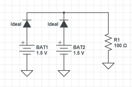

The ideal diode was for this :
Post #9
This prevents one cell that is higher V from charging into the other cell,
wasting precious energy, because of unnecessary charge path Pdiss in
internal battery resistance.
Also aids in sharing in that the cell with higher V will start by suppling load
until it discharges to the V of the weaker cell, then they both supply
current until exhausted or system turned off.
Ideal, or as near as ideal, type diode solution supplied because "normal" diodes
have way too much V drop, so battery effectiveness is compromised.
Regards, Dana.

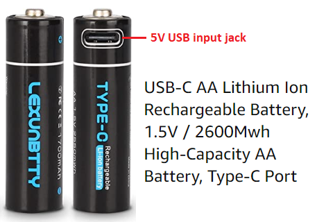

Are you looking at the online No-Name-Brand AA size batteries that have a USB charge jack in them?
They are low current and low capacity (their specs are lies) junk.
No, he's not - if you read the thread he's using 14500's, a lower capacity AA sized version of an 18650 - which obviously MUST not be used in place of an AA as they are 4.2V and not 1.5V. I have some LED torches that use them - which at the time was a problem, because I expected them to take 18650's, so had to order some 14500's just for the torches.

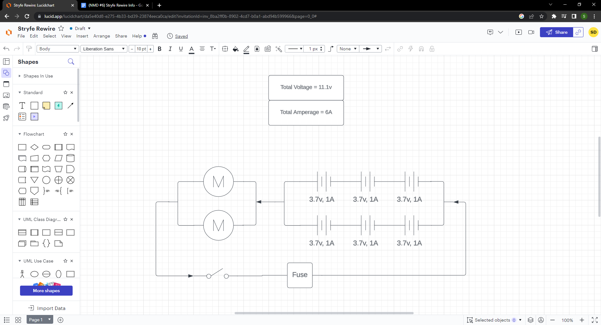

I need some clarification here. Is the total voltage and amperage listed correct? If it isn't, where did I go wrong?
Also, can you help me find a good and free circuit diagram build/simulator?
Series cell connections increase voltage, but the amperage stays the same.
Parallel connections increase current, but the voltage stays the same.
You have two, three cell 1A chains in parallel, so three cells at 2x current; 2A
The voltage would be just over 12V initially with fully charged cells, gradually reducing to roughly 10.5V by the time the battery was fully discharged.
(Basing the voltage on normal lithium cells).
Thank you very much for the clarification!
