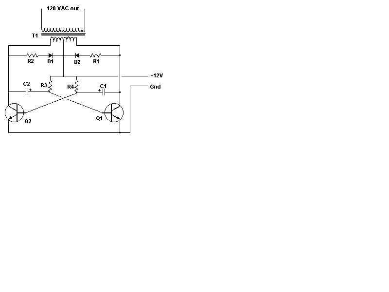

Hi All,
I am looking forward for this project and before starting this project and building circuit what test shell i go for and will this be a good project to choose for my 5th semester end electronic projects any new or cutting edge electronic project for suggestion which will be very benificial to choose.......
waiting for you kind suggestions
What frequency do you want, because the circuit you provided is about 50kHz .
How did you determine this? No component values are given.
Read the 250 comments about the circuit. No-one has actually made the circuit and found that it works.
The output voltage drops when a load is applied and the capacitors blow up either instantly or within 2 hours.
A circuit like this generally operates at 20kHz to 50kHz to get enough energy from the circuit to drive the transistors into full conduction.

The circuit I showed you is very primative, but it works. You will have to get your own 100VA transformer.
any alternate project that can be implemented and any new cutting edge electronic project
The first posted inverter project is extremely old. Its capacitors have backwards polarity so I think the circuit originally used PNP germanium transistors 40 years ago.
The silicon transistors have avalanche-breakdown of their reverse-biased emitter-base junctions that wastes a lot of power blowing up the capacitors.
The base current for the transistors is way too low for an inverter.
The existing very long topic about it at aaroncake.net is the second topic about that horrible circuit. The first topic also has tales of many people trying to make it work.
It is too simple to work and it is too simple for a school project.
