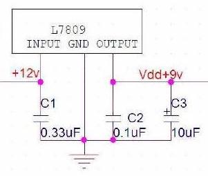

I have a +12v@1.5a wall adapter plug that i'd like to use in conjunction with a L7809 regulator to use with home grown projects. Im not sure what kind of filtering circuit that is required, so will the circuit in the included picture do or is there more involved? thanks

Put a much larger cap on the input. Something like 100uF at least.

Do you know for a fact that the wall-wart has a filter capacitor in it? Most do not. All they have is a transformer and a full-wave rectifier. If so, then the input cap to the 7809 will have to be huge, on the order of 2000uF.
At 1A load, the sag during 8.333ms for a 2000uF cap is 4V, which is about as much as the 7809 drop out voltage could tolerate.

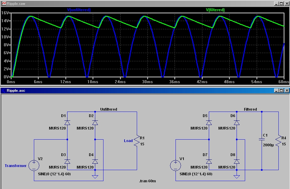

If there is no capacitor in it, the AC ripple across the resistor will be almost as big as the DC component.
When you say "ripple", you mean the voltage will fluctuate more without a capacitor present and it'll be more stable with a capacitor present under load?
Compare these two cases.

The "Ripple" is a left over AC component, the filter capacitor makes the signal more DC, as you increase the load the ripple increases and as you increase the filter capacitor the ripple decreases

Ps- If i find it has no capacitor or just want better filtering, what would be the recomended value(s) to use for the entire circuit shown.
A 4700 µF, 25 V capacitor would be a good start. A bigger voltage or capacitance would improve reliability or ripple.

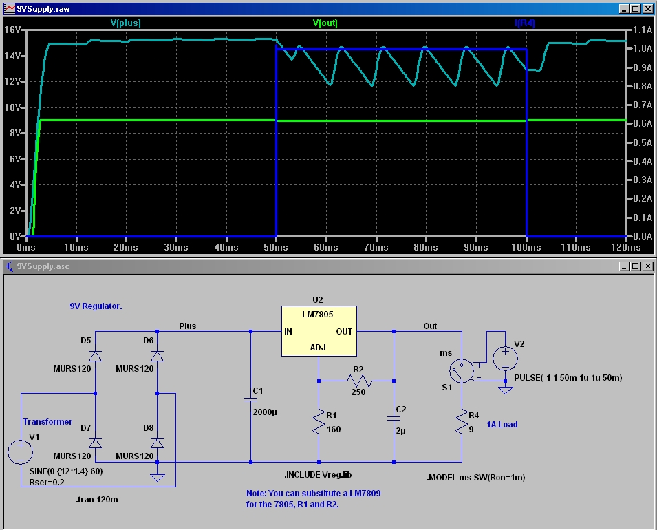

Place to start. Note the increase in ripple across the 2000uF capacitor when the load is turn on. I used an 7805 because I didn't have a Spice model for a 7809.

Most wallwarts do have a built-in capacitor, although it's normally undersized for most applications so assume it doesn't exist as you don't know its capacitance. For an output current of 1A and a 9V regulator, you'll need a 2,200:mu:F capacitor.
