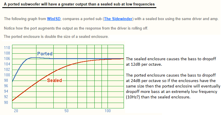

The cabin of a car focusses the bass towards you up front so the bass is much stronger than speakers that are outdoors that radiate the bass all around.
The website of https://www.subwoofer-builder.com/vents.htm shows that a ported enclosure produces more bass than a sealed enclosure (when its enclosure is larger) and also lists the small delay that a ported enclosure has.
yes... i've been very aware of the efficiency benefit of ported speakers since the mid 80s when i learned why i preferred small sealed minis to ported towers and the pros and cons of each alignment. the bottom line is i DESPISE the distorted "marshmallow bass" sound of ports and will never go that route, unless there's foam plugs included. (some day, i'd like a pair of KEF LS50s... ports plugged)

A properly designed ported speaker has very low distortion and a flat frequency response to prevent a sloppy boomy sound. A boom box with a cheap high-Q woofer is not properly designed and produces one note bass (its resonance).

i just don't like ported speakers. period. they create MULTIPLE forms of distortion that can only be minimized but never eliminated, and the very RESONANT bass boost they give IS a form of distortion adding harmonics that don't exist in a recording, and i don't like that.

the ONLY form of "distortion" from acoustic suspension is reduced output in the lowest octaves. that's 1000 times better than ACTUAL distortions, and i don't see why nearly EVERYONE accepts bass reflex distortions, even, idiotically claiming they don't even exist sometimes eg. "ported boxes actually have MORE control over the cone". :banghead: :banghead: :banghead: :banghead: :banghead: :banghead: :banghead:
the bottom line is ported woofers muddy the bass and it's NOT open to debate. it's a well established scientific FACT even if i don't have the waterfall plots i know would prove the point visually.
