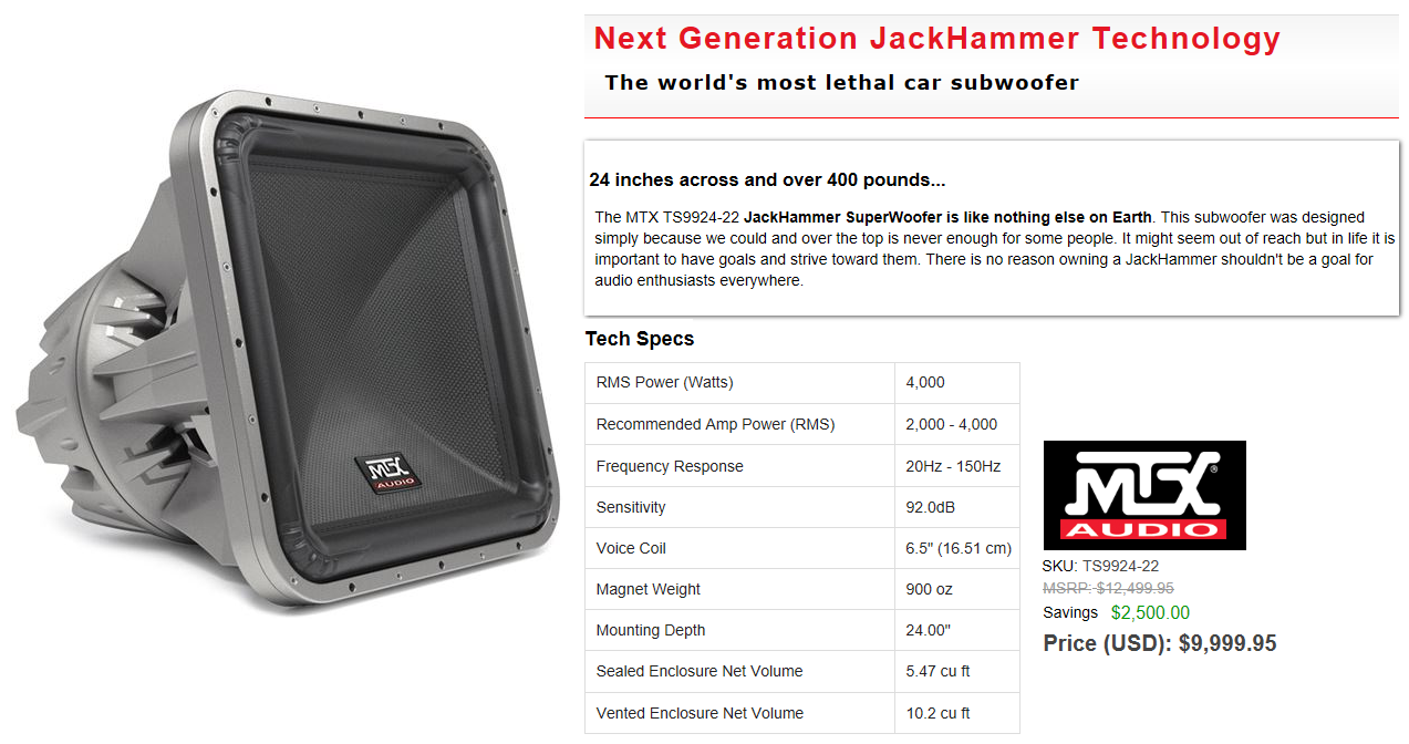

If you want to shake (break?) your bones and smash a concrete sidewalk then you need this subwoofer:
nah... that puny thing? why not THIS?

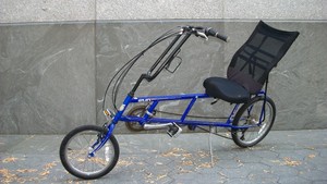

for what it's worth, the bike i'll be hauling everything with will be a sun EZ1 recumbent (all day long comfort) pretty much like this
an added bonus to using a 20 inch rear wheel recumbent is that the 20" trailer behind it will be almost level, and unlike if i used a 26" mountain bike, the trailer will tilt forward slightly instead of backwards a lot which just looks wrong. my EZ1 has seriously weathered paint, but it's a darker cobalt (vicks bottle) blue than this royal blue one, but by next year, i'd like to tear it down and undo the backwards right brake controls the front wheel cabling and get it painted metallic purple, or get another lighter version with an aluminum frame, handlebars and maybe seat-back too vs entry level chromoly.

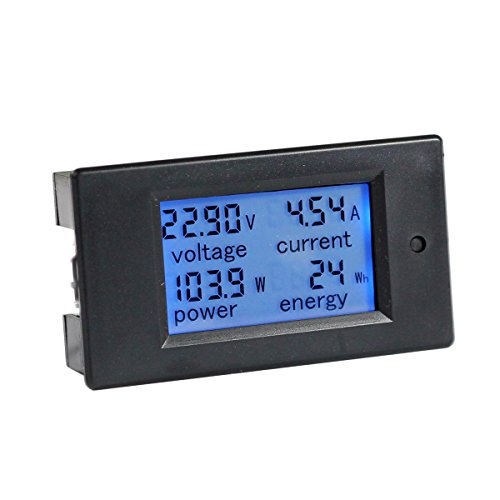

hmmm... i think i've found my power meter...
i like the looks of that and it looks like i can measure energy consumption too. it looks better than the cheaper voltage only "LED alarm clocks" to me and it's well reviewed. i'll just have to figure out how i'm going to mount it. i'd like it mounted on the handlebars, but that's not practical, or probably safe. i'm thinking centered under the trailer in front with the circuit breaker next to it. all these little detail$ add up fast.
