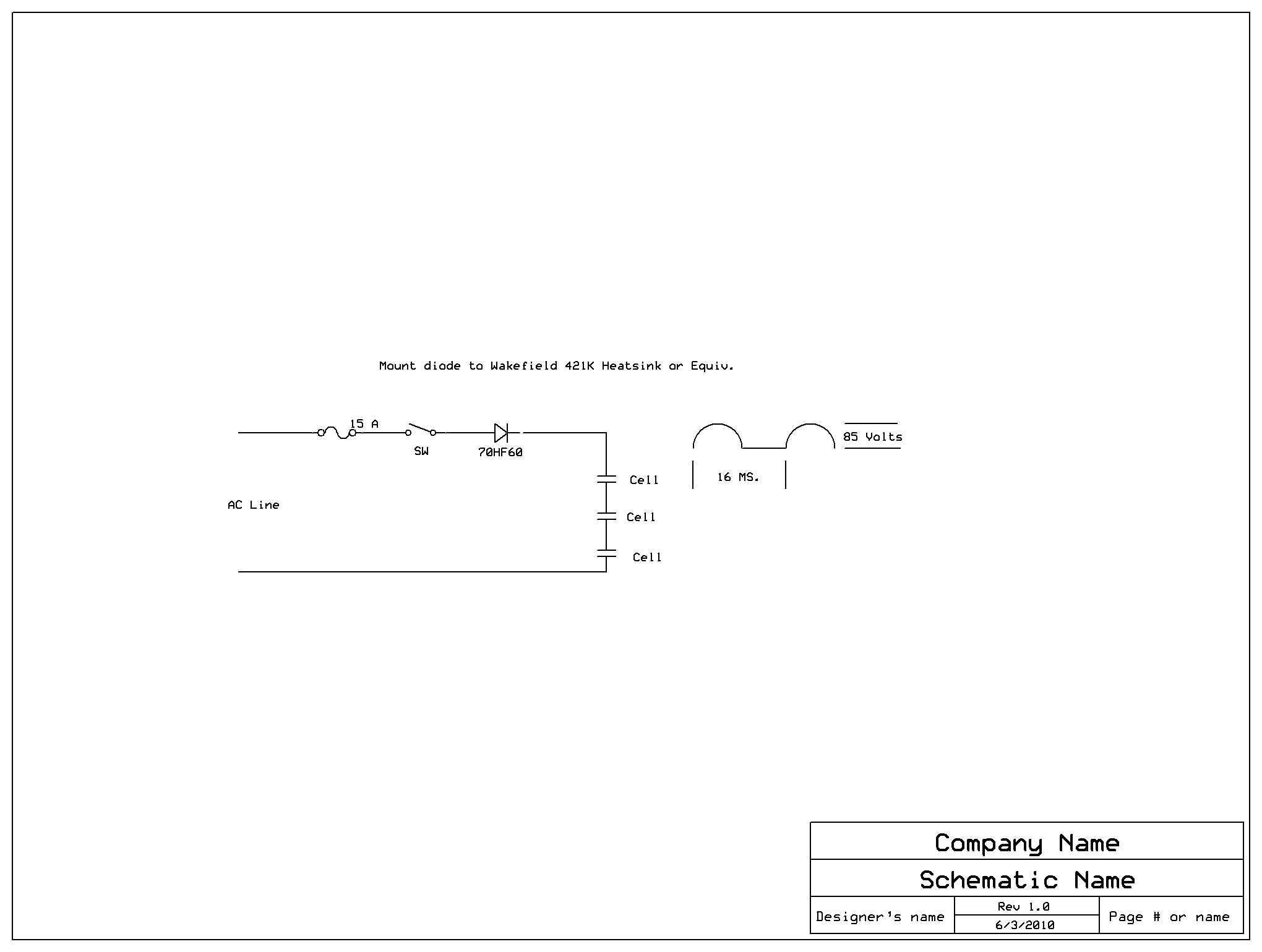

Hi Dan :) I kind of figured that i would not be able to get 20 amps from household current but 15 for sure :) Its Nice to meet you too :) Yea, the oil companies and the Gov dont want high milage vehicles on the road, because they want and need to sell fuel and get the taxes on the fuel sold, I am able to save half of my fuel bill with HHO @ cruise speeds, I am looking into higher voltage and less amperage to create more HHO, the amps put a load on the vehicles electrical system, and by lowering the amp load and increasing the voltage, i am hopeing to get even get better results, modern engines are not designed to run on pure HHO, so i will always use gas or diesel for lubercating reasons, i would like to use a 60% HHO to 40% gas or diesel in my vehicles, right now i am at 50/50 hho and gasoline, and am happy with that being a on board on demand, i would just like to see if i can do better :) Take care and have fun, Chellie
the problem is that you can not up the load voltage without upping the source current ... power is power regardless of the voltage. high power electric motors run at high voltage to reduce copper losses. The amount of load you put on your system will be the same no matter what the supply voltage.

Bubble bubble toil & trouble. Saw your question on Gary's post about the dimmer. Not sure if that is a good approach to your problem. If I am understanding correctly you are worried about the 170 volt level you get when the filter caps charge to the peak value of the ac in? Seems like if 120 is good 170 would be better. Do you need smooth DC??? Seems like I recall people running these things from PWM's. If you can stand the ripple just your big bridge would work. If not I would use 4 2700 ufd. 200 volt dc caps like the 272m2000a052 from Mouser Electronics. Let me know if the 170 volts is really to much. From the video you posted it didn't look like they used anything fancy. A real 20 amp regulator at your voltage is not real cheap. If you are worried about the 170 volts, how about a half wave rectifier at 85 volts? This might be the best with the 8 caps. Getting a little expensive. $80. Do these really work?
Thank you Ronv for the reply :) I am looking at a few different ways to power my Hyd generators, I may not even need a capacitor because the current is going through water, that may be good enough :) Yes the 170 volts may be to much voltage to use, as it only takes 1.2 to 1.5 volts per plate to release the hyd from the water, i am looking at hooking 3 hyd generators in series, with 21 plates each, and using a 12v to 120v converter to a bridge rectifier to power the hyd generator, I like the half wave rectifier idea too at 85 Volts :) These Hydrogen generators work very very well, i am using 30 and 55 amp PWM @ 12 volts, with a 100 Hz frequency , the 55 amp PWM has an adjustable frequency to it, these can also be used with 24 volts too, a hyd generator that i built, worked great, at Cruise speeds it would double my fuel milage, thats where they really shine, also the motor oil stays super clean, because almost 100% of the fuel is being burnt and used, you will always loose some fuel to heat :) I love the extra power that I am getting too, normally on most SUVs and pick up trucks, 15 amps is the most you want to use to generate hyd, because it does take power from the eng to make hyd, I dont think these hyd generators are over unity, they help to make extra power in a number of ways, the fuel is burnt 25% more effecient, the hyd burns turns to water then flashes to steam to drive the piston down longer under power, the fuel is burnt slower, its like getting 120 octane gas :) the added oxy helps everything to burn better, the eng sees the extra hyd fuel with or with out a comp. and will adjust for it, fuel savings of 20 to 60% is commom, with some vehicles getting 100% fuel savings or doubling your fuel milage @ cruise speeds 65 to 70 mph, I will also be making some portable units so they can be used in a boat too, I am just doing my R&D right now on some larger hyd Generators for big rigs, I may stick with 12 or 24 volts, but i just want to experiment a little :) the hyd or HHO gas is just a supplemental fuel, to aid in MPH, its not the entire fuel being used, a eng would need to be modified to run on pure HYD, like stainless steel valves, bronze valve bushings, ceramic coated piston tops, and ceramic coated combustion chambers, stainless steel exhaust system, high energy ignition system , ETC :) to name a few, also you will need to use syntetic oil to make it last, Thats why I kind of like a rotory eng :) Take care, Chellie
Half wave rectifier
Attached is the half wave rectifier. The parts are available from Mouser Electronics. I have to agree with some of the other posts that high voltage/current and hydrogen doesn't sound like a good combination. I read a little more but there are a lot of theories out there. If this isn't under control we can build you a big old PWM.

I was just looking thru you last post and noticed the 12 to 120v converter. I'm not sure how the the converter will like the half wave rectifier. Also you understand that it will take in excess of 200 Amps from the 12 volts to get the 120 volts @ 20 Amps out of the converter?
There is some serious price gouging on the parts being sold and a good deal of basic electrical and physics principals being over looked here.
First any inverter that runs off of 12 volt vehicle power converts that to high frequency AC then steps it up and then rectifies it to DC at around 165 -170 volts then re inverts it with a H bridge set up to make the AC again. The step after the high frequency AC rectification is pointless if all you need is DC. Just tap into the voltage feed back part of the inverters control circuits and set the HV DC to a lower level and skip the AC reconversion on the last step. Or just use the 170 volts directly.
Second the higher voltage will do nothing for improving the efficiency or volume of gas being generated. Basic physics dictates that. Only the line losses in the wire will be improved which if the correct size wire was being used would not be a problem in the first place. Also any line losses that are reduced are far less loss thatn that of the inverter at 80% - 90% efficiency.
Third The super novacell is just a stack of stainless steel plates in a Plexiglas or lexan case. Anyone who knows there basics of metals could buy a stainless steel sheet from a local fabrication and welding shop and have it cut to size for far less and build their own for under $200 or less.
Fourth given that the system needs 12 volts at over 200+ amps to run the inverter how far do you think this is going to run at that output before your battery goes dead being the reserve output of most stock alternators in a vehicle is under 30 amps at most after all vehicle loads them selves are taken into account.
Fifth what is the point of spending several thousands of dollars on this crap to hopefully double your fuel mileage if the avoided cost savings would take the life of the car and the components used twice over to break even on when factored into realistic driving conditions. $5000 will buy 1667 gallons of gasoline. 1667 gallons of gas would power a 30 MPG car around 50000 miles. Given that your savings is half at ideal driving conditions that account for about 20% of all driving conditions that would take around 250,000+ miles of ideal driving conditions just to break even providing that the HHO system never need maintenance service or repairs in that time.
Sixth I have no idea what car only needs 5 - 10 Hp maintain highway speed. Try 40 - 80 hp or more. Also 2500 watts equals 3.35 Hp. factor in the average efficiency of a high output alternator plus the inverter that could supply that from a 12 volt source and you need around 6+ additional Hp just to power the HHO system.
I am not saying that this couldn't work but I dont see how it would pay for itself unless it could run day in and day out with near zero maintenance on a vehicle that would have to realistically drive half a million to a million miles before it paid for itself just on theoretical avoided costs savings.
It is your time and money and you can do what you want with it but I would strongly suggest using a fair part of it up front to buy some real bonified and accredited physics, electronics, chemistry, and applied mathematics books and then spend a year of so experimenting and learning about how things really work in real life aplications.
