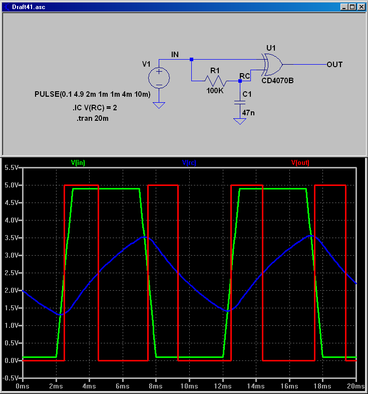

I'm working on a counter circuit and I would like to make 1 input pulse become 2 output pulses.

A CMOS exor gate where one of the inputs gets your existing clock signal and where the other input gets the same clock delayed by passing it through a series R and shunt C delay...

Using the circuit linked in the first post, I'd like to have the trigger input pulse advance the counter x2, instead of x1.
So instead of counting by 1's, it counts by 2's. (2,4,6,8, etc)
Simple RC delay + schmitt trigger + OR gate w/original pulse.
As MikeML stated it needs to be an Exclusive OR gate, not a standard OR gate.
This has been posted before.
