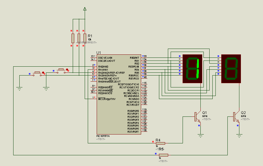

AnneMaj,
Since the program clearly works, you need to post the exact circuit and code that you are using. Are you still trying the Isis simulator or have you moved on to actual hardware?
John
Burt!!! Very worrying.... I hope you have something on under the desk!!!!;););)
I think that piece of fabric is a blanket. He is in bed with the circuit :).. filming a home video.

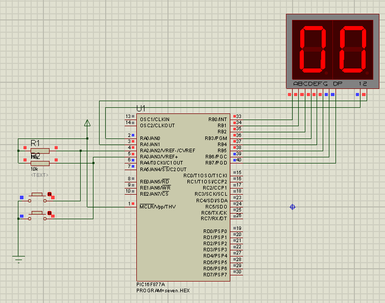

I simulated in proteus with the program and it was working with no problem except the display is alternating between the tenth and unit digits at the speed of about 1 Hz.
You have to show us a picture of your simulation or your hardware in order for us to help finding the problem..
Allen

is mplab ide not working on windows 8 os? cause i just build the asm file on my classmate's PCs. thanks for the help guys.. especially 'be80be'.. tnx. i'll try to build this tomorrow.. tnx again.. :)
If the OP would read the code the delay can be changed for what ever crystal your using I set it for a 16 mhz I couldn't find a 8. So you have to change that to match the crystal

can you show me your circuit?

it's working.. thank you very much.. :)

See it works
[video=youtube_share;30jcRxCZAY8]http://youtu.be/30jcRxCZAY8[/video]
Stop repeating that.. please :) It haunts me at nights.
If you construct the circuit on the breadboard with real hardware then it wouldn't blink. This is due to the simulator is not simualting fast enough so the whole thing looks like slow motion on the proteus.
Allen
